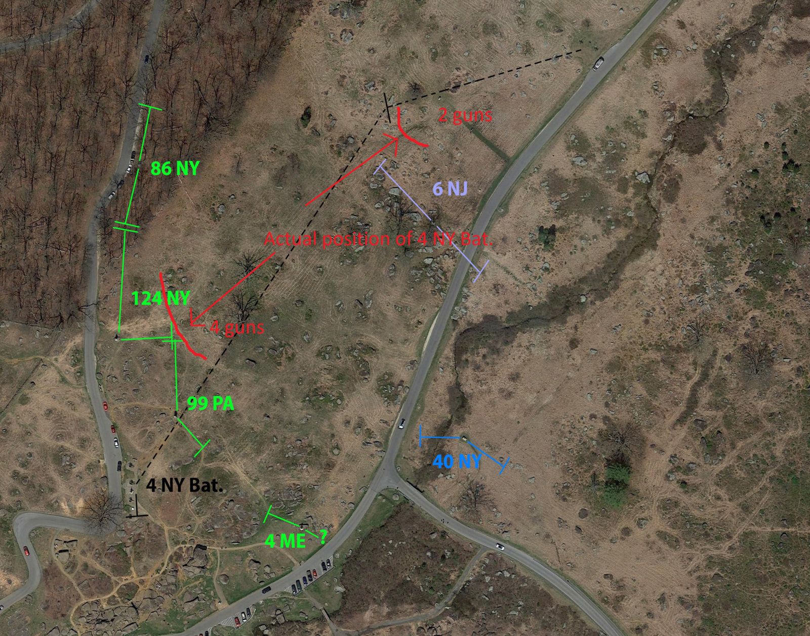

Here is the location of Union monuments at Devil's Den with lines drawn to indicate their flank markers. The regiments belonging to Ward's brigade are indicated in green. In black notation are the location of the monuments to Smith's 4th NY Battery, also showing flank markers. Smith had 4 guns right above the "den," but located 2 more in the rear because they could not be accommodated with the others.
Notice the significant difference between the location of the guns on today's battlefield versus what many now believe were the actual position of the guns (in red). Any thoughts on this? Evidently, it has been controversial for some time. The story of Devil's Den has particularly fascinated me. The most detailed information that I have found comes from Garry Adelman and Timothy Smith's excellent book.
In the official report of the 6th NJ, Lt. Col Gilkyson refers to the section of Smith's battery that was left near Plum Run to be on his left. It has long been my view when walking the terrain in that area that this section was probably east of where the roadway is today, rather than the location of the two guns on the field. If one looks carefully (and I will admit that the topography may have been disturbed by the construction of the road) there is almost a perfect platform where a two gun section would command the Valley of Death. Accordingly, I have some doubts as to the position shown by the red line on your map for the rear section. I would place it further to the east.

Do you believe that the rear section was west or east of Plum Run? I will have to check that out in a future visit. I would think it would be problematic to be in the lowest ground so close to the stream among the rocks. It's also possible the the 6th NJ was more west than where its monument and flank markers are located. As you said, the regiment's location would have been dynamic. That may account for them stating that the guns were to their left. The other possibility is that their report is in error.
I think the "rear section" of Smith's battery was east of Plum Run, but west of where the modern road is today. If you look east and a bit south of where their marker is on the field you will see the slight plateau. it just looks to be like a good gun platform, but even two guns would be a tight fit. It would have kept them out of the mud, and given a great shot down the valley.
Also, as I am willing to admit, the topography may well have changed, in which case my theory goes up in cannon smoke.

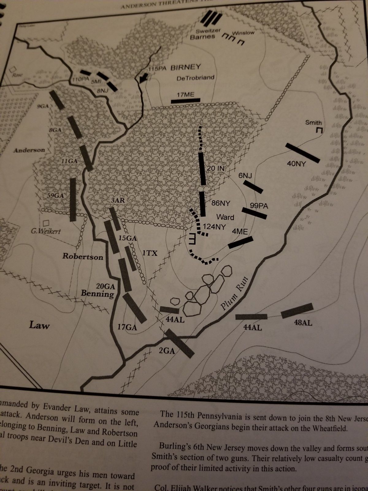

Here's my draft map:
I'm having a problem with the description. It's not possible to be located "east of Plum Run, but west of where the modern road is today." From the rest of your description, may I assume that your directions are reversed and you meant, "west of Plum Run, but east of where the modern road is today?" If so, this makes sense.
I think that everyone agrees that the guns were west of Plum Run.
My draft map does not show the "point of woods," but perhaps extending an imaginary line eastward from the stone wall behind which the 17th Maine was posted would establish that "point of woods." Phil's map has Smith's section somewhat further north than mine, making it difficult to see how the 40th New York could pass through that section on its way south. Rather, in coming under fire upon reaching open ground, the safest course would be for the 40th to initially move at the right oblique, which I took into consideration in positioning Smith's section on my map, and in this instance I believe it closely accords with the actual placement of those guns on the field.
Laino's map just previous to the one that I posted has the 40th New York following the 6th New Jersey through the "point of woods" and deploying to the front of Smith's section rather than passing through it.

I fully agree that Smith's detached section was west of Plum Run, but I think it was east of where the road is today. I agree Tom that it was likely located just a bit south of where Laino has it.
So here a true story. When I played high school football, my coach wrote "L" and "R" one the left and right pant legs of my practice pants because I kept getting my right and left criss-crossed and going the wrong way on certain plays. It seems I have the same problem with east and west. The directions I put in my last post were exactly opposite of what I intended. I'm glad to have you guys making this badly needed correction.
