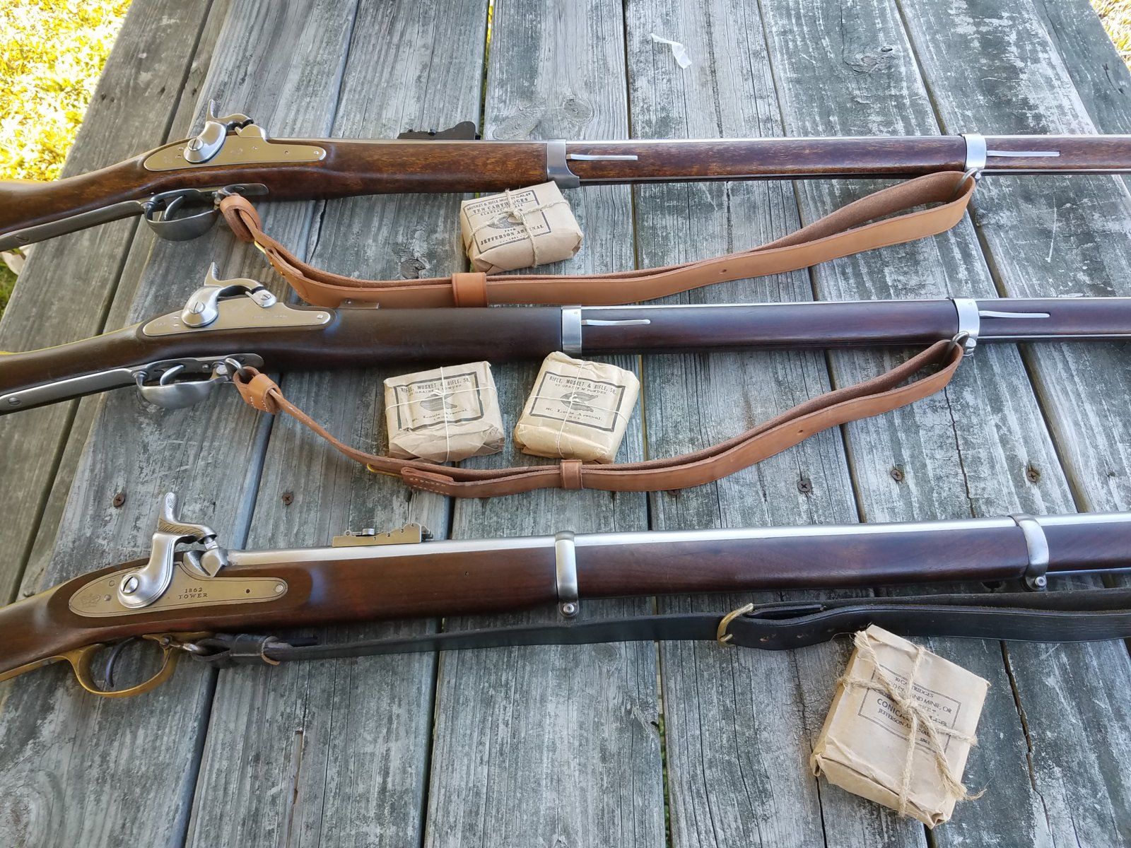

Hey all! I took my three repro rifles out to the range yesterday and had a blast! Shot about 20 rounds or more out of each one...a M1842 rifled musket, M1861 Springfield and a P53 Enfield. I do have a question in regards to the M1842 rifle. This was my first trip with her to the range...the group from the mini was all over the place, even at 50 yards. Whereas the group with a 65 roundball loaded traditionally (over 110gr of 2f) had about a 3"-4"group. Needless to say, I found the accuracy of the round ball much better! Has anyone had similar issues? I may have been anticipating the recoil from the minis a tad but not that bad to my mind!
Also, the engagement of the sear on the M1861 is really stiff...anyone know of a solution? Thanks!

Did you purchase your ammo, or cast them yourself? (I see 2-3 good looking AP's! :thumbsup:)

Hey all! Thanks for your replys! I should have clarified better lol...the 110 gr charge was for the round ball, I used 70 gr ffg behind the burton minis. I gor them from S&S and they were labeled as being from the 720 gr Lyman mould. I will certainly take a better look and see if there is any unnecessary windage next time I take her out! The minis were not keyholing so that is a plus....I was shooting standing, I think next time I will put her on the bench and see how she does!
As far as the M1861, I will definitely take your advice and see what she looks like under the hood! Thanks again everyone!
