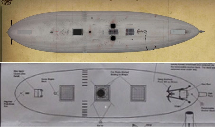

I have been doing research into building the CSS Manassas per the CWT blogs on her. I have concluded that "Flagships" model will work as a basis for the build. The comparison images show differences in the designs but as you can see, will work fine for a bash kit to get the blog outcome from @OwenEgan design. The model will be about 9 1/2" length at 1/192 scale approximately.
Will have some more info on this build soon. Model and parts have to be ordered along with some discussion with @shipmodeler . (Flagship models) I have researched this extensively for the build and considering cost factors along with a scratch build possibility, this is the way I will produce Owens design representation as close as possible. As the H.L. Hunley model of mine this one will have to be shaped accordingly using green putty. Depending on N scale for railroad tracks, I might be able to use actual tracks for the armor plating. We'll see.
Drawings provided from Flagship and @OwenEgan . Images scaled to each other for build note comparison done by myself.

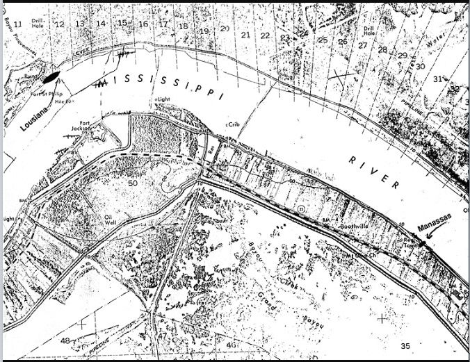

We had discussed that possibility here at CWT on one of the blogs about what it would cost to raise her or another Ironclad down in Louisiana. Which would cost millions to do a proper job for preserving any artifacts which were found.
Location possibilities of the wrecks locations:
http://www.numa.net/expeditions/november-1981/
I don't think Louisiana could ever be recovered but a would love a full survey with all modern methods. It would maybe answer some of the multitude of questions still unanswered.
Glad to see you depicting the funnels as vertical and not slanted. The cross-bracing served more than one function. In January of 1862 Manassas was sent down river to recon Head of Passes and burn the lighthouse. There were a number of low trees along the banks just above the Head and while the vessel was moored there, a ladder was placed up on the bracing so that a look out could be placed above the trees.
May we see progress posts, as your model is being built?
Yes, of course. When I have all the associated parts and model basics in hand I'll start the build posts. I started this one early for the comparison images plans, so if some of the other experts here felt Manassas model needed anymore fine tuning we could hammer it out. I feel so far that everyone is in agreement of Owens rendition as a excellent representation of what the Manassas looked like.

Just a thought. One of the reports on the sinking of Manassas below the forts stated that she went down after the carronade charges stored under Warley's bunk went off. Porter mentioned hearing the small explosion. Eyewitnesses of the time stated that she went down off The Jump, a shallow channel running from the bay to the west of the river into the river. The report that she ended up on the bar (SW Pass) is incorrect. Sketches made of the wreck on the bar strongly suggest it was the floating battery from New Orleans. The shape of the portion above the water is very similar to the ironed housing to protect the battery's steam pumps on the floating battery New Orleans when she was scuttled upriver at Island No. 10.
