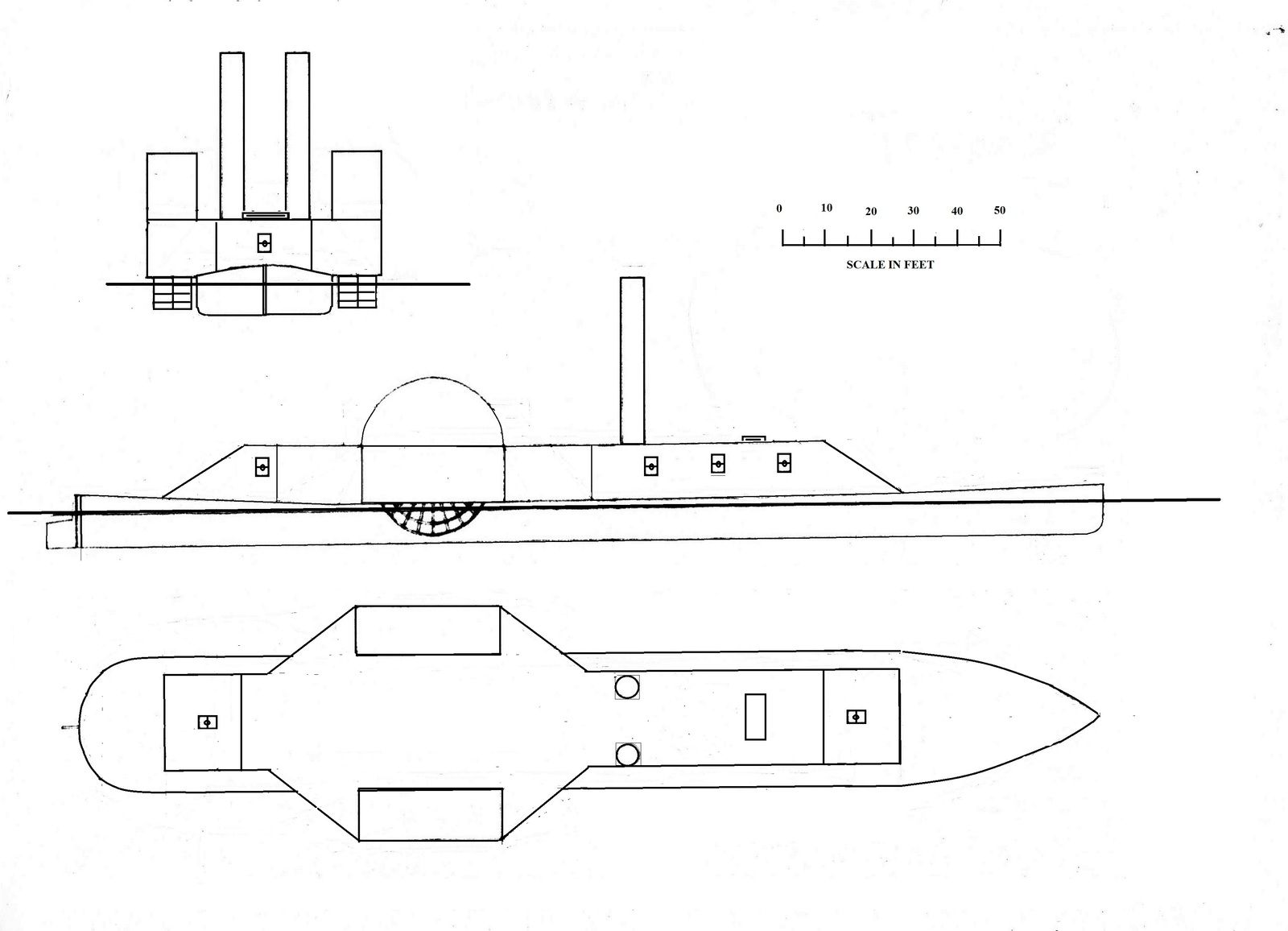

Following the revelation by Bil R in a previous thread that the plan of this vessel often labelled USS /CSS Eastport, is in fact the rebuild by Phelps and not the original conversion by Isaac Newton Brown, I have produced a preliminary plan of his conversion:

Let's see... off the top of my head, the differences I can spot are the treatment of the sidewheels and guards, the vertical sides, and the single gunports fore and aft.
Rebel, do you or Bill know whether the original Brown version was to have ironing over a wood bulkhead or a composite iron, wood, compressed cotton, wood system like Arkansas or the River Defense rams?
George, until Bil mentioned it I didn't know that the version we are all familiar wasn't Browns. I suspect the protection was a copy of the Arkansas system, but maybe Bil can confirm.
Brown left 4ft each side of the original hull width. The casemate would have been 24ft wide outsdide, approximately 21ft across inside, and I reckon the four guns would have been pivoted.
How much work had the Confederates done on her before she was captured? As I understand it, a lot of the iron and other material had been assembled on shore and was taken along with the ship. Do we know how her ultimate configuration compared with the Confederate design?

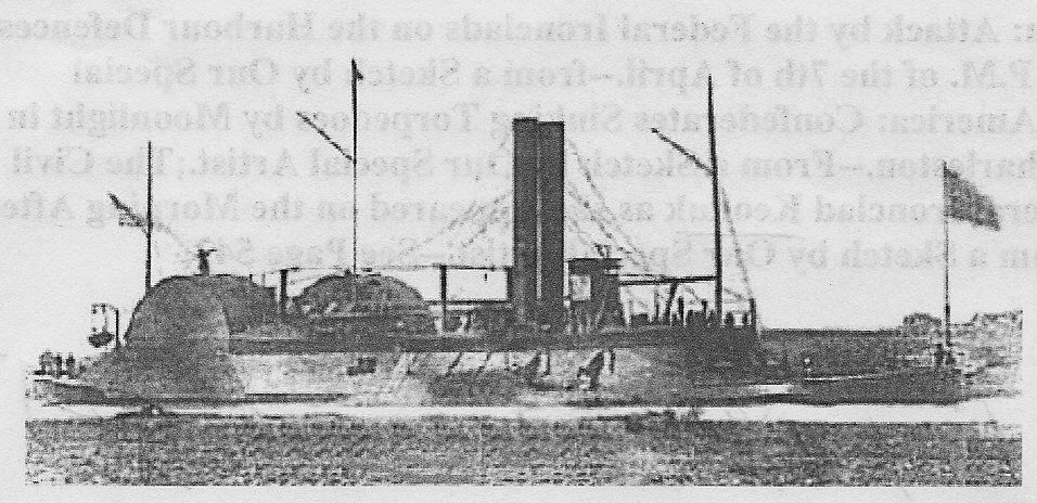

Eastport as converted by the Union bore a number of similarities to the Benton and Lafayette conversions, at least from a visual standpoint.

This is probably not a coincidence. Phelps had commanded Benton as flag captain under Andrew Hull Foote and would have been familiar with her; and Lafayette was similarly converted from a large civilian sidewheeler at roughly the same time and in the same place (Mound City) as the Union version of Eastport.
Not much ,I think. Phelps built her to a completely new design of his own, and she was probably very much overweight when completed. His casemate as shown in the photos was a new addition "plonked" on top of the hull and much wider.
CSS Eastport would have been 223ft x 32ft x 6ft 6", 663 tons with 4 guns. Her protection we discussed earlier.
USS Eastport was 238ft x 51ft x 6ft 6" ( probably much more by the photos), 1,214 tons, with 10guns, protection was 2" iron on the casemate.
Hmm... Just one objection: I think you're including the wheel guards rather than just the beam on the USS Eastport stats, and omitting them from the CSS Eastport stats. The beam of the hull would have been pretty much determined by the vessel being converted; adding length to a riverboat was relatively easy-- chop it in half and splice in the extra length-- but adding width was more complex, adding sponsons, shifting the wheels and machinery, etc. I don't think Phelps & co. went to that length.
Mark ,yes I did, sorry I normally specify beam (B), extreme width (EX), in this case the new casemate was 51ft wide, she was wider still over the wheelhouses which had outward sloping protection. He didn't move the machinery at all.
This was all balanced on the original 228ft (OA) x 32ft (B) hull. The plan is by Robert Holcombe.
One interesting difference between Lafayette and Eastport is that, given Holcombe's plans, Eastport's casemate extended to the guards, whereas Lafayette's was limited to the hull, without guards.
While I won't go against Holcombe lightly, I wonder about the breadth of the casemate, though. To my eye, it looks a bit too beamy in relation to surviving photos.
I can't find a good/clear example online at the moment, but this is the image I have in mind:
BTW, Donald L. Canney's The Old Steam Navy Vol. 2: The Ironclads, 1842-1885 gives Eastport's beam without guards as 43' (p. 104) but the statement is not endnoted (though Way's Packet Directory appears to agree; this may have been the source). It does sort well with the similarly-sized Lafayette's hull-beam of 44'.
ETA: I'm fiddling with some drawings... I'm having difficulty buying the dimensions of 228' x 32', as opposed to 280' x 43'. That could make a significant difference as to whether the casemate actually extended out to the guards, or only as far as the width of the hull.

First, John it's a beautiful job. You've captured the grace of a Dowerman built hull (stright stem, gentle sheer) very well. To provide more room for the third gun I would consider moving the casemate forward a bit. I apologize for not providing further details earlier. Right now I am in the midst of travels and don't have access to my notes. I've got to be back at work by Monday.
Anyway, agreed the hull dimensions as built seem to differ. The only antebellum consistencies are the Bureau of Navigation's Ship Register & Enrollments which give 228' x 32' x 6'6" (as built and after 1860 refit). Certainly, I respect Way, Holcombe and others but I have to go with the official measurements of the era. I honestly think the oft-quoted post-conversion length of 280' is a misprint from someone who mistook 260' for 280'. The reason? A hull of 280' was significantly longer than the 'as built' at 228'. Added at the bow this would have placed the wheels disproportionally aft. While not unheard of it seems unlikely. Especially if you carefully examine the photograph above. Look at the man with the eyeglass on the wheelhouse. I gave him a height of 6' and then measured the hull length. Although not exact it comes much closer to 260' than 280'.
Now this brings us to the beam. When the Eastport was finally recommissioned months later an extensive writeup appeared in the Cincinnati and Chicago papers. It was that correspondent who described her originally as being fitted with double bulwarks about 4' inboard along a plan much like the General Price and other Confederate gunboats. Then he states 'this plan was abandoned and a wholly new plan was put in place by Phelps. This would suggest that her protective scheme would have been similar to the RDF gunboats of double bulwarks, compressed cotton between and iron sheathing on the exterior.

Than you for that Bil, I think that answers Marks question re the converted length and beam.
I spotted the disparity in lengths from the quoted 223ft PP, and estimated her hull length overall would be 228ft, my plan as I put it on hare is actually too long, and I have shortened it at the bow.
From the sounds of it Phelps might just as well have built a new ship !
I suspect she may have been rather "tender" as completed, carrying such a large casemate on a narrow hull. You would have to be very careful with large helm movements. it's interesting that in that photo the casemate edge is actually touching water, suggesting that either the hull was sagging or that her draught has increased, probably both.
