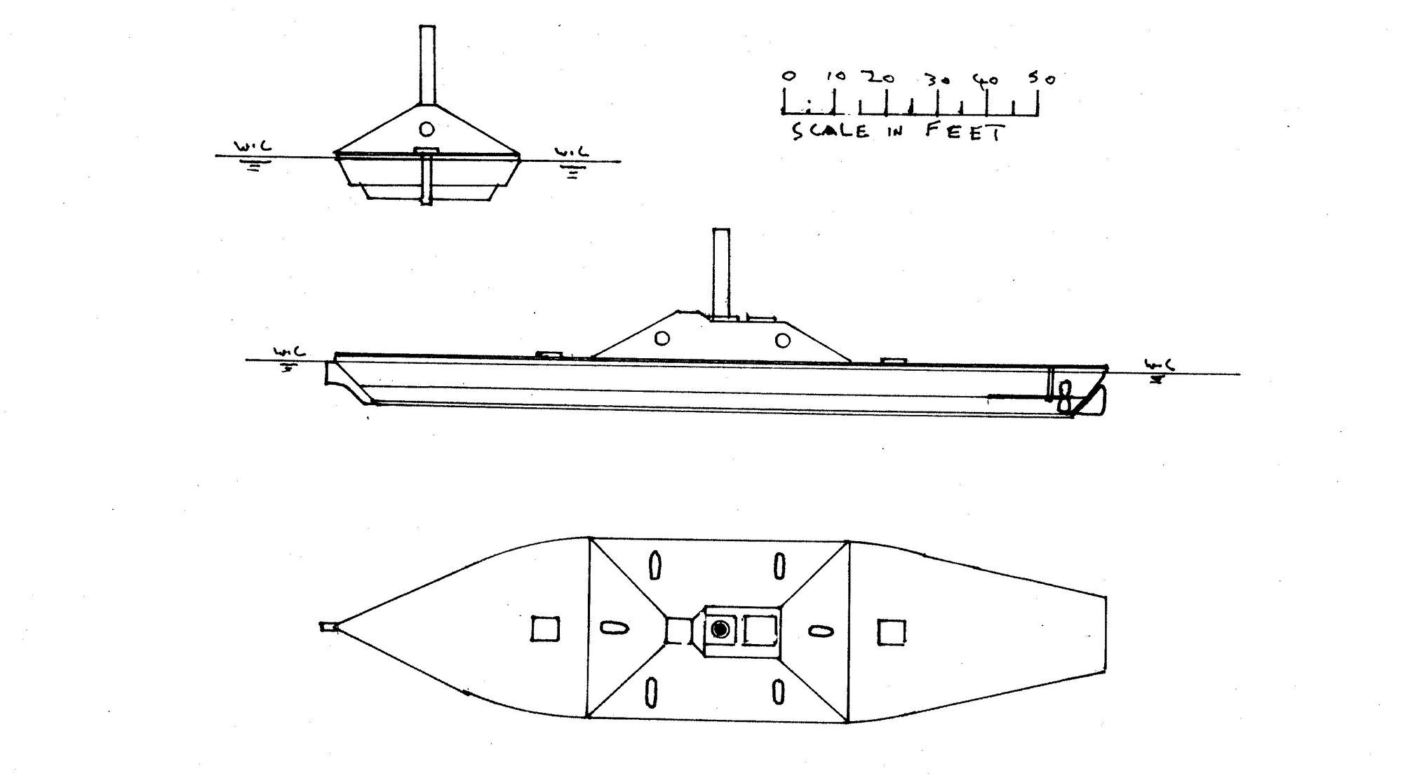

There was indeed a vessel which has come to be identified as an improved Albemarle - except that it wasn't an Albemarle !
Class: "improved" Albemarle
Type: Ironclad sloop. Screw(s): two, Speed: 8.5 knots
Dimensions: 153ft OA x 36ft EX x 9ft D, 708 tons
Guns: 4 on Pivot mounts, meaning either port or starboard guns were able to fire through the fore and aft ports
Armour: 4" iron,
Design: J. L. Porter (?) Builder: Unknown at Tarboro, Construction site moved to the Roanoke River For completion either at Edwards Ferry or Rainbow Bluff.
Laid Down: Mid 1864 Not completed:
History:
The plan from which this drawing is taken was done by a US Army officer who saw the ship in the Roanoke River. (not to be confused with the earlier proposed Albemarle type at Tillery's Farm),
Ordered by Secretary Mallory as an "improved Albemarle", which has caused confusion to researchers ever since, as this vessel was not in fact an "Albemarle". To be ready for service in 1865. the weather deck and casemate extended two feet each side of the hull proper.
Casemate slope was increased to 30 degrees whilst the hull armour and backing was added in a belt outside the hull and under the overhang.
The hull was also different at the stern from the "Albemarle" plan in that it featured a spoon shape stern. It is not thought that this vessel carried the "new" quarterdeck form as seen in CSS Jackson and CSS Wilmington. She was burned to avoid capture in early 1865.
Original plan by the author from a contemporary drawing.
