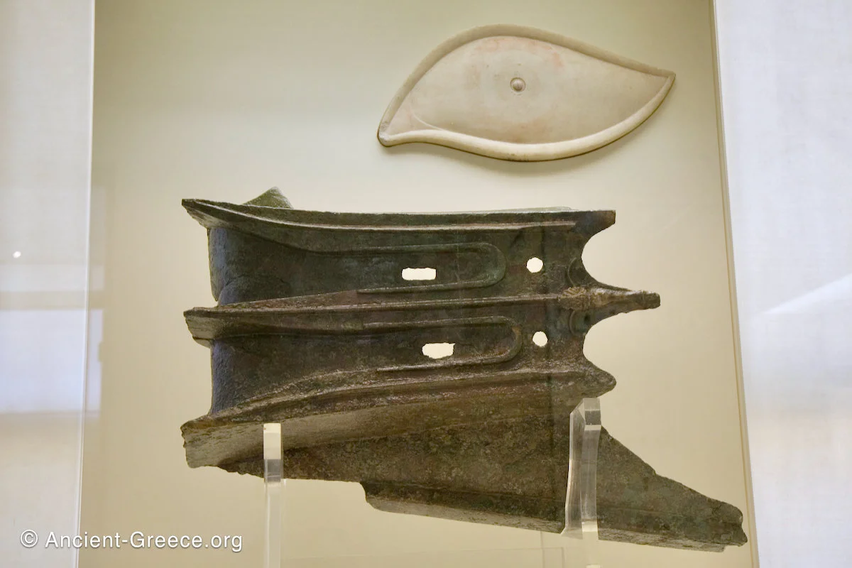

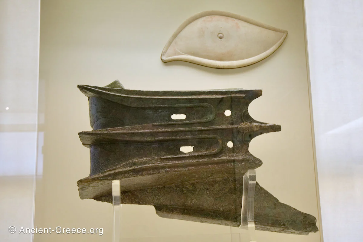

"...whose time had come" It's time had been and gone. Ramming was the primary method of attack for ships in the Eastern Mediterranean from 400BC to 400AD. The fact that all warships had oars, as well as inefficient sails, meant you could not get near them and archers - the only 'broadside weapon' available - could only hit those on deck so the preferred method of attack was to get upwind of them and used the ships weight and momentum to smash through the oars and into the hull and enabled boarding. It worked quite well then. It died out because ships relied more on sail and needed no oars - and were taken by boarding - an almighty fight on deck. Then cannon appeared. The technology and tactics were forgotten.
Given that information, you can see why ramming had a 'second coming' when ironclads were introduced. Cannon fire had a minimal effect on the visible superstructure and if there is no visible hull or crew to hit with cannon, what else can you do? Greek fire would have worked - if only we knew how it was made. Then they added the 'spar torpedo' - a long pole with a barbed explosive and a fuze on the nose attached to the bow (not a self-propelled one like today). It stuck to the hull and was detonated remotely. Ramming went with a bit more of a bang!
BTW - The 'ram' - the keel projecting in front of the bow - persisted only because it eased the flow of water around the ship making it more efficient. It was discovered by accident in the design of a fast torpedo ram for the Royal Navy, an early form of torpedo boat* launching Whitworth self-propelled torpedoes, in the 1870s. It was the 'door' for the bow torpedo tube It was used for breaking through booms and barrages to attack anchored fleets at night. The advent of quick-firing and easily traversed guns made it and that concept obsolete. Only one was built - the victim of evolving technology.

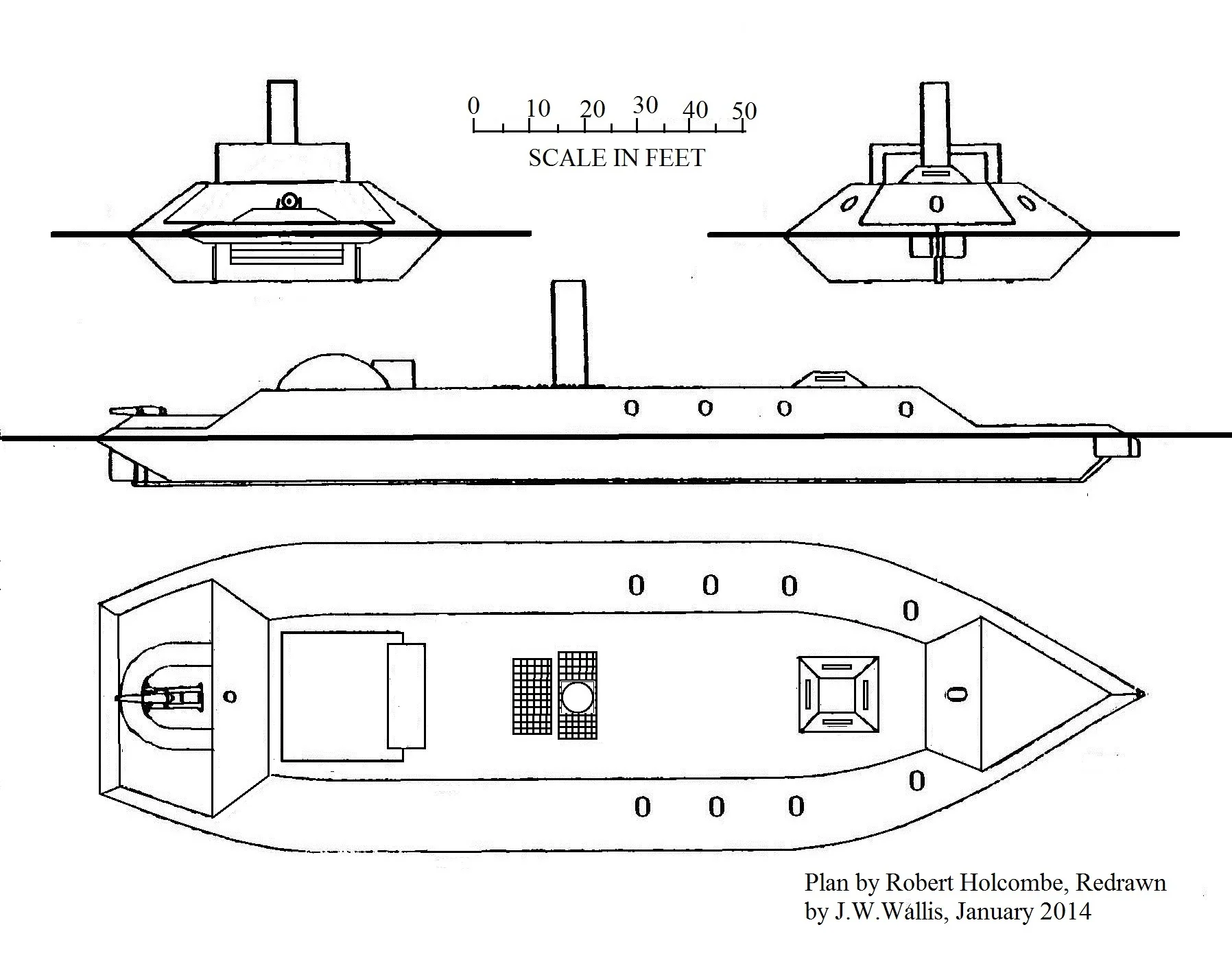

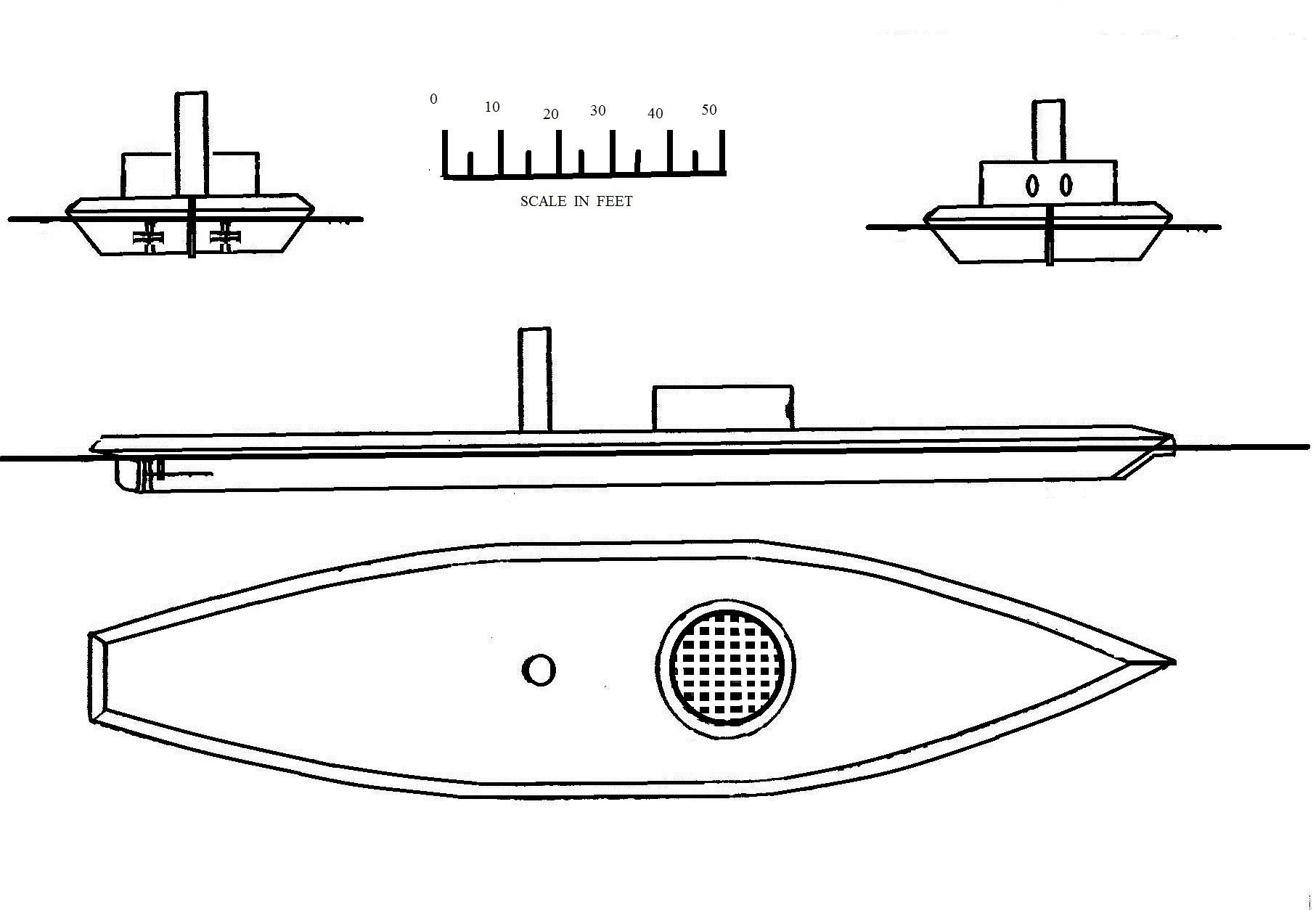

The plan of the ship by Robert Holcombe, which I have an original copy of from Bob, showed a conventional rounded stern. Then some years later, after Bob had retired from the Curator's post, the Museum decided that it had the same porpoise stern as the "Wilmington". I pointed out that the vessel remains did NOT fit that configuration ("Wilmington" was a conversion from a Porter 189ft pp plan with the "porpoise bit added). Eventually they reluctantly agreed.
Received wisdom is that Jackson was a rebuild of a centre wheel ironclad which Lt Augustus McLoughlin (spelling?) insisted be called Muscogee after the local Native Americans. When John L porter arrived as the vessel was under "reconstruction" he peremptorily told the Lt "Your ship is called Jackson" - and that was that.
Porter is credited with the design of the centre wheeler , but there are so many differences between a Porter ironclad and the Jackson that I think it was Chief Engineer James H Warner's project as completed. the hull bears a distinct resemblance to his plan for a monitor type turretship..
The photograph of her afloat after launching was taken in December 1864.
