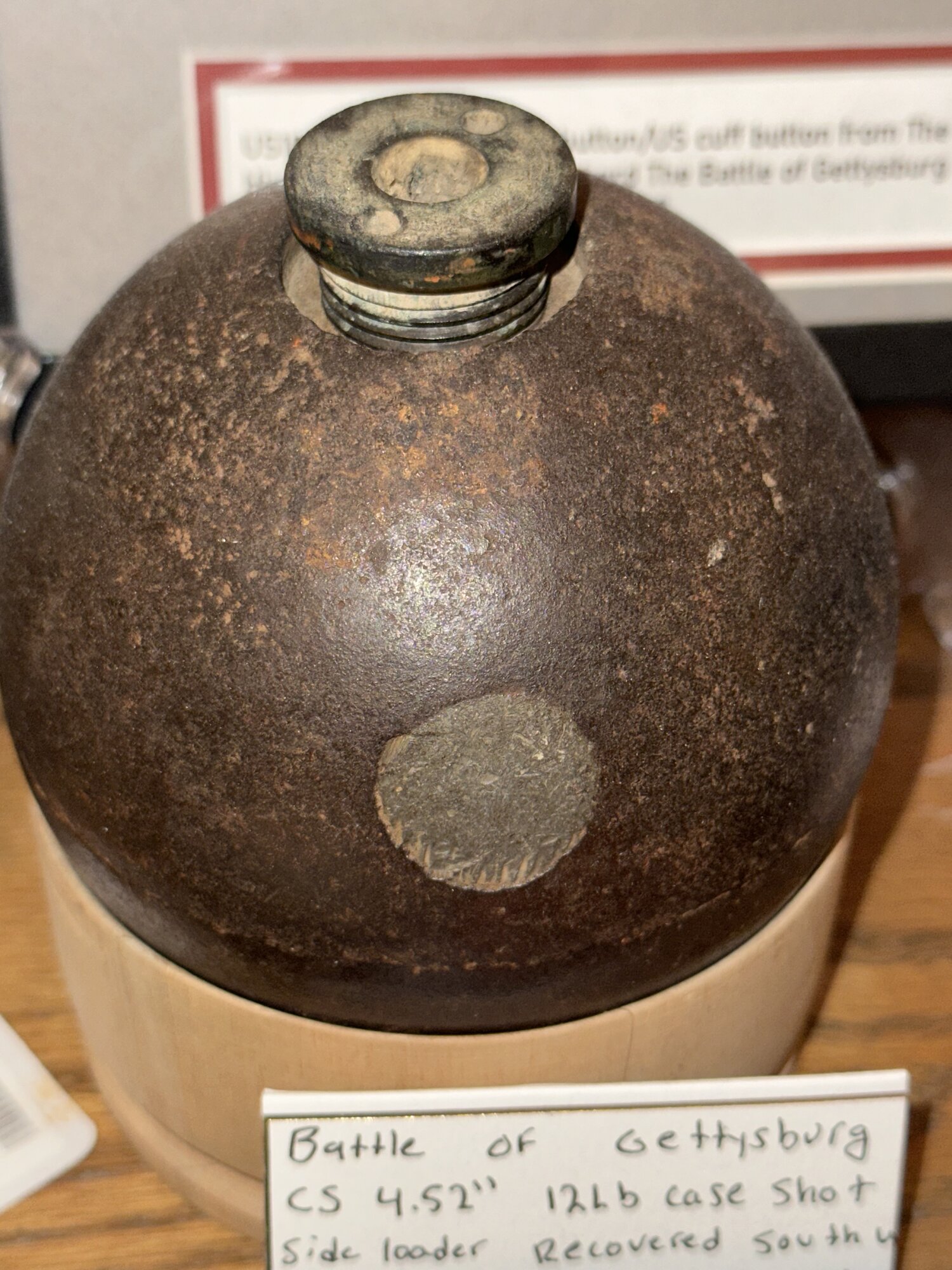

CS 12 pound side loader
2ndDEboy
Jun 23, 2023
Found SW of the PA monument Gettysburg for formerly part of the Geiselman collection
Can you elaborate on the 'side loader' part?

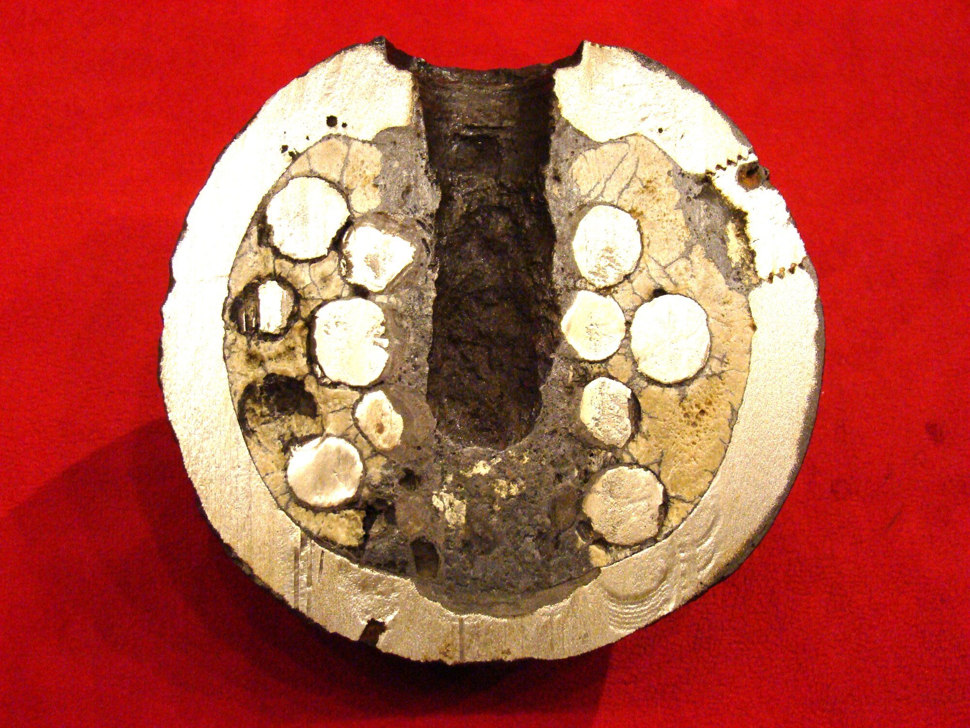

Instead of loading the case shot balls through the fuse hole and then putting a tar or sulfur matrix in to hold the balls, they would insert a rod in the fuse hole and put the case shot balls in through a hole in the side of the ball and then the matrix to hold the balls would then be poured in. The side hole would then be sealed with a lead or brass plug. This was a Confederate method and not used by the Union. This photo from the Army of Tennessee's website will illustrate how it was done in more detail.

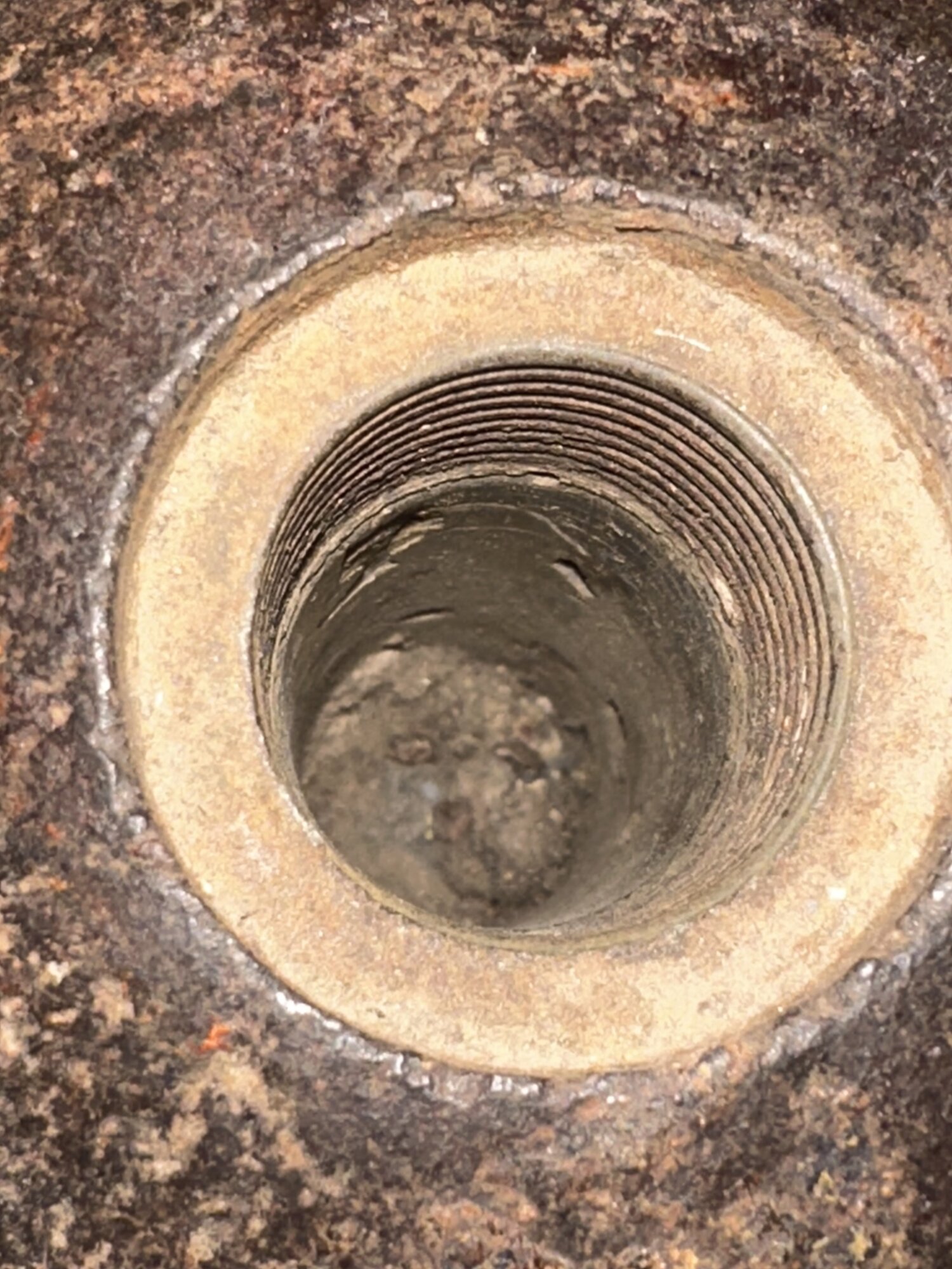

A paper fuze would be inserted into the same fuze hole which formally contained the Boreman fuze. It operated the same except you cut the paper fuze to correlate the distance.
Why would they replace the Boreman fuse? How reliable was the paper fuse vs the Borman?
A case shot's carcass (the container) was considerably thinner than an explosive shell's which would allow for a greater distribution of both the balls and the carcass. A greater distribution = greater effectiveness. The case shot also contained less powder that it's corresponding explosive shell.
If I'm not mistaken, the Confederate government ordered arsenals to cease production of Bormann-fuzed projectiles in late 1862.
Yes - you are correct! The Confederate made Bormann fuses had a propensity for premature detonation and the use of the Bormann-fused projectiles became more of a hazard to the Confederate infantry (exploding over their heads) than to the enemy targets. Urgent requests were made of the Ordnance Department to substitute common paper fuses for the Bormann fuse. Casualties among Confederate infantry occurring from their own guns at the Battle of Fredericksburg prompted the Ordnance department to authorize the substitution. However, the ammunition already on hand had to be used up and the Bormann-fused shells were still being used in some batteries as late as Gettysburg.
