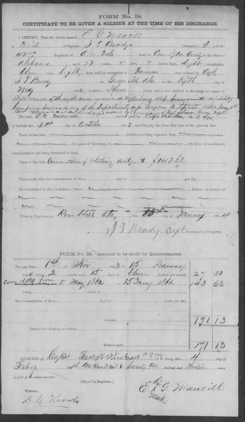

He was wounded in the right arm, luckily I have a copy of his discharge papers which indicate this.
Unfortunately the crease on the paper runs right through some important wording that I cant discern. Translating this document in full is another one of my "projects".

Which part is giving you problems? I can probably help.
In the portion where space is given for "entitled to discharge by reason of..." my current translation is as follows:
"Shell wound of the right arm at ?battle? of Vicksburg, ? ? ? preventing him from serving in any of the departments as per Surgeons ? ? January 8th 1864 approval ? his discharge made by ?Commission? of Dept. ?, ? Dept."
shell would of the right arm received at Vicksburg Miss permanent disabling him from service in any of the Departments; as pr Surgeons Certificate dated Jany 8th 1864. Approved and his discharge ordered by command of Genl. Johnson, Comg. Dept.
