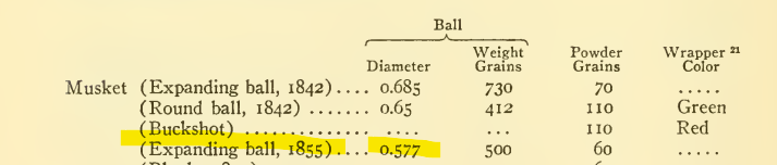

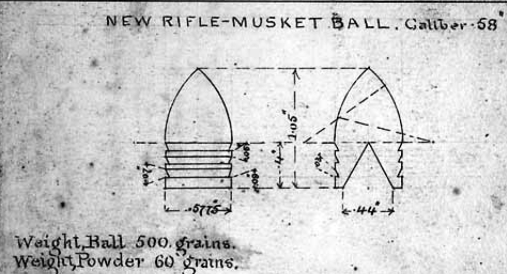

.58 was standard for US muskets of the time, and for .58 minie balls, or "expanding ball" historically the ball's diameter was .577:
Dixie Gun Works and others sell minie type balls of say .575 or so. I see Track of the Wolf makes their minie's for .58 bore in the .575 diameter too:

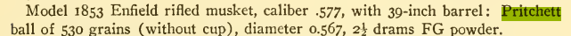

Just for historical reference, original Enfields were made in .577 caliber, and their expanding base ball ("pritchett" type) had a diameter of .567.

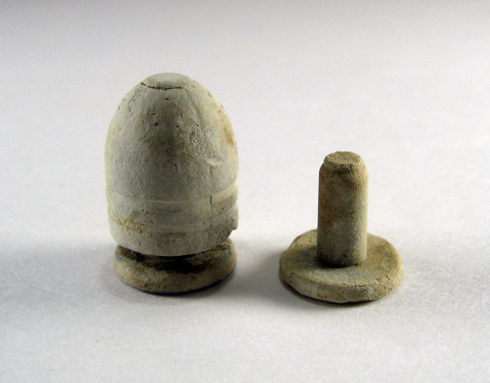

The point of the minie, or "expanding" ball, is that they are sub-caliber to allow for quick loading, but the force of the explosive gasses forced into the base of the ball forces the "skirts" outward, tight against the bore, and catching the rifling of the bore, etc.
This was advantageous as previously, the round ball had to fit pretty snug, and was patched, so required two-hands to ram (as given in the pre-war military manuals like Scott's abstract). The "expanding" or minie balls, being of a reduced diameter could be loaded quickly (like a musket), and without any patch necessarily, and in spite of fouling from previous shots as the skirts of the ball only expanded to the bore diameter on firing. Firing with patched round balls required the bore to be wiped every few shots at most.
IN the United States service in the Civil War, every 10th round (one in each packet of 10 cartridges) was a patent cleaner bullet, with a zinc tail designed in a measure to aid the ball in scouring the bore somewhat in firing...

Considering the regulation US military diameter was .577 for .58 bores, the .575 should fire from your piece, but there are some chaps that claim they are too small in diameter for best accuracy.
The ca. 2-thousandths smaller than than bore, like the wartime standard, is a military standard, but many shooters suggest no more than 1-thousandth (.001) difference for best accuracy.
