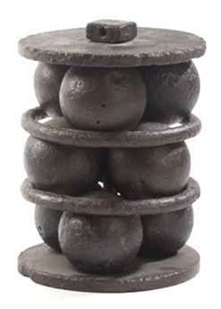

That image is grape shot, which was a naval and heavy artillery round. It is not the same as canister. Canister has a metal can with a wood sabot on the end. The can is packed with balls and sawdust and the end covered with a metal disk. There are already a few good images of canister in the thread. One additional item regarding canister is that there would be a powder bag attached to the sabot ( the wood plug at the base)
