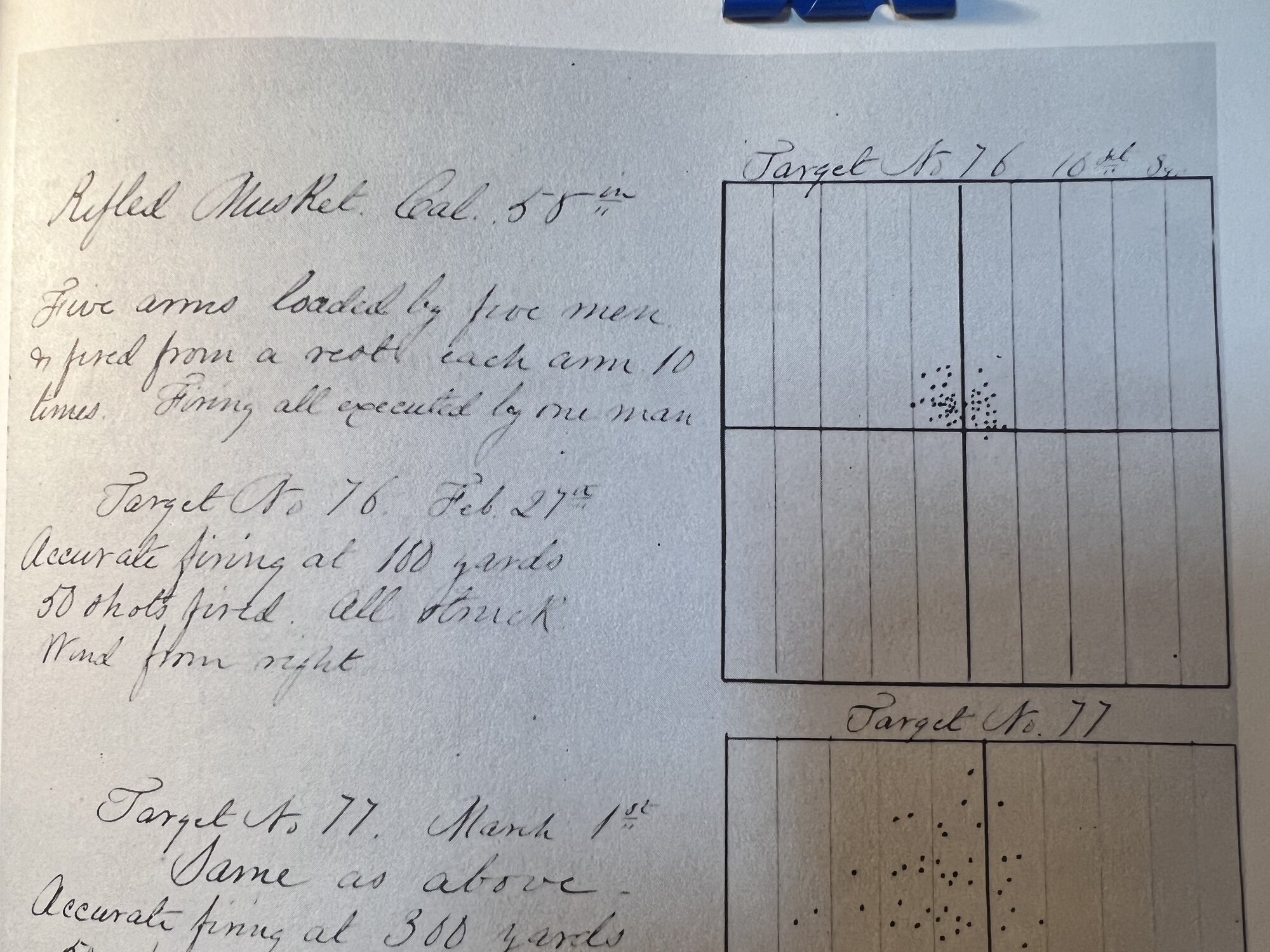

All will be revealed in Claude Fuller's The Rifled Musket. In 1860 the Ordinance Bureau conducted tests of long arms & carbines. 6' X 6' targets were fired at by serving soldiers.
The test included .69 cal smoothies, breech loading carbines & everything in between. The test results showing the effective range for carbines is surprisingly short.

Not a silly question at all.
The simple answer is that a carbine is good for killing a rabbit at 15 yards,
while a rifled musket could bring down a deer at over 100 yards.

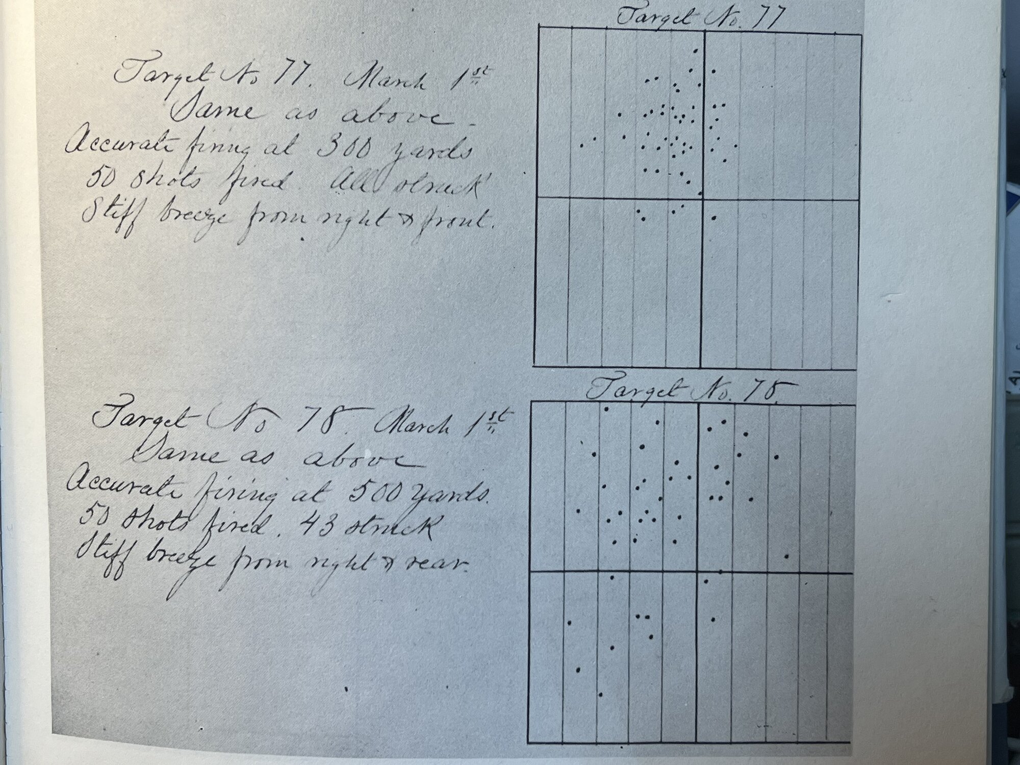

So for a .58 caliber rifled musket, fired at 100 yards (by one man) was deadly. At 300 yards, still effective but the tight grouping is no longer there. at 500 yards, still pretty accurate on a 6' x 6' target (86%) but likely not so effective because the grouping is so scattered.

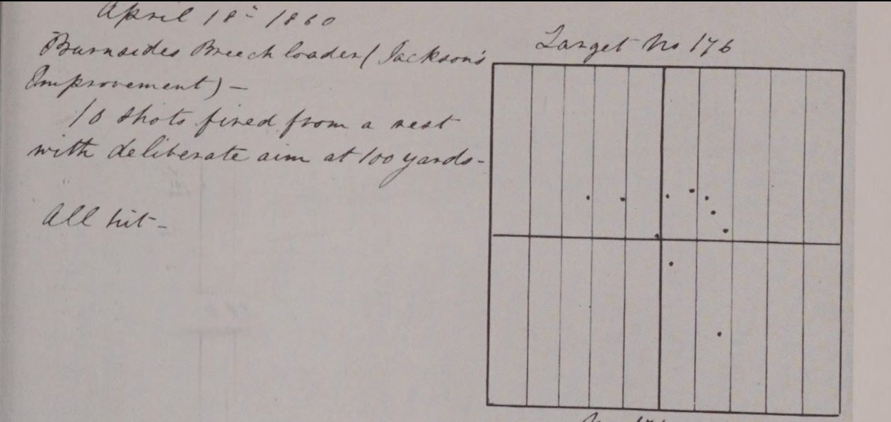

A Burnside Carbine at 100 yards, six shots fired and in a fairly tight group, all struck but the rifle malfunctioned during testing. At 300 yards, just 4 of 20 shots hit the target and they were scattered wildly. At 500 yards, 20 shots, 1 hit.
With something called Jackson's Improvement, the accuracy increased though the groupins were still scattered.
So the next question is, how close were most firefights in the Civil War? It appears to be less than 150 yards.
