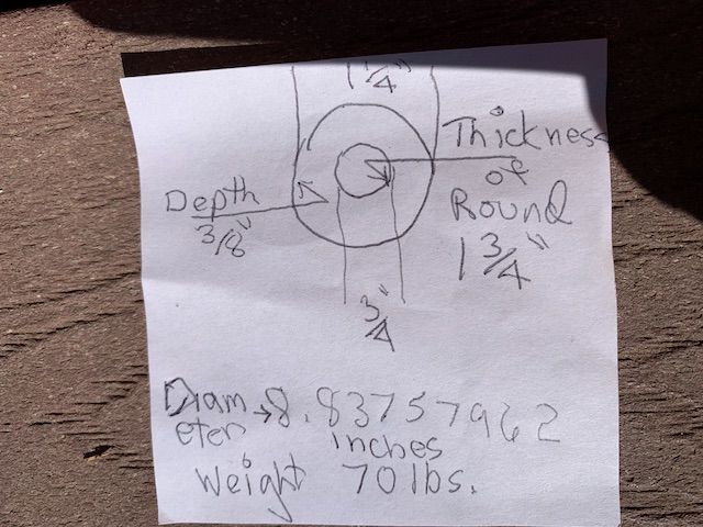

Hello;
I am a newbie I received this round about 25 years ago. Some kids were stealing cannon balls from a civil war memorial at a local cemetery. The were breaking them out of a cement circle around a flag pole. It was decided to remove the rounds. I collect ordnance so I was given a round. Its diameter is 8.8 inches and weighs 70 pounds. I would like to know if it is a cannon ball or a mortar round? Also what type of fuse did it take? Thank you, Vaughn

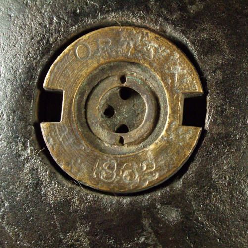

Welcome. Nice ball. From the looks of the hole it would have had a naval fuse.
photo courtesy of relicman
It definitely looks like a cannon ball due to the way the fuse hole is constructed. The size does not match up to any listed in the 1862 ordnance manual - it's between a 8" ( 7.88) and 10" ( 9.87) in size. The weight is also right in the middle of the 8" and 10". The 1841 ordnance manual has a table of foreign guns, and it matches up to a French 8" mortar (8.834). However, there were quite a variety of non-standard guns that are not in the ordnance manual,
Mortar balls usually have lifting ears (indentations on either side of the fuse hole). You appear to have a fused ball for a 9" smoothbore gun.

The fuse photo I posted is from a 9 inch Dahlgren and is a naval fuse. I believe your round is in fact a surplus Dahlgren.
