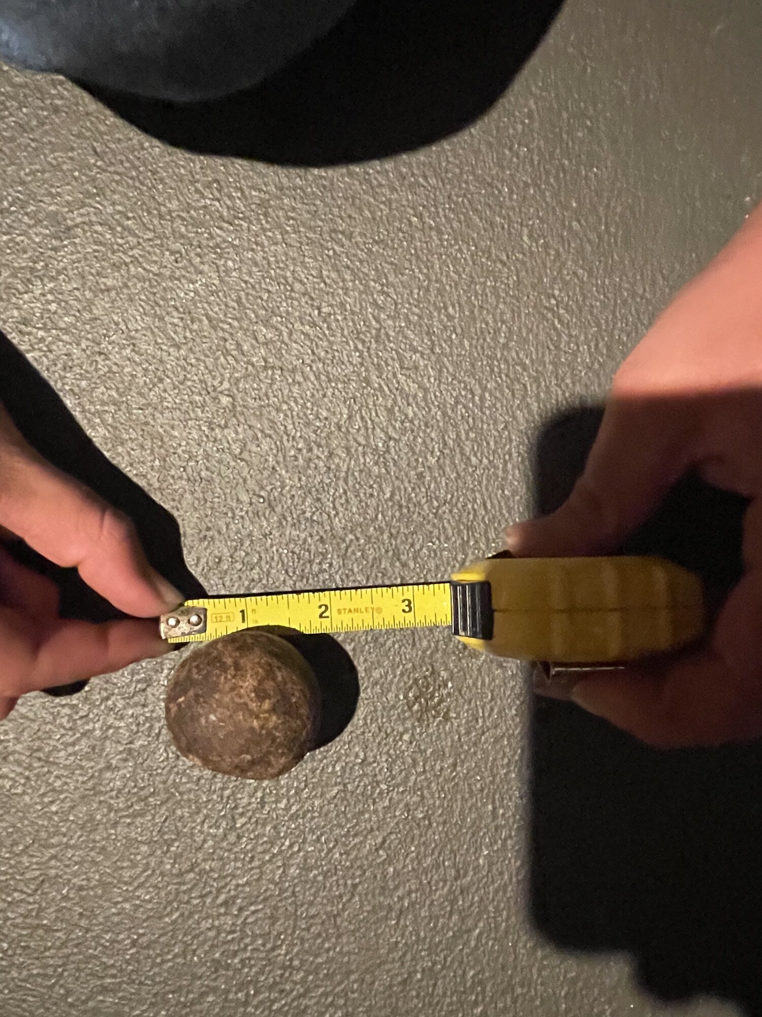

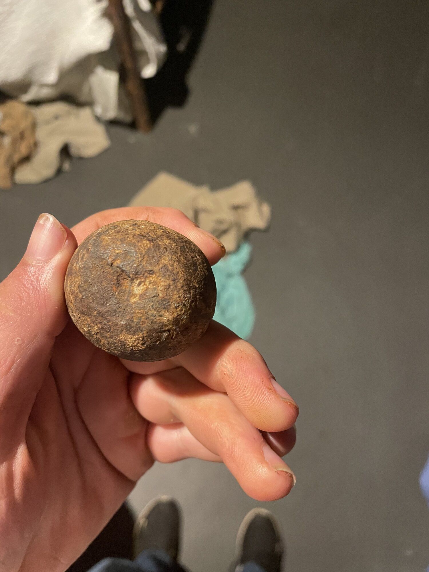

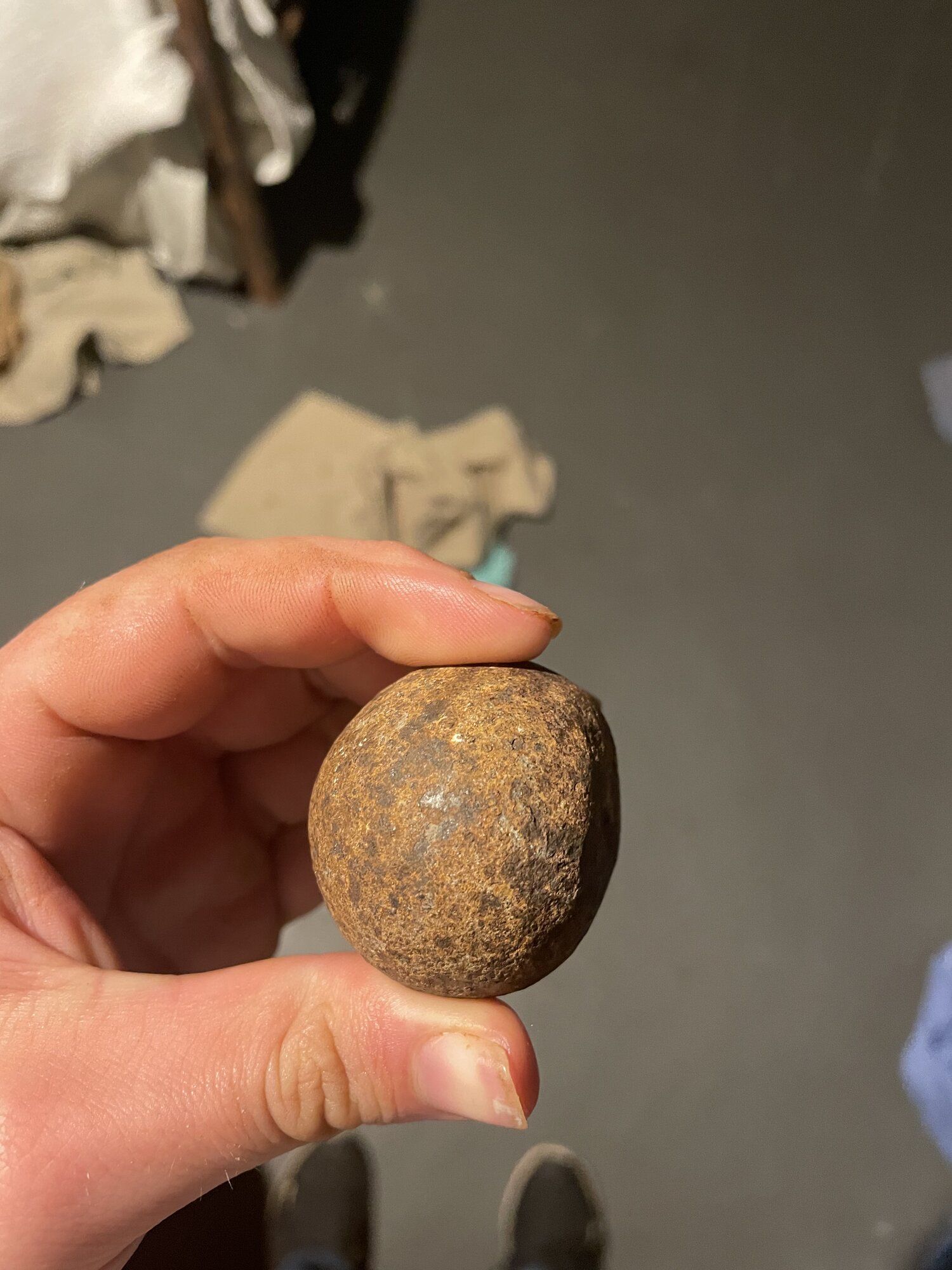

Hey y'all so a few months ago the person at the local antique shop gifted me what looks like a canister shot from a cannon he has a few more but he gave the rest to his son he said he found them in Rose Hill Alabama which is basically our home town he said he also saw like trench looking structures but didn't want to go in them due to them looking not looking safe I asked him if he knew where the place he got it from was but he has bad memory so I was wondering if you can confirm if this is I think grape shot or something like that and also maybe tell me why it would be down here
If able an accurate measurement using calipers, and its weight would greatly help determining same. Each respective gun caliber had different sizes of canister, which can be compared to the period shot tables. May be optical illusion in the pics but the object seems to be a bit "out of round" in shape. If so tends to lean it away from potentially being artillery related. Iron balls had many other uses beyond cannons.
View attachment 503258View attachment 503259
I measured the best I could I don't have a clamp so I used a measuring tape
It's got one flattish side but besides that is pretty spiracle
A bit hard to tell with the shadow but most 12# canister was about 1.5 inches. It does look out of round.
Yeah idk if it was fired and it hit something that caused one side to be flatter that's the main problem is the lopsidedness that it makes it more difficult to tell if it's a canister shot
Originals were made out of cast iron, hard and brittle but which is not malleable, so they wouldnt be able to dent, deform or flatten, like steel will. Based on your tape measurement it appears about 1.7 in. The 12lb canister would be 1.48in, (.43lb) the next caliber up in use during that era would be the 24lbr gun who's canister is at 1.86in. (.86lb). They were precision made with fairly low tolerances of .03 or less. The measurements as well as the deformity tend to lean it away from likely being canister.
Ight thanks for answering the question I really appreciate y'all I'll let y'all know if I find anything else
