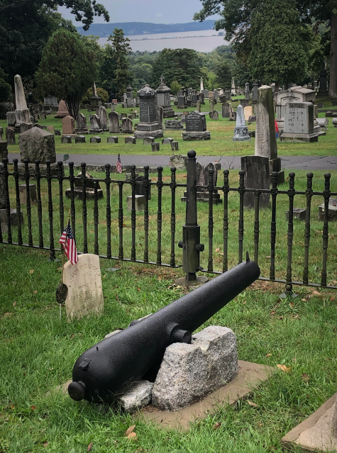

I was at the Civil War monument in Oak Hill Cemetery in Nyack, NY and saw this cannon in front of the monument. Anyone know what kind of cannon this is? The statue was dedicated in 1877, so I think it was a Civil War Era piece of artillery.

Looks like a 3" ordnance rifled cannon.

Your piece is a 3" ordinance rifle, also called a Rodman. There may be markings around the muzzle. It fired a 10 pound bolt of several designs. The table of fire was pasted on the inside of the lid of each ammunition box. "One pound of Dupont's number 10 powder" sent the bolt down range with great accuracy. It both out ranged & was far more accurate than the 1841 model six pound smoothbore pictured above.

Huh, I didn't know the 3" Ordnance rifle was also called a Rodman - I'd always thought that the term was reserved for the "Rodman guns" designed by Thomas Rodman, which were predominantly large coast-defence smoothbore columbiads; the 3" Ordnance rifle was designed by Griffen and modified by Reeves.
Is there a place where the 3" Ordnance is referred to as a Rodman in period documents?

The Rodman were only built in 8-inch, 10-inch, 13-inch, 15-inch, and 20-inch.

You will find very occasional references in journals, correspondence, etc to these as "Rodmans". I'd have to check but IIRC even such as McClellan casually referred to the 3" as "Rodmans". I suspect that may have come about because Rodman served on a board that determined a general shape for guns which the Ordnance Rifle fit within. "Rodman" technically is a process that was not used for the Ordnance Rifle but the term was properly applied to the (larger) guns made using that process.
I see a couple of cases of "4 1/2 inch Rodman guns" under friendly command in the Peninsular campaign ORs, both from the 1st CT Heavy Artillery (one each from Tyler and Kellogg, Colonel and Major respectively). No mention of such in the Maryland Campaign section of the ORs or in any of the others in McClellan's tenure (the quickest subset to check), or in the Northern Virginia section corresponding to the Peninsular Campaign.
Two mentions of Rodman guns (of no specified calibre) in the Gettysburg campaign:
20th NYSM once mentions enemy Rodman guns firing on them, which doesn't really tell us anything given the difficulties of determining what they mean.
2nd NH mentions Rodman guns replacing the ones they were previously supporting around 5PM on July 2nd. Thing is, that's all 3rd Corps stuff (it's in the peach orchard) and 3rd Corps had no 3" Ordnance rifles (they only had Napoleons and Parrotts)... though the report indicates they were getting support from the artillery reserve, and the battery in question (the one described as Rodmans) later spiked some of their pieces. This could be Ricketts' battery (which was Ordnance pieces) as they did spike their pieces, but it's a thin reed in isolation and the same place mentioning Ricketts spiking his guns mentions them as being in the "right center" (not what I'd have called the Peach Orchard part of the position).
I included the Rodman reference because it is used very often in original sources. Thanks, I never really knew why that name was associated with the 3" rifles. I assume it is in keeping with the custom of calling artillery after individuals ( Wierd, Ames, Napoleon, Parrott, Columbiad, etc.) rather than by a technical title.
