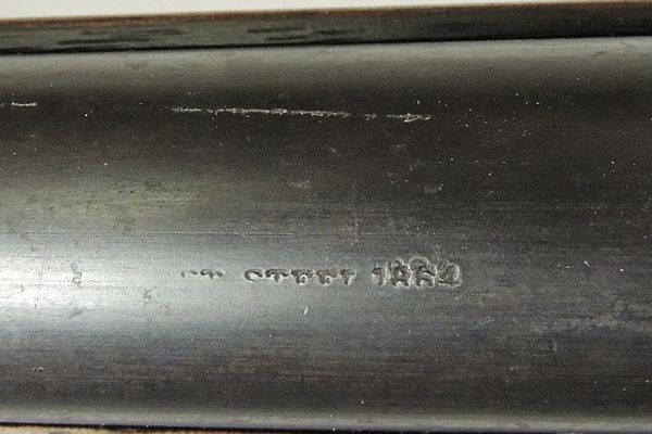

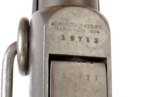

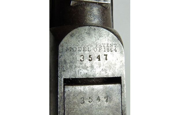

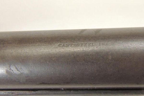

The Burnside models have always been confusing. I guess the best way to determine the difference is below.
Model 1864 markings.
So called 5th model markings.
