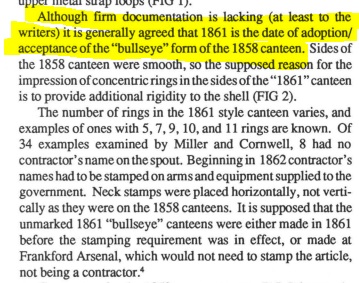

According to an article on the subject by William G. Phillips and Carter Rila, "Oblait Spheroid Canteens, 1858-1916: A Standard pattern Recognition Guide" military Collector and Historian, Summer, 1989, vol. XLI, no. 2:
they speculate the pattern for the bullseye was adopted early in the war, and they were evidently somewhat common by the war's close.
However, some years ago Curt Schmidt on the Authentic Campaigner website shared that they were adopted/manufactured from 1862, and did not necessarily entirely replaced the plainer type: "The 1862 bullseye was produced at Schuylkill Arsenal after July 1862, while other arsenals (Cincinnati and St.Louis, and contractors for New York) and contractors continued to produce the 1858 "smoothside."

Only The Philadelphia Depot produced the corrugated canteens for issue via contractors, though there had been some militia canteens that had the concentric rings prior. The smooth spheroid canteens were easily dented, causing complaints from the field, thus on July15, 1862, the Philadelphia Depot announced that they would specify the corrugated canteens moving forward. (Letter from Col. Crossman to contractor Paul J Field, July 15, 1862, in the National Archives)
As an addendum to this, it was determined, post war that the corrugated canteens leaked and developed pin holes more readily that their spheroid smooth sided cousin. The Quartermaster revered back to an all smooth side canteen for IW and Span Am periods. Many ACW vintage canteens were repurposed as there were copious supplies. The bottom sling guide was often removed and a triangular bracket was soldered onto the upper two sling guides for strap attachment. There were multiple ways that this was accomplished.
