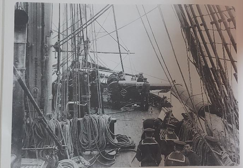

The breechloading Parrotts are relics of what historians call the "Old Navy" period post Civil War & the turn of the Century.
NavSource "Old Navy Steam & Sail Index" USS Pensacola listing has numerous photos of that ships usually long service history. Launched 15 August 1859. Stuck from the naval register 23 December 1911.
Under 'Recognizable Features' it states specifically that, "Did not have a gun deck pivot gun / pivot gun port added during the 1880's."
Armament one 11" Dahlgren Smoothbore, sixteen 9" Dahlgren smoothbores.
In Alexandria Harbor in the photo of the Pensacola does not show a deck gun mounted. Same is true in San Francisco circa 1880. A photo dated 1880 firing her guns at anchor indicate a conventional armament firing from gun ports fore & aft. The onboard photos do not include the presence of a swivel gun.
I intended to find a photo of the swivel gun on the Pensacola when I looked her up. That ship had a remarkably long & varied service life. Didn't find what I was looking for, but that is what makes it interesting, ?no?

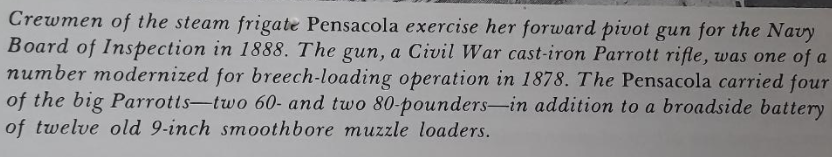

From the book 'The American Steel Navy' by Cdr. John T. Alden USN (Ret.), page 8 as mentioned in post #4...
U.S.S. Pensacola
Armament
1885
twelve 9-inch smoothbores
two 80-pounder breech-loading rifles
two 60-pounder breech-loading rifles
two 20-pounder breech-loading rifles
U.S.S. Pensacola
Armament
1885

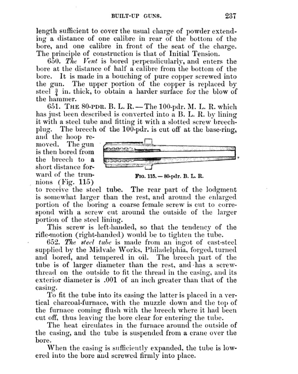

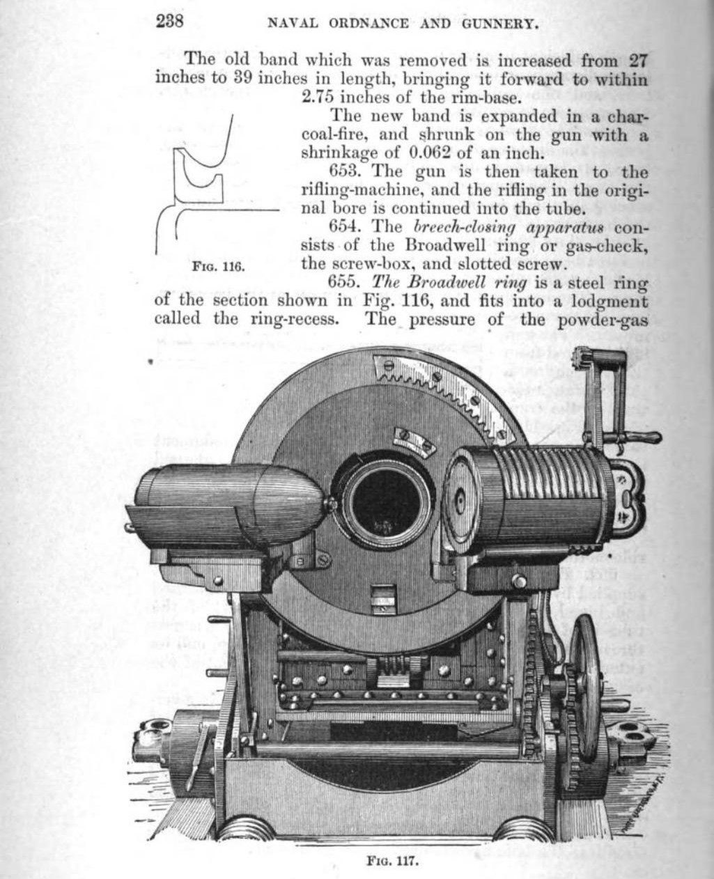

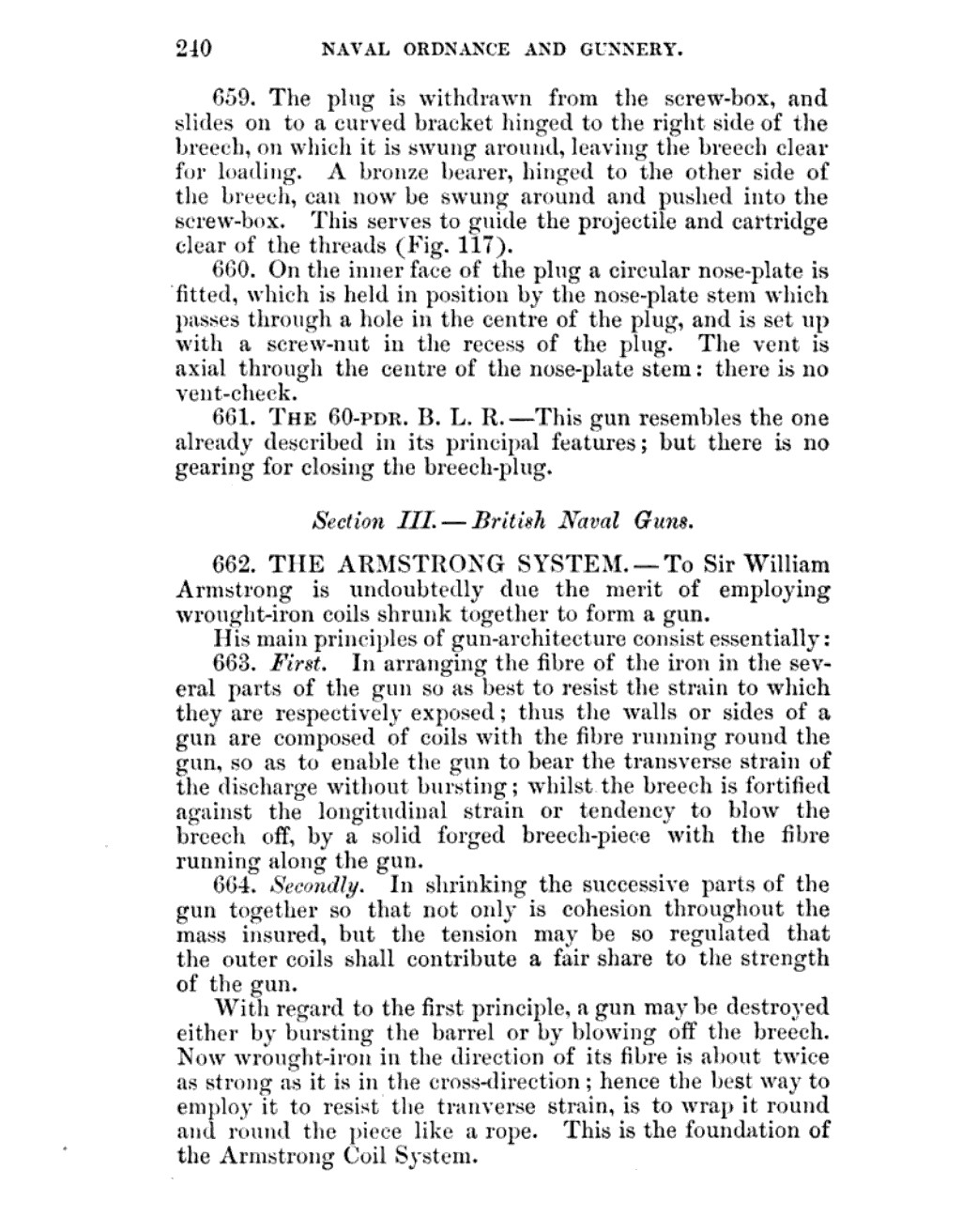

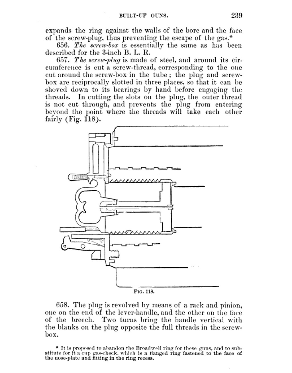

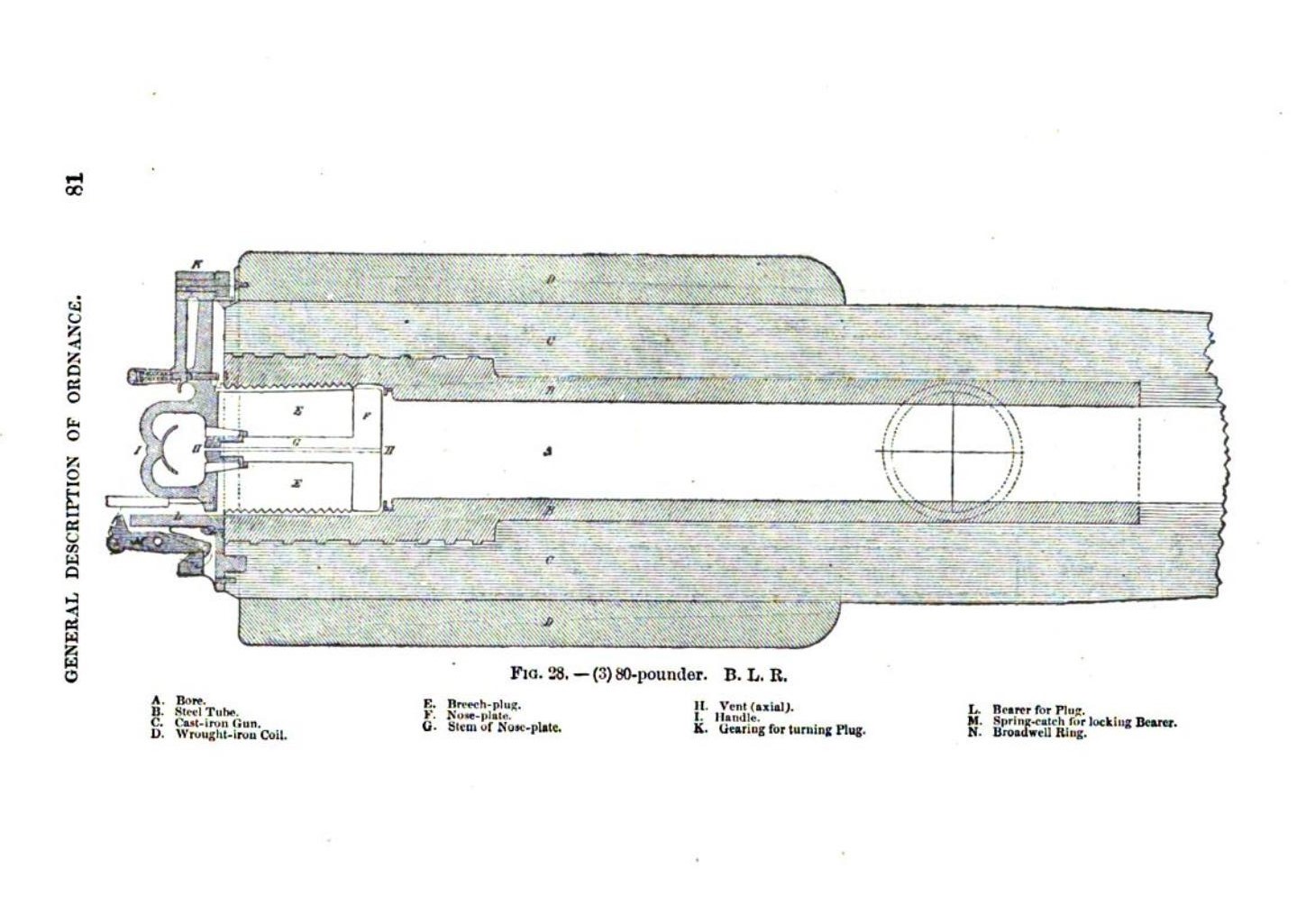

It turns out that it is the 1880 edition of A Text-book of Naval Ordnance and Gunnery by Augustus Paul Cooke which contains information on the breechloader Parrotts. It also has information on the conversion of 11-Inch Dahlgrens to 8-inch MLR.
The book may be found digitized here: https://books.google.com/books?id=vTZ92PqoNlgC
The illustrations below are from the linked book pages 81 and 237-240. Note, whereas I shared photos of 60-Pounder BLR Parrotts in Laconia, New Hampshire, the book primarily covers the "80-Pounder BLR". This was a former standard 100-Pounder (6.4-Inch) Parrott which was called an 80-Pounder after its conversion. Caliber remained 6.4 inches.
The diagram shows the steel sleeve which was inserted into the breech.
