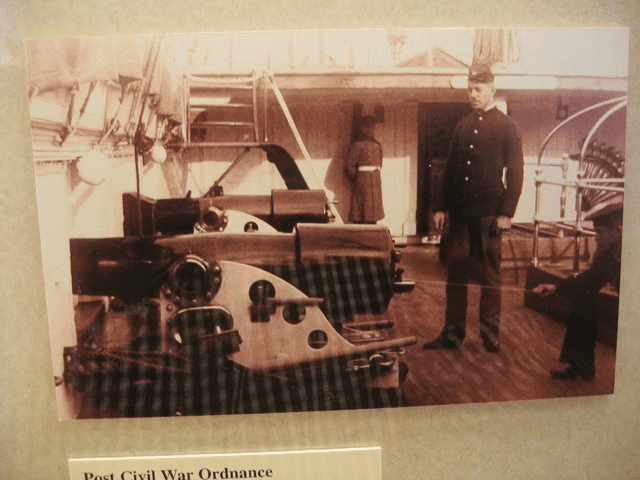

Sirs, was reading that in 1878, some Civil War era Parrotts were "modernized for breech-loading operation..." This kinda caught me by surprise given the reputation of the Parrotts and the call for their removal from service as early as 1862. Was this a case of "...this is what we have so this is what we'll use..." or was this just an experiment and if it didn't work, who cared, it was just a Parrott that was wasted?

The latter days of the the CW the West Point foundry went to the Rodman, Water Core, hollow-cast process on the the 100lb Parrott's which reduced the problem they were having. There are many examples of the US Navy converting Parrott's to breach loading guns.
Converted breach loading Parrott's on the USS Michigan.
Sirs, where I saw this reference was in 'The American Steel Navy' by Cdr. John T. Alden USN (Ret.), page 8, on the USS Pensacola. Reference states that at that time - 1888 - the P'cola still carried 4 Parrotts, two 60 pounders and two 80 pounders. The breech-loading modified Parrott in the pic was her forward pivot gun. So could have been either size?

I am surprised to hear about this, I know that 3" Ordnance Guns were converted but with the Parrott's breech weakness (real or supposed); I can't see this happening.
Indeed sir - that's what caught my eye. "Modify a Parrott? What?!?"

I knew of 3-inch Ordnance Rifles being converted, but Parrotts getting the same treatment is news to me. Going by the photo it looks like they had a different system than with the 3-inchers, I want to see pictures of the breech now. It looks interesting.
I know that this is an OLD thread... but these are also old cannons!
I've looked for a digital version of the above photo of breech loader Parrott rifles aboard USS Michigan on the internet, but I've not found it. Do you remember in what museum this photo was displayed?
These look similar to the 5.3-Inch Parrott breechloader conversions in Laconia, New Hampshire. I took the photos below in August 2024. More photos here. Photos of the Trophy Park Parrotts may be found here.
