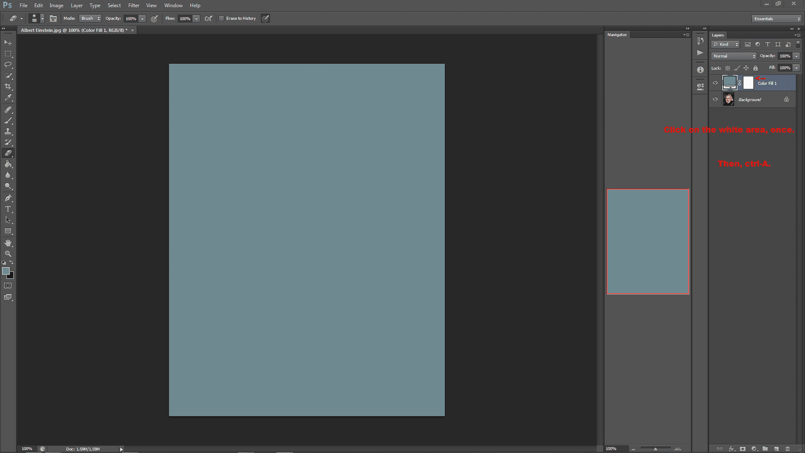

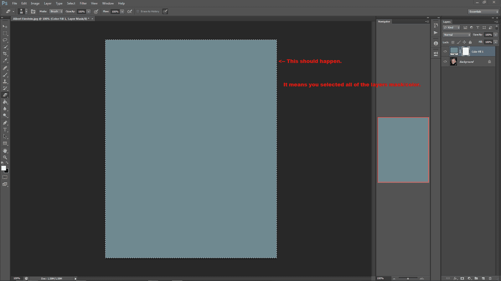

Love the tutorial, I get stuck at the same as the user above, filling the screen with RED. When I hit CTRL>A>DELETE, nothing happens. I tried using the link shown but was none the wiser. I'm fairly new to Photoshop, does anyone have any suggestions? Merry Christmas!
You have to actually press once on the layer mask, then ctrl-A->Delete.
