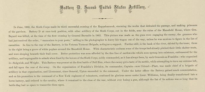

Gardner in his Photographic Sketch Book identifies this group as Battery D of the 2nd U.S. Artillery. A print of this image in the National Archives (NARA - 533305) also confirms this.
Thanks. I have always seen it labeled as Battery D 5th US. So we now have another question.
Battery D 2nd US had 4 - not 6 - M1857 Napoleons at Gettysburg. It's possible they turned in two of their guns between June 3 and July 1 but hardly likely and that would make no sense. The notion that the battery is actually "in action" also makes little sense, for the reasons I stated (as opposed to being "in the presence of the enemy"). Bottom line - I think the ball may have ended up "on the turf" in the "hand off" between O'Sullivan and Gardner.
