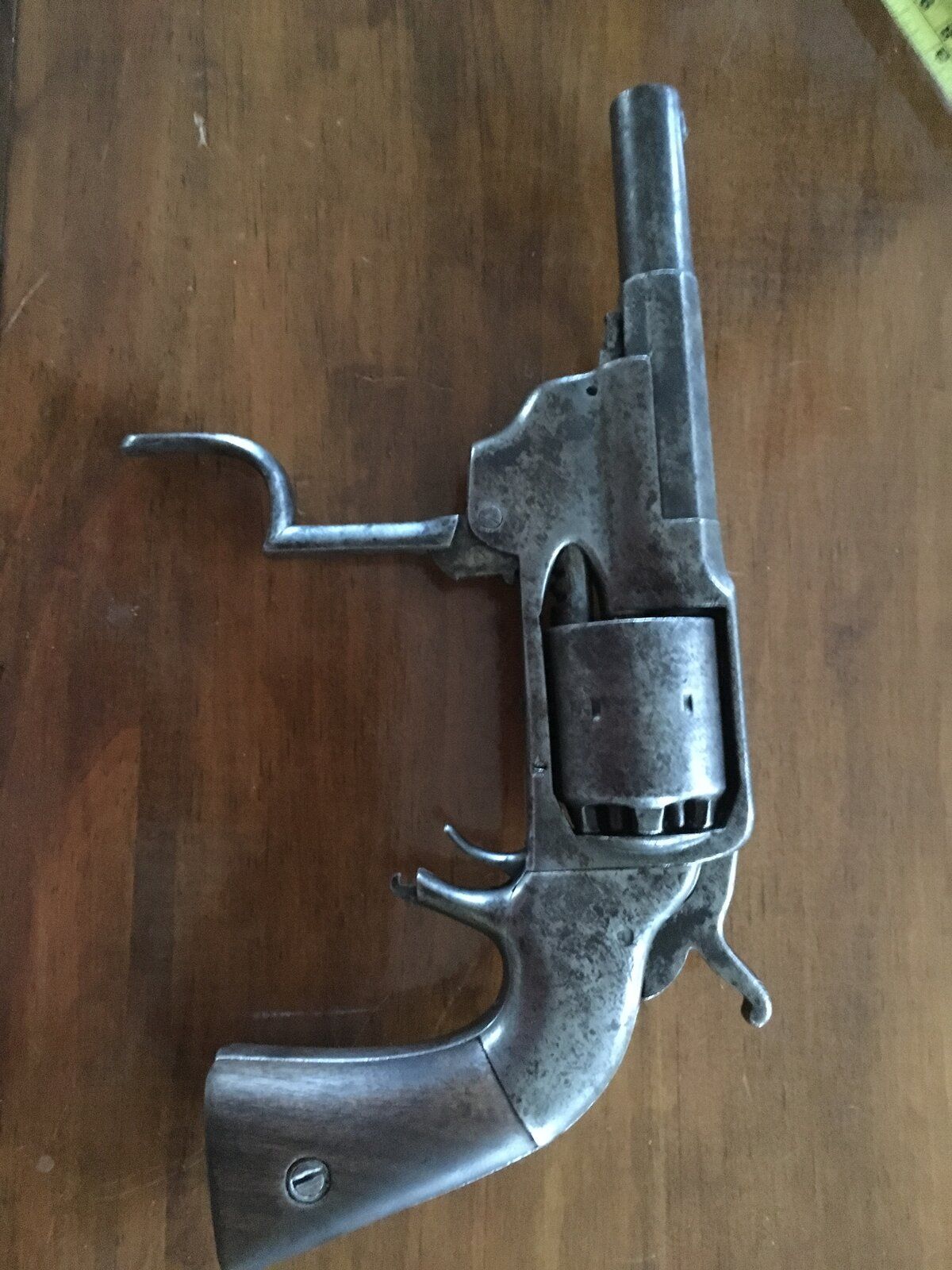

My wife went alone to a local auction a few years back and surprised me with one of the items she purchased for $57
The barrel seems somewhat short to me, but I am out of my realm with most antique firearms.
Was wondering what some of CWT experts can tell me.
(The handle grips were in terrible shape so I had a friend hand carve these replacements out of walnut. I kept the original handle grips, which had matching serial numbers on the inside of the grips)

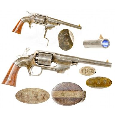

I am no expert, but the Army versions of this pistol were in .44 caliber, and the Navy version was in .36 cal. Only about 500 Navy versions were built. The revolver was produced in barrel lengths of 5, 6, and 8 inches. Some parts are missing.
Pictured is an Army version of the pistol, showing how the loading lever was opened and how and where it was hidden.
Compare the photos side by side and you will see the loading lever that the trigger guard operates when lowered appears to be not there for one thing. Note the gear teeth on the rack and pinion
Thanks. I did take a close look. The loading lever works smoothly on mine but I see a part missing under the barrel - with the rounded end (I assume it's part of the loading mechanism). The cocking and trigger work fine and the trigger pull is strong. There's about two inches missing from the end of the barrel but whoever cut it, took the effort to put a sight in the modified barrel.

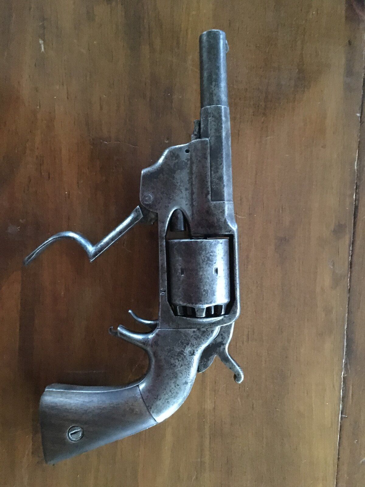

Thanks. Here'a a photo of mine opened.
I appreciate the info on different versions and barrel lengths. Mine is a .44 with a 6 inch barrel. I had always assumed the barrel length had been shortened but it still had the sight at the end which didn't make sense. Many thanks.
