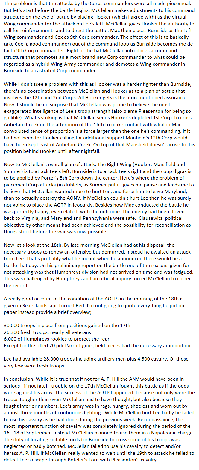

Is there a source for this?
It looks like it's written by the person themselves, since the misspelling ("Landscapr Turned Red") allows for easy searching.
Honestly I think considering Humphreys fit to fight on the 18th is a bit of a questionable prospect, since they were thrown together on the 12th and departed Washington on the morning of the 14th.
