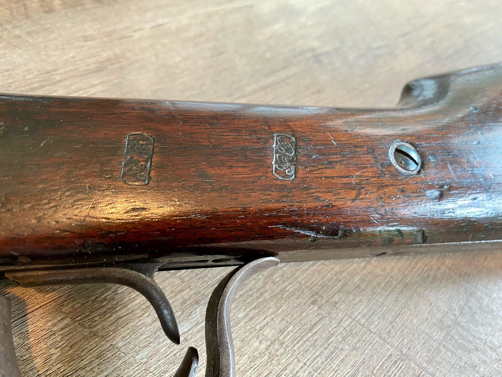

I think there is a very nice gun hiding under the muck, looks like a nice cartouche in the wood.
As I said, I'm new to collecting, but even I know that the rust will continue to eat away at the metal if nothing is done. I'll start by wiping it down with Ballistol (picked up some yesterday) and maybe a scrubby type pad to start. I'll then move to brass/bronze wool if needed. Guy at the gun shop said let the oil soak in a bit and don't rush it.
it does have 2 nice cartouches. I don't know if all of these were blued. I can see a bit here and there but on close inspection, it looks like a silver colored barrel.

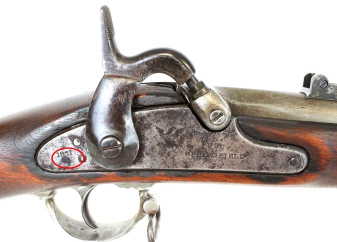

what would you guys do to remove some of the black patches shown here on the lock plate, like what i have circled?
I don't remove those, cuz they give great character to the gun. Also, they are embedded deep. You would have to remove alot of metal, leaving a noticeable divot, which would then require you to remove even more metal overall to reduce the divot. Basically, you'd be chasing a "polished bright" look and you will have ground off most stamped letters/images and the defined edges on the gun...not adviseable since it would greatly reduce the collectibility/value of the gun....but I am not here to judge, and others could perhaps better explain how to achieve a "polished bright" look if that's what you want.
I've never used it, but you could apply "naval jelly" on those individual spots to eliminate the black, but the parts that have been jellied end up with a weird silvery-white colour/patina. If you don't naval jelly the entire gun, then those spots stand out starkly. Having seen guns that were entirely treated with naval jelly, it's not a pretty look....you end up with garish looking bright metal. Sorry, I wish I had a pic to illustrate what I am describing.
Those black patches are iron oxide, and if you can find a way to remove it, you will end up with bright metal with deep pits, and that's not a good look.
I think it would look better if you would rust back the shiny metal to a darker color which is closer to the black pits.

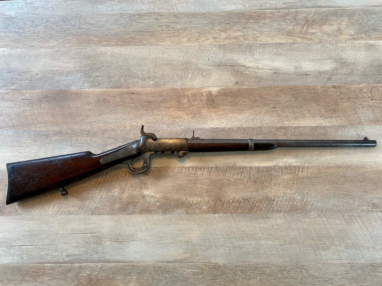

I've gone over the gun with some Ballistol and Kramer's. I used bronze wool (lightly) on parts of the barrel. I tried to clean the bore with Hoppes. much of the surface rust is gone and the deeper stuff is oxidized. Metal is fairly smooth to the touch with a bit more pitting here and there. The stock is in nice condition, rougher around the butt. Overall, I think it came out good. The buttplate is still really rough, though. Here are some pictures.
