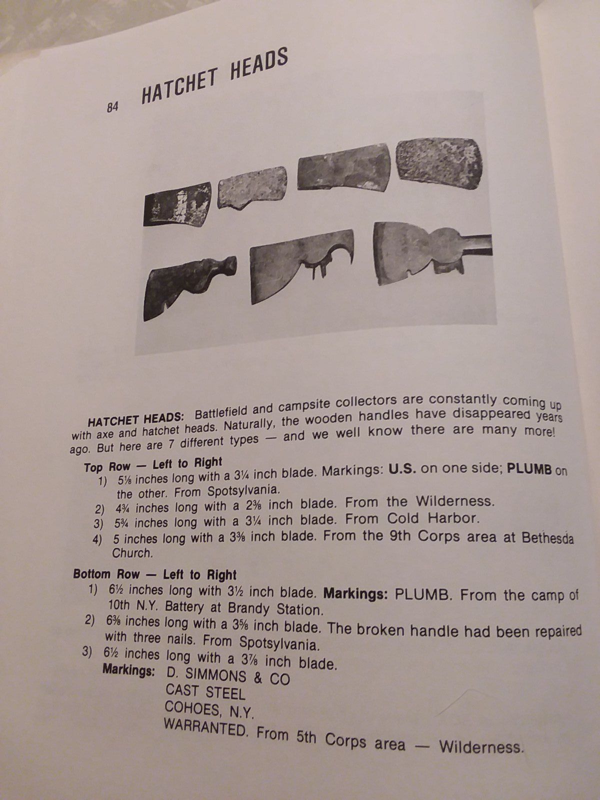

This is something I have wondered about for some time. Does anyone know what pattern of hatchet is accurate for the 1860's? I've seen photos of hatchet heads dug at battle sites, but some I believe postdate the war. Does anyone have any info, period pictures, documentation, etc.?
Francis Lord, writing about 1960 in the "Collector's Encyclopedia," says: "Two types of hatchet heads have been recovered from campsites and battlefields in recent years. These show clearly that there has been practically no change in design and size of hatchets in the past 100 years." (vol. I, p. 48). In vol III, on p. 84, there is a picture of several hatchet heads, with dimensions given in the caption. It looks like this:There is very little difference from postwar hatchets for a long time. Farm tool can be hard to date because the same model may remain in use for multiple decades. I carry one like the one on the bottom right for pounding in tent pegs.

Francis Lord, writing about 1960 in the "Collector's Encyclopedia," says: "Two types of hatchet heads have been recovered from campsites and battlefields in recent years. These show clearly that there has been practically no change in design and size of hatchets in the past 100 years." (vol. I, p. 48). In vol III, on p. 84, there is a picture of several hatchet heads, with dimensions given in the caption. It looks like this:There is very little difference from postwar hatchets for a long time. Farm tool can be hard to date because the same model may remain in use for multiple decades. I carry one like the one on the bottom right for pounding in tent pegs.View attachment 325268
The problem I have with the Civil War Collectors Encyclopedia is that there are several items included that were either of a style not introduced until after the war, or are marked with company names that weren't in business until after the war. For example, two of the hatchet heads shown here are said to be marked "Plumb". That company wasn't called that until 1888, and their hatchets weren't marked as such until the early 1900's. I try not to be too crazy about accuracy, but I do want to do the best I can with what I have. I don't particularly care when I'm using it around camp, but for display purposes, I want it to be as close as possible. I guess this proves that just because it was found on a battlefield, that doesn't mean it is from the war. Oh well, close enough for government work as they say.
While that's true, as I said, farm tools don't change very quickly, and that style is still representative of the 2nd half of the 19th century. To see real differences in an item like that you really need to compare it to a hatchet from, say, 1760. My grandfather was a blacksmith. He made all the tools for the family in his spare time. I have a hatchet he made not any earlier than 1910, nor later than 1948. It looks like the one on the right on the top row.
Sure, and I thank you very much for sharing this page of the Encyclopedia( I only have volumes 1 and 2). I guess what I'm saying is that if two of the hatchet heads on that page can be proven to have been made after the War, we really can't consider them examples of what they carried during the War. However, I do believe that you are correct about the hatchet on the bottom right being correct. I always appreciate the advice of reenactors more experienced than myself( which includes about everyone). I thank you again for your input.
