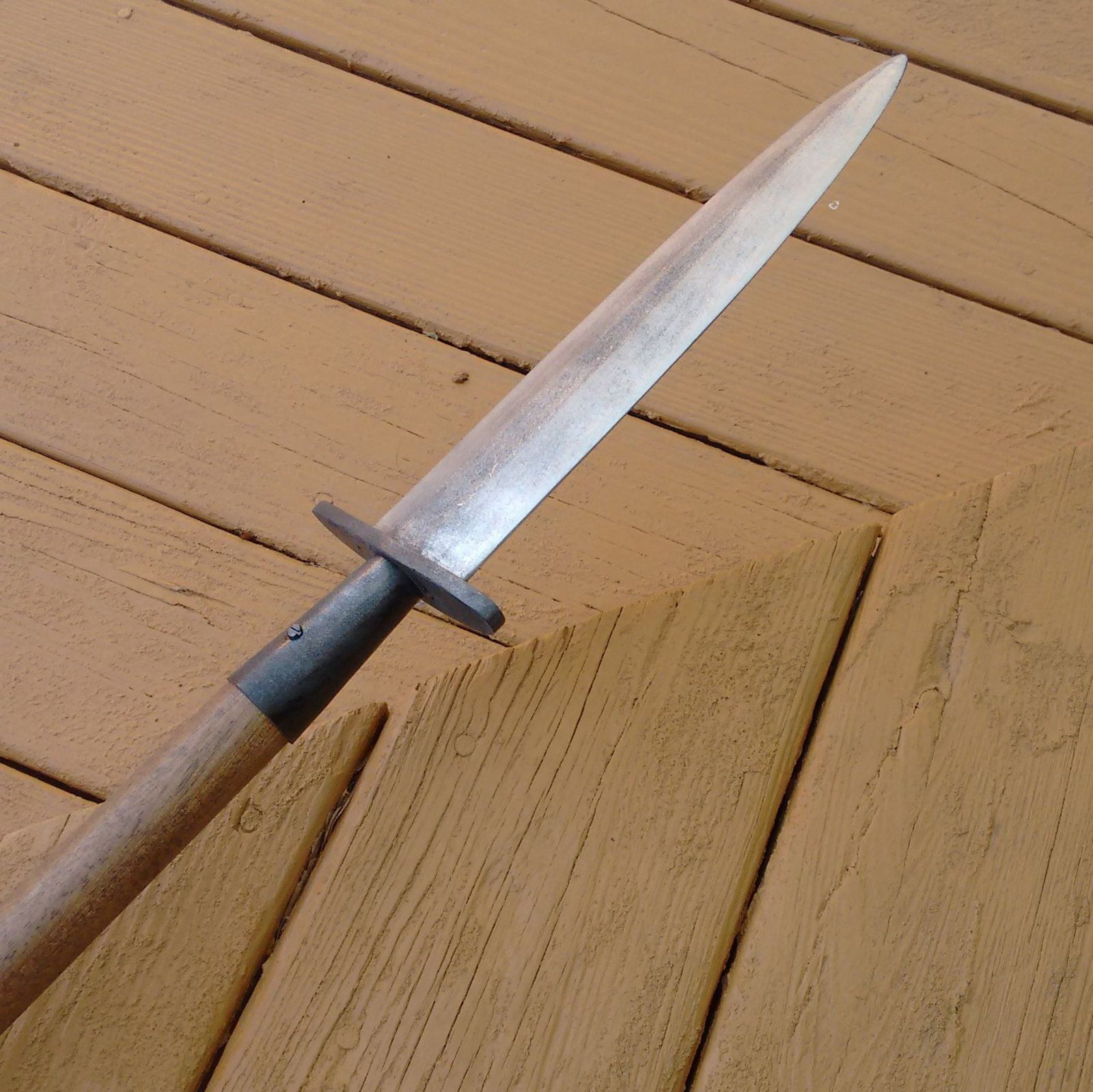

Anyway my thinking is that; to mimic John Brown's situation; my repro (pic below) is "good enough for not-government work." What say y'all?

Anyway my thinking is that; to mimic John Brown's situation; my repro is "good enough for not-government work." What say y'all?
Awesome pike. What y'all use for the staff?
Ok, you get that one. Commercial Custodial supply houses sell 6 ft. long replacement push-broom handles, 1-1/8" diameter. (Box stores and Wal-Mart etc. only have 4-1/2 to 5 ft. replacement handles. The item is cheap, most of the cost is in shipping. But American-Made!

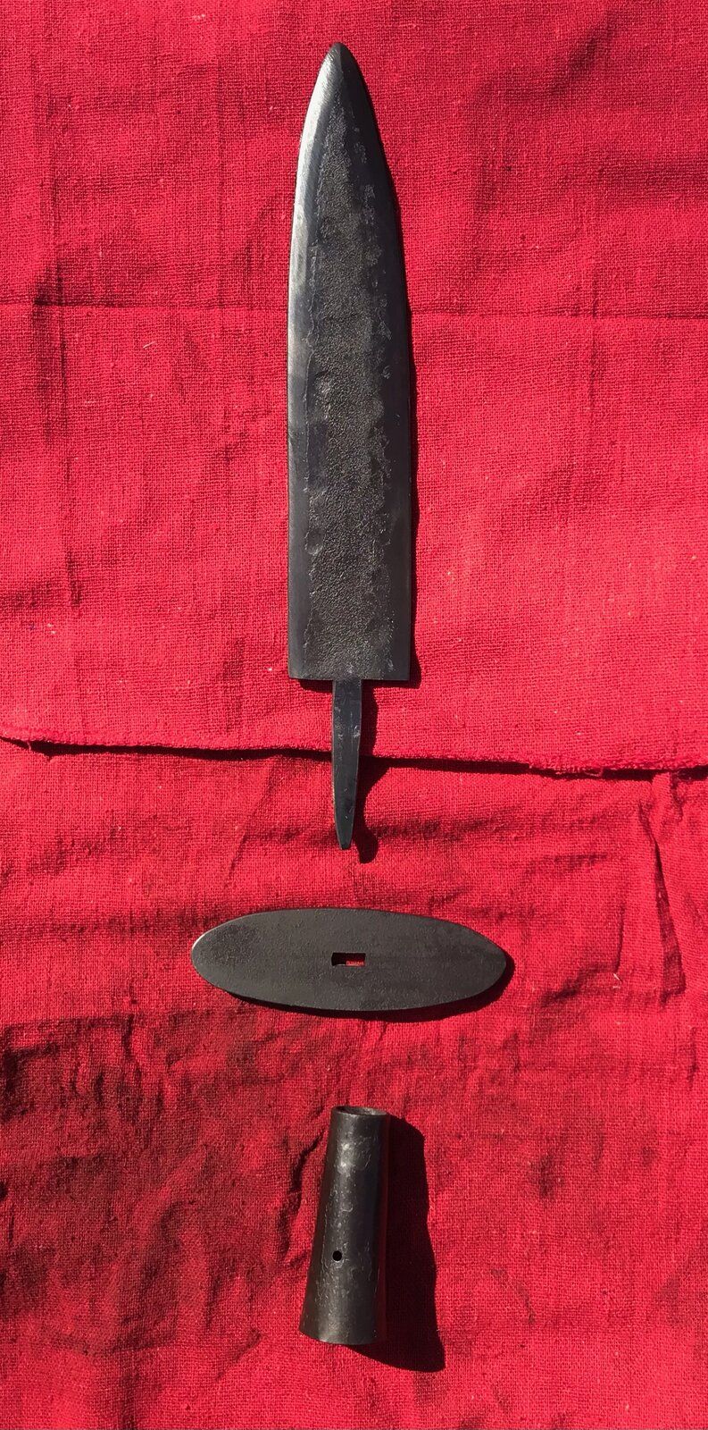

btw, in doing the research, the Baumanworks 150th repros are a bit inauthentic in construction. In the real pike, the ferrule is a separate component. In the real construction the blade itself includes a narrow contiguous shank to insert into the pole, in the manner of knife construction. I suppose it likely was tightened and held in place by a force-fit of that separate ferrule. I wonder which method is stronger? Maybe modern steel is a factor that allows the ferrule itself to instead bear the strain?

In 2009, I produced a small batch (of about 20) reproduction pikes for my friend and mentor Terry Adkins for an exhibition he put together while Artist in Residence at the American Academy of Rome. He was fascinated with John Brown for as long as I had known him, and hoped that this small batch might be a "proof of concept" for a full scale exhibition back here in the US to commemorate the actual 150th anniversary of the raid on Harpers Ferry. That never came to fruition, and sadly he passed away in 2014.

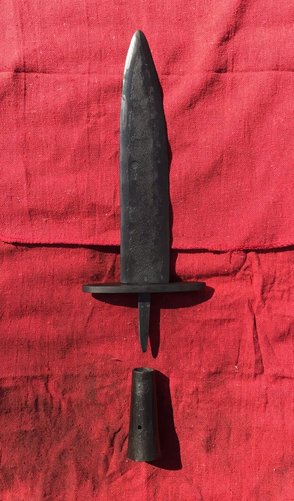

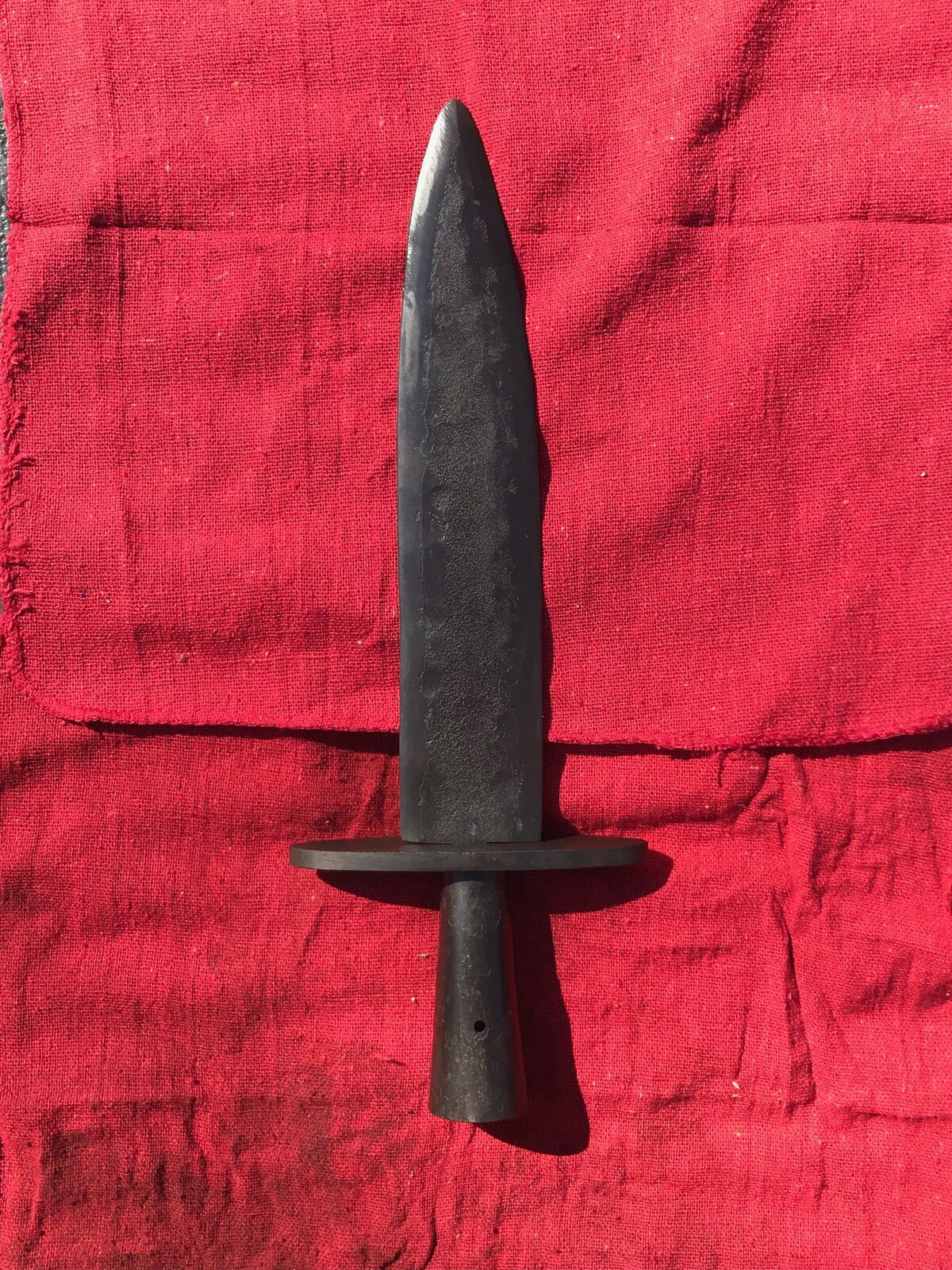

Neither of us claim to be an authority of any sort on any of this, and we based the design of the pikes solely on photographs. Neither of had ever seen or held an actual pike in person. Over the years I have been contacted by several history buffs who wanted a repro pike for themselves. Most had ideas of how to make their pike more authentic, and it was brought to my attention that they were originally made in 3 pieces. Obviously, I fabricate them in 3 pieces (with all the blades using a tang similar to that of a file)...but some people want them kept that way and others prefer me to braze them together. I make them to order as requested by each customer, and make no claim to the perfect historical accuracy of their construction. That said, I make a few each year, and am happy to alter their design as requested by each individual customer.
Hello all. A friend of mine brought this conversation to my attention, and I hoped to clarify.

Thank you for your responses and inquiries. Byron, I think you did an excellent job with yours.
I certainly do not want to misuse this forum as a platform for solicitation. I just thought, based on expressed interest, that I should attach a few more detailed photos of a typical pike that I've made, and extend that if anyone is interested in ordering one from me to get in contact. As these were fairly crude weapons, I have tried to recreate them with the speed and variation that were most likely congruent with the originals.
