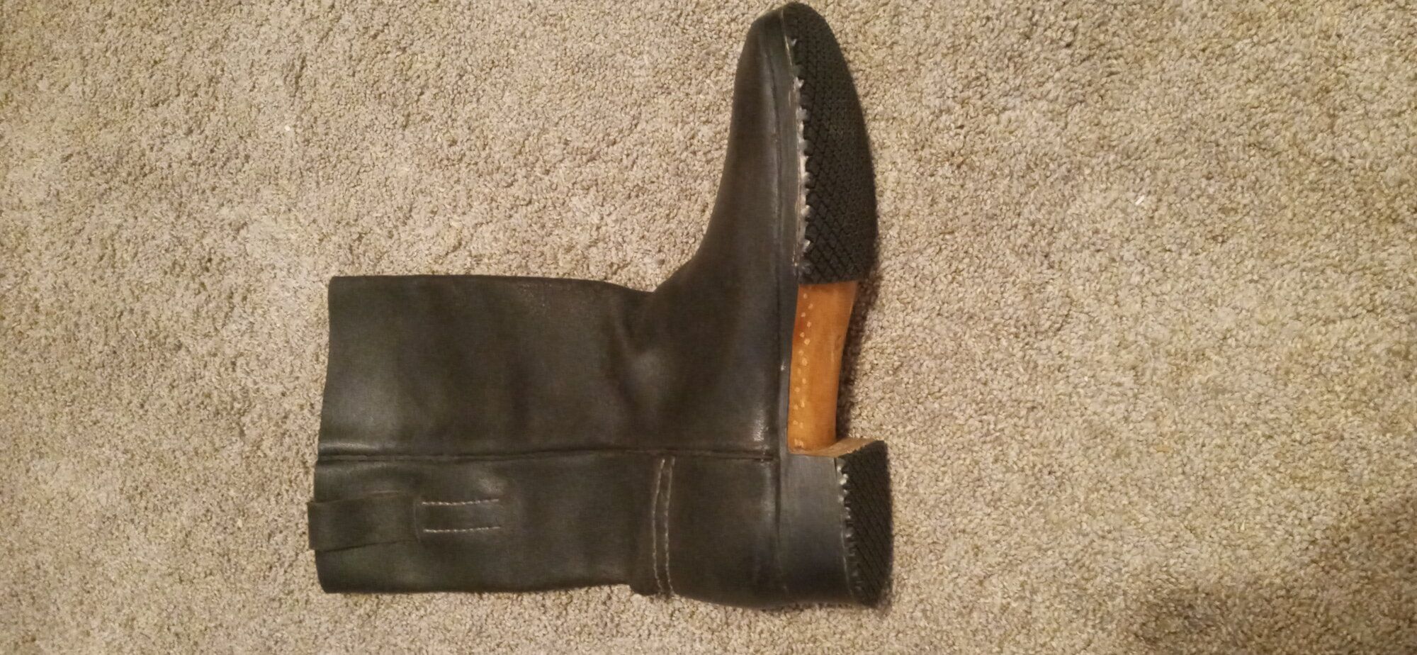

In my opinion, some crafty sutler ought to go and make a pair of period rubber boots! There are certainly surviving examples from the time to copy. I'd buy a pair!

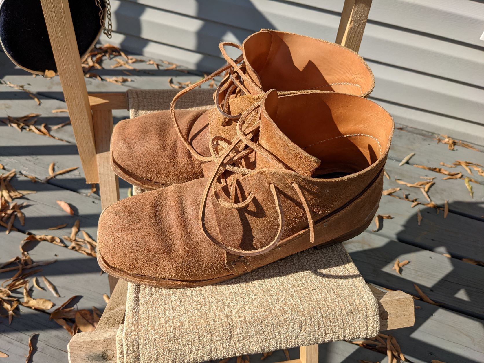

After following this thread, I decided to take my brogans to a shoe-repair shop and have then re-soled with rubber walking soles, as suggested by @Rhea Cole. This sounded like a good option for an older guy who needs some stability when walking, and who would rather not sound like the rear end of a horse when walking on tile or macadam.

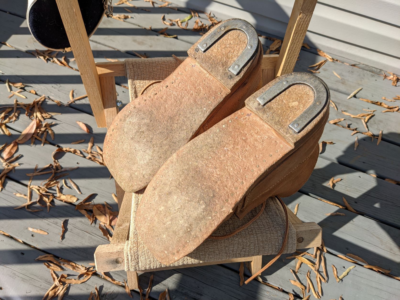

Here's how these shoes were outfitted when I bought them, with metal heel plates:

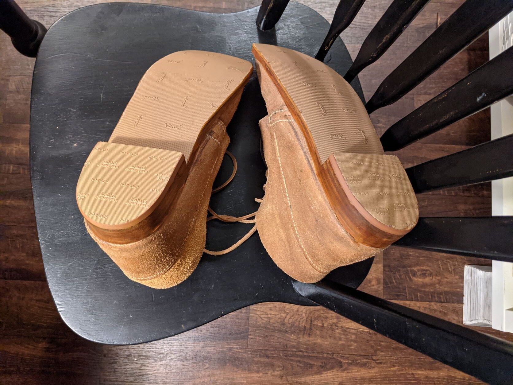

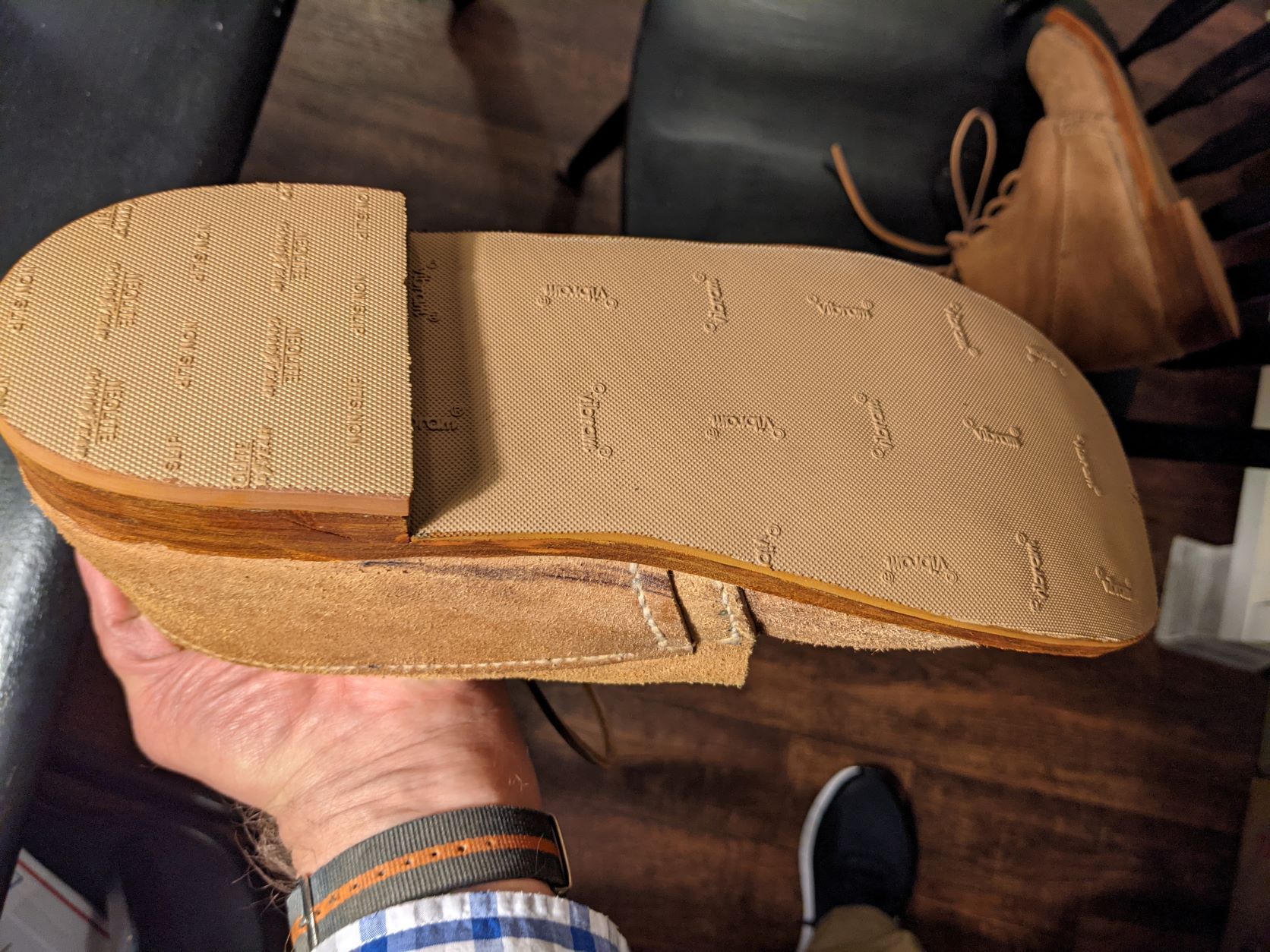

The cobbler re-soled them with an interesting material that is Vibram, but not the black color and waffle pattern I've usually seen. I doubt anybody would notice this material, without looking real closely:
I'm hoping this material will hold up over time. I'll be putting it to the test over the next couple of weeks, using these as work boots around the yard.

That looks amazing! The soling really blends in and doesn't look odd at all. I'm glad my curiosity has paid off for you.
Have you worn them around yet? How do they feel? What so you think of it?
I haven't put them to the test yet. I'm planning to do some yard work tomorrow, so I'll try them out then. This material is pretty thin, so I'm not sure how much mileage I'll get out of it, but it seems worth a try.
