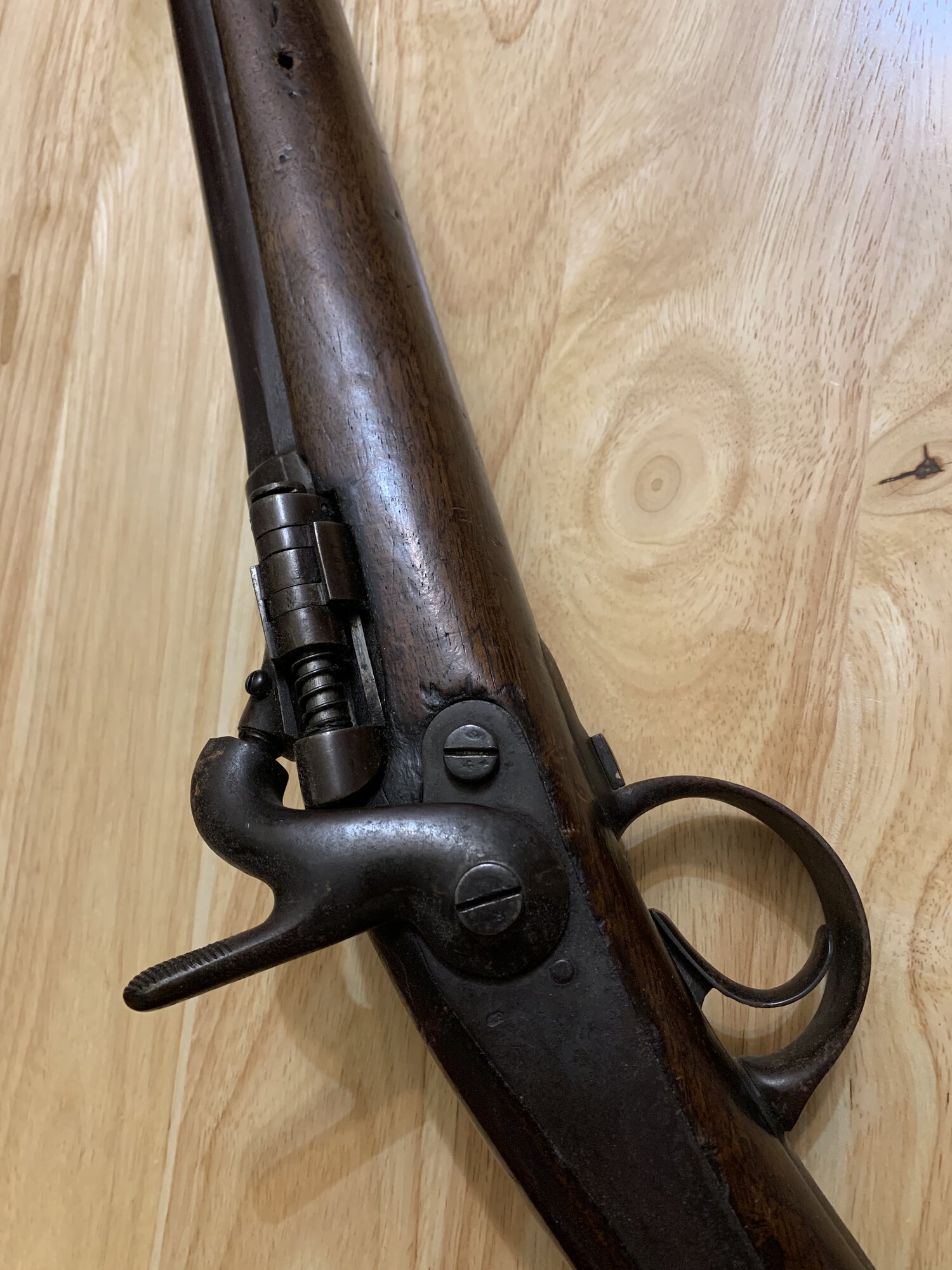

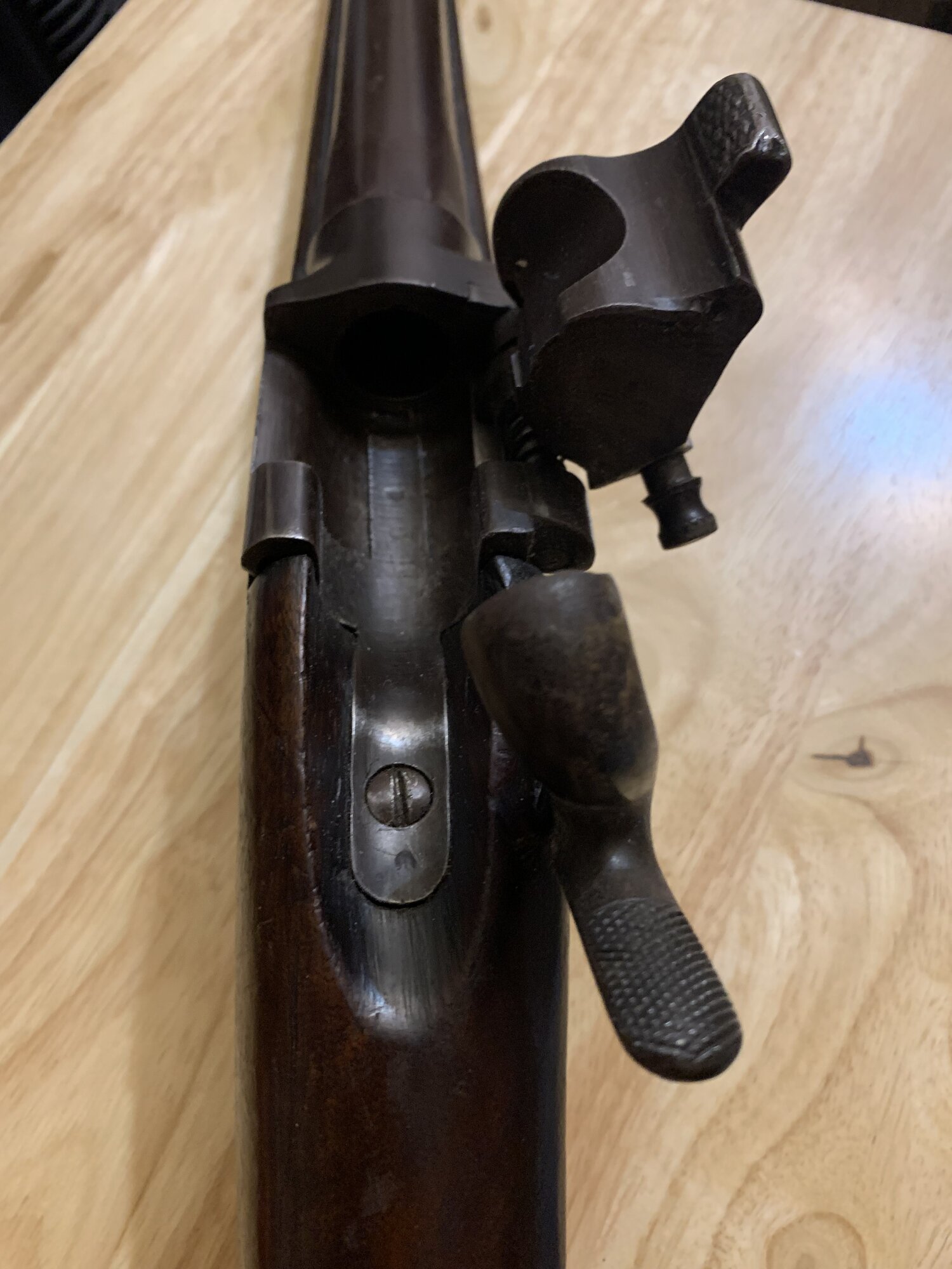

While not a Allin trapdoor or rimfire/centerfire, there were some breech loading conversions of the Model 1842 using the Merrill system.

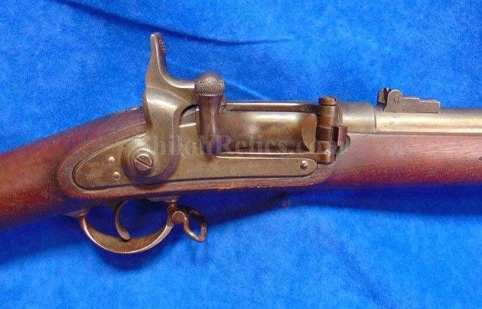

There were breech loading conversions developed prior to and during the Civil War, but the Allin conversions came out just following the war as a method to turn surplus rifle-muskets into breechloaders, and the system became the basis of subsequent Springfield trapdoor rifles and carbines used in the latter quarter of the 19th century.
James Merrill of Baltimore had his hands in several Civil War era firearms – rifles built from scratch, conversions of the Jenks carbines, and also conversions of 1841 Mississippi rifles done by the Harpers Ferry Arsenal. Merrill's conversion involved a knee-joint type lever which could be opened to allow loading of a rifle from the breech. The system was relatively simple, and it was one of three (the others were the Lindner and Montstorm) made in small numbers for testing by Harpers Ferry. It appears that 300 Merrill conversions were done, 100 each of the 1841 Mississippi Rifle, 1842 musket, and 1847 musketoon.

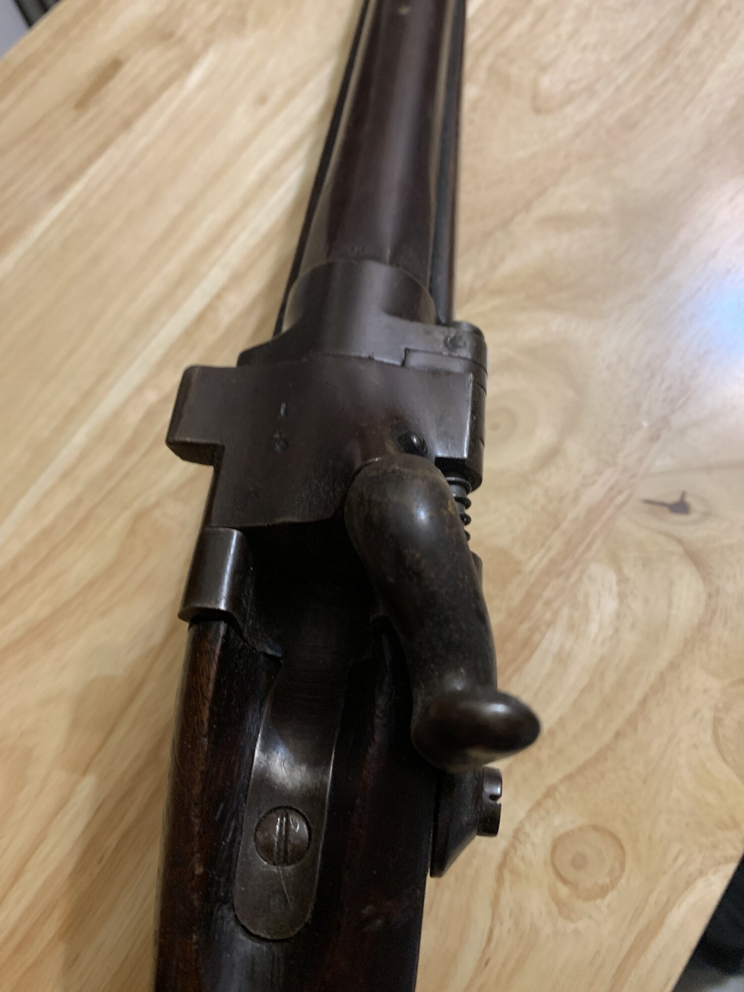

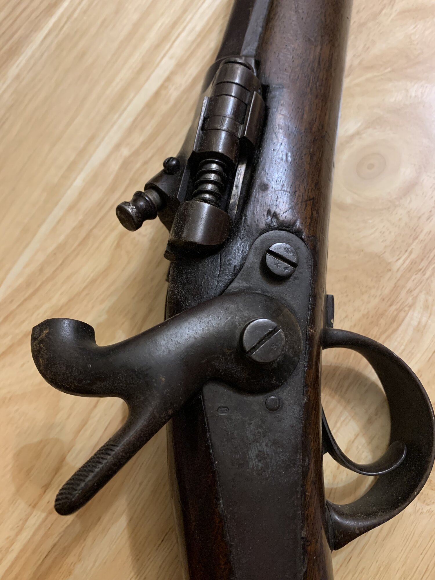

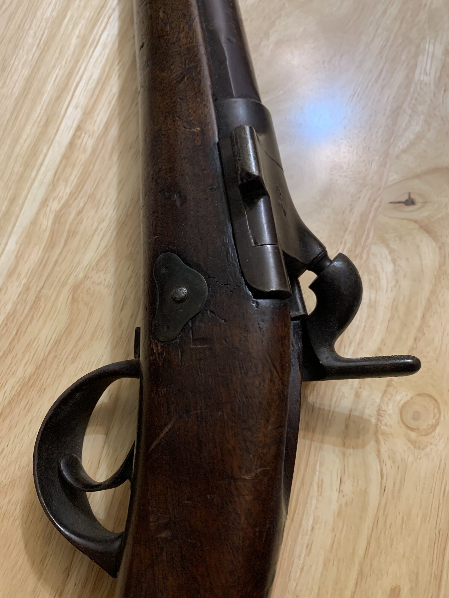

I have heard an interesting explanation of why some of these have brass breach blocks - do you know the truth?
Just noticed this post.
There is a story that the 'brass' (actually bronze) breech blocks were made when Paris was besieged and were cast from church bells as they could not get the iron forgings. The truth is that, following Sedan in the 1870 War, the French National Government was desperate for arms and sought production from smaller manufacturers. Some were too small to have the forging ability to make forged iron breech blocks so they cast them in bronze. Looks pretty, and adequate if not abused, but not as strong as the iron ones and more likely to stretch if overpowered. The same reason was behind the Confederate bronze frames for copy Colt revolvers so beloved of modern Italian reproducers which have the same weakness of stretching with strong loads.

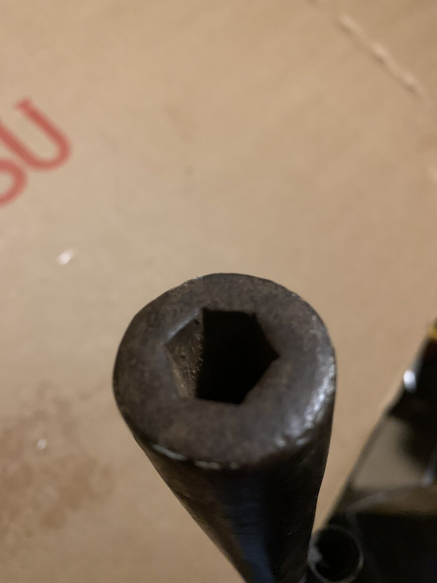

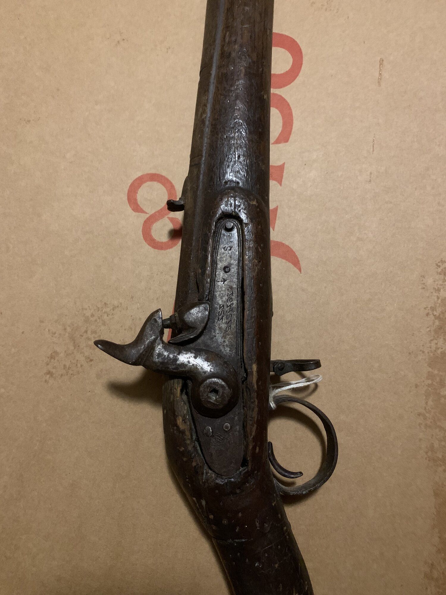

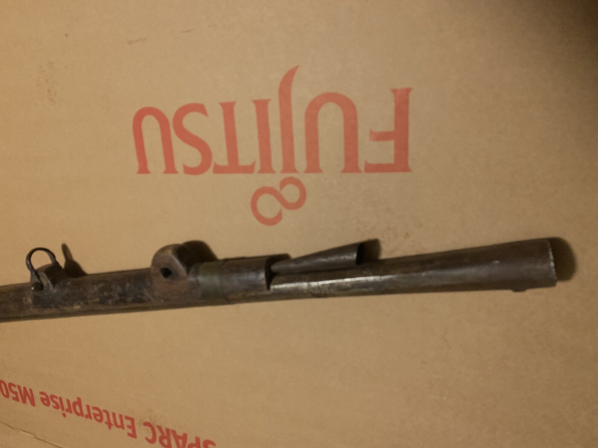

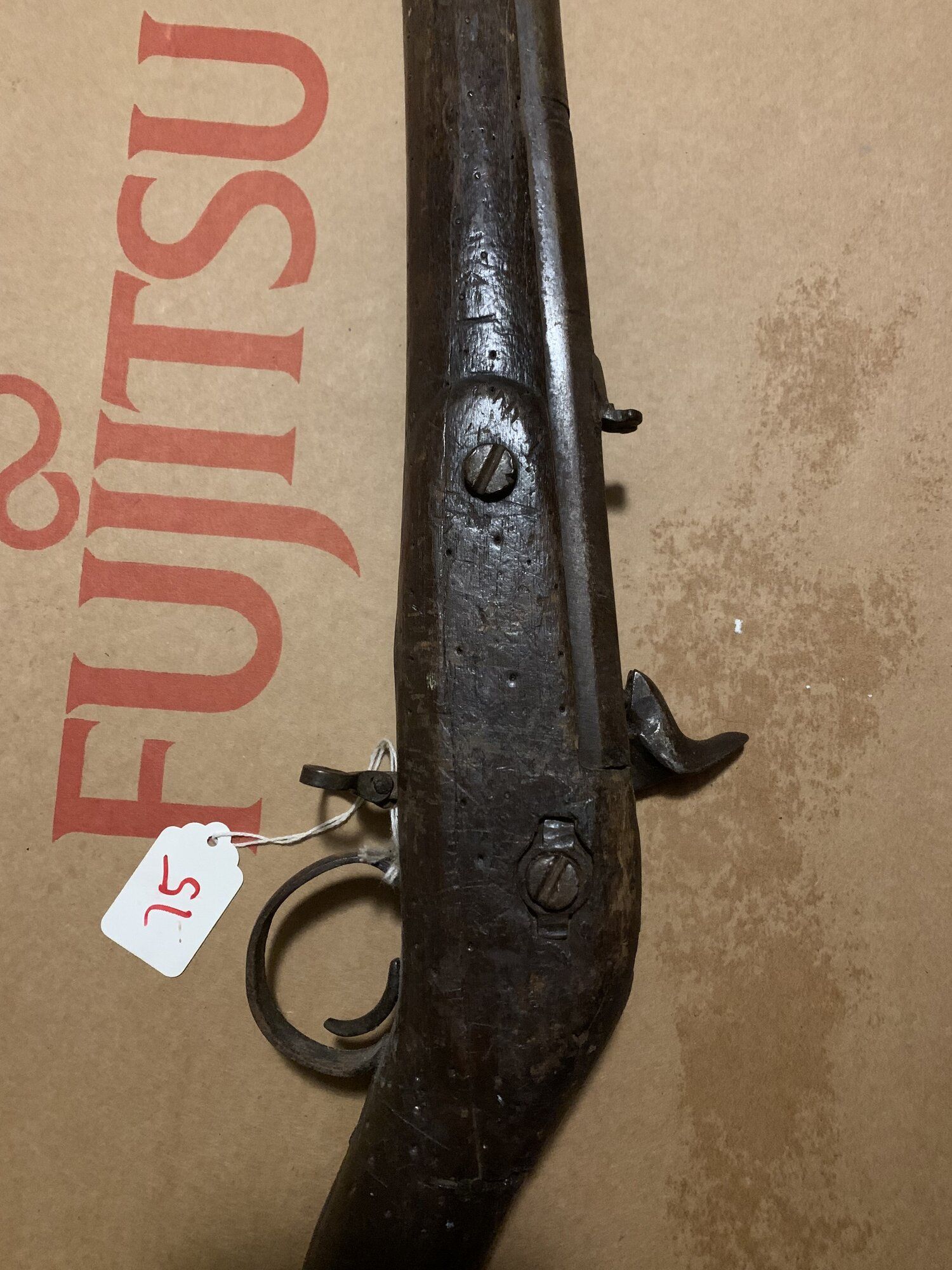

I believe this is a jezail, not positive. It doesn't have a flintlock, but it does appear to have a mount for a bipod and looks to maybe fire hexagonal bullets. It's missing a bunch of tacks and a number of decorative metal bands.
