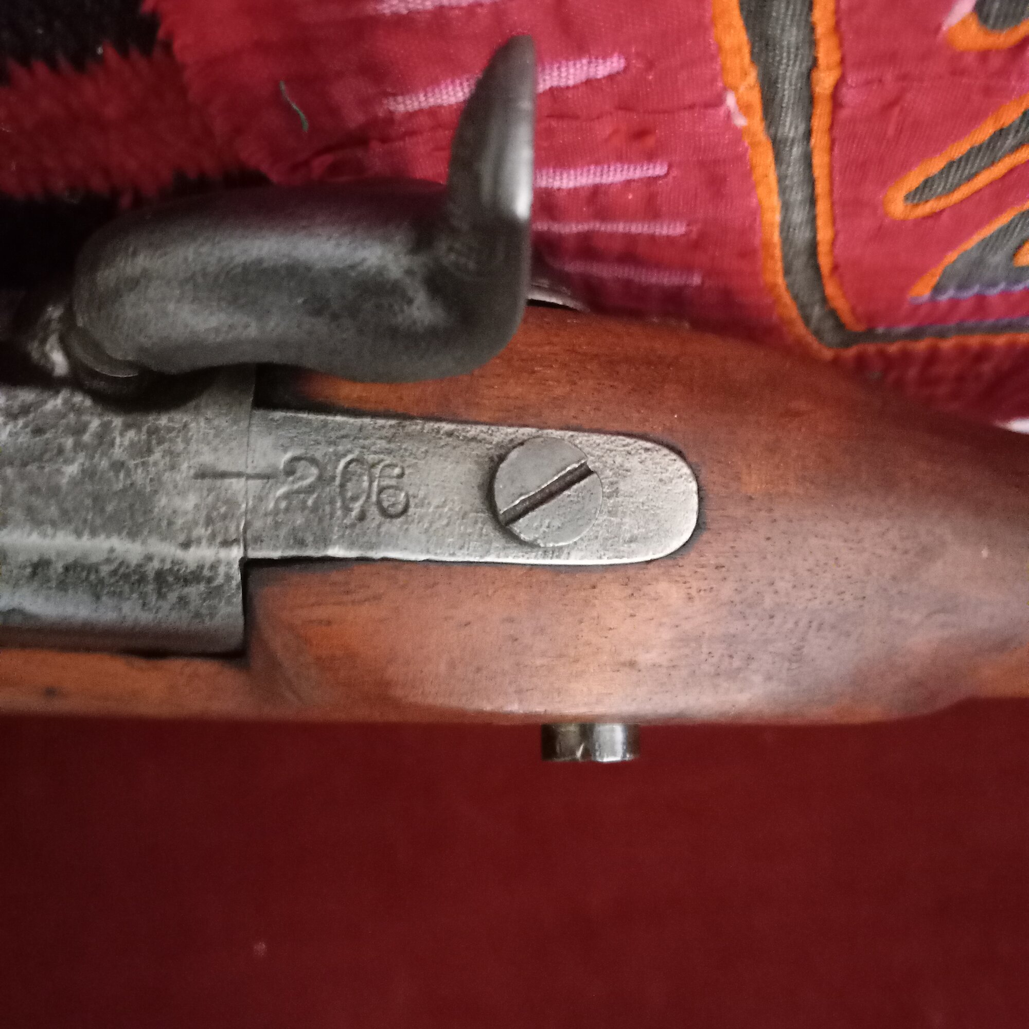

I have an 1862 Tower with no markings that I can see on the butt plate or stock. It does, however have the number 206 stamped on end of the barrel, see photo. Can anyone tell me the origin or purpose of this number?

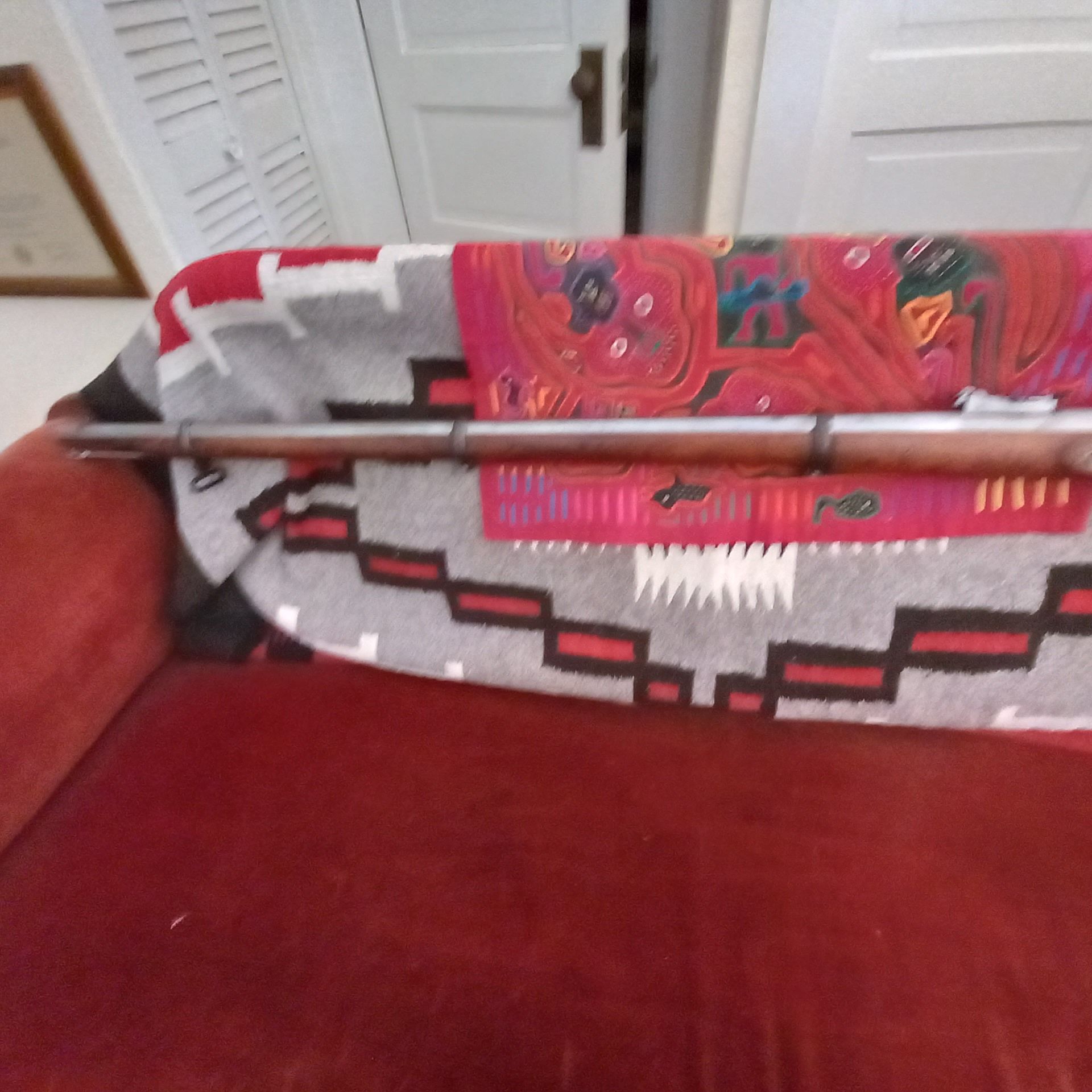

Sorry I meant stamps that could have denoted the stock maker or export stamps that might have given you an idea as to its history. Incised carving will certainly survive cleanings like your stock has had. I can make out an upper see T across from the nipple.
It is a typical civilian P53 - bought in and issued to both sides. The number on the barrel tang is a post-manufacture stamping. It was usually done for a rebuild/overhaul to identify the various parts of the rifle. These civvy P53s were not always 'to pattern' and parts were not always interchangable, hence the need to stamp the main components to ensure they could be reassembled.
A photo of the breech area would show proof marks and which area it originated in. Disassembly could also identify the gunmaker and even the contractors supplying the various components. Stock stamps that often escape are the (Confederate) stamp behind the rear of the trigger guard tang or the (Union) cartouches on the flat opposite the lock. Annother 'goodie' is the occasional stockmaker's stamp inside the ramrod slot!
