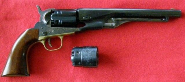

I have an Armi San Marco 1860 Army 4-screw frame cut for shoulder stock, date code BC (1993), S/N E04531. It has both a rebated round engraved cylinder and a rebated full-fluted cylinder.

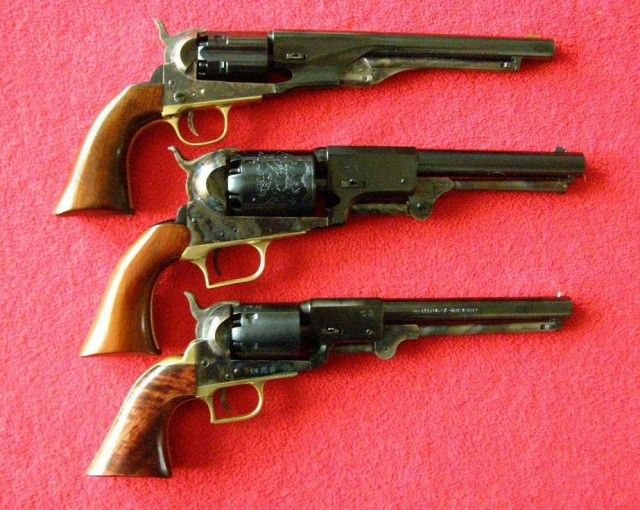

I do not want to hijack this thread, but since the subject of Pietta CC came up, I want to post one more photo insofar as case color guns.
ASM 1860 Army .44
Uberti WH Dragoon .44
Pietta 1851 Navy 2nd Model .36 squareback with part round/part octagon barrel and smooth cylinder (my rendition of what Colt should have produced as a Dragoon .36 belt model pistol, but did not, and Pietta did not do so either as this is a parts gun).
ASM 1860 Army .44
