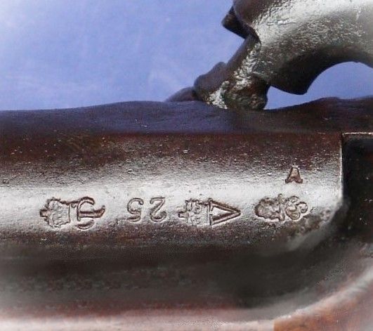

What do these marks indicate?
In the two photos you post, we see on the barrel the standard five marks showing this .577 caliber (25 bore as the Brits would say) barrel was proofed at the Birmingham proof house, and the lock is the standard Birmingham made lock dated 1862.
The screw on the sling swivel is a new replacement with non original domed head and installed from the wrong side. There are still buckets of original sling swivels around, but almost always offered with these new rounded screws. The hammer screw looks as old as the lock, but it has a thicker head - more of a round dome than the originals.
This is a civilian contract rifle - the ones delivered to BOTH sides during the Civil War. These are Birmingham proofs. They are detailed, but too small to see that detail!
The three marks are (from left)

provisional (first) proof (before rifling often straight from the forge);
25(-bore) provisional bore

definitive (final) proof
Some rifles may be seen with 25 24 meaning a barrel that was first bored at .577" but was finished as .58" for Union forces.
The view may be made before rifling or with just rough rifling.

BTW - The screw on the hammer is not the original either

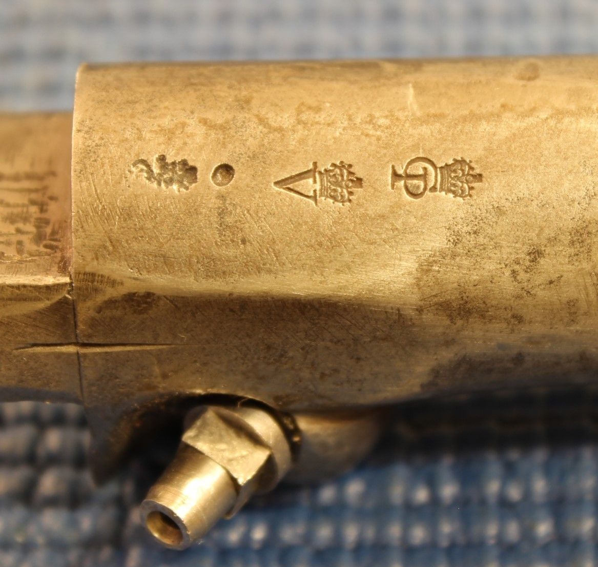

Any chance you have the pics of the London proofs - the ones above are great!

Certainly:
final view (intermediate proof) ;
25(-bore) final view bore VERY RARE

Most do NOT have the bore. The provisional mark will usually be towards the breech plug. There are variations.

Most of the original Confederate contracts will have mostly London Proofs, later ones more likely Birmingham, but both are mixed. LAC rifles (later contracts) will have either a London proof (early) or simply 'LAC' in the positions of the proofs
