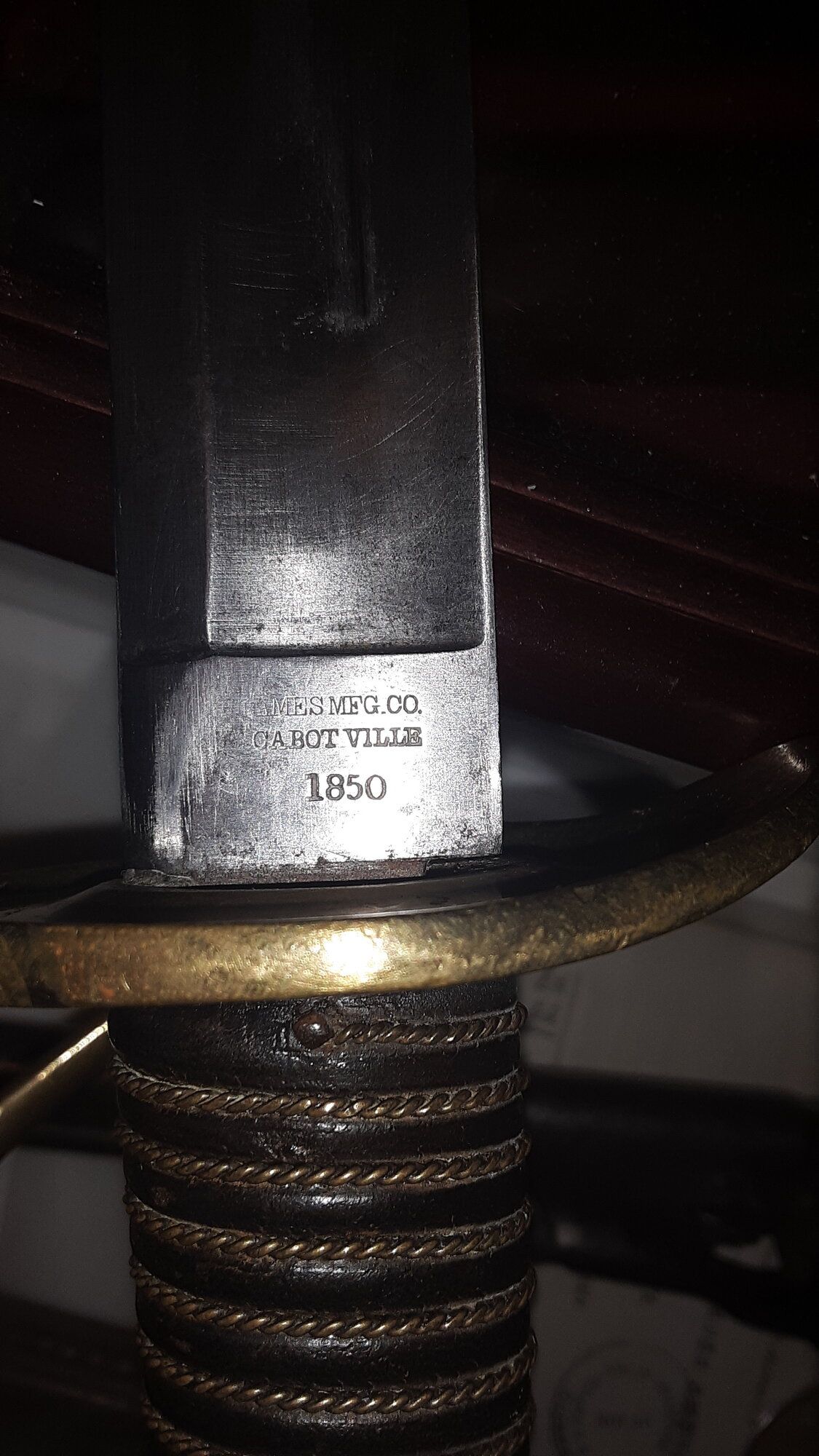

The Ames saber looks legit to me. Someone took one that still had a very nice blade and then buffed/polished blade, hilt, and scabbard. Maybe they thought making it look new would increase the value, maybe they didn't care and just wanted it to be pretty. When I bought my Ames saber (1850 date) over twenty years ago, the same thing had been done to it. I still wanted it due the Massachusetts marking on the hilt showing it may have been used by the 1st Mass. Cavalry Regiment (per Thillmann's book). Only now are the hilt and scabbard getting just a bit of age toning back.

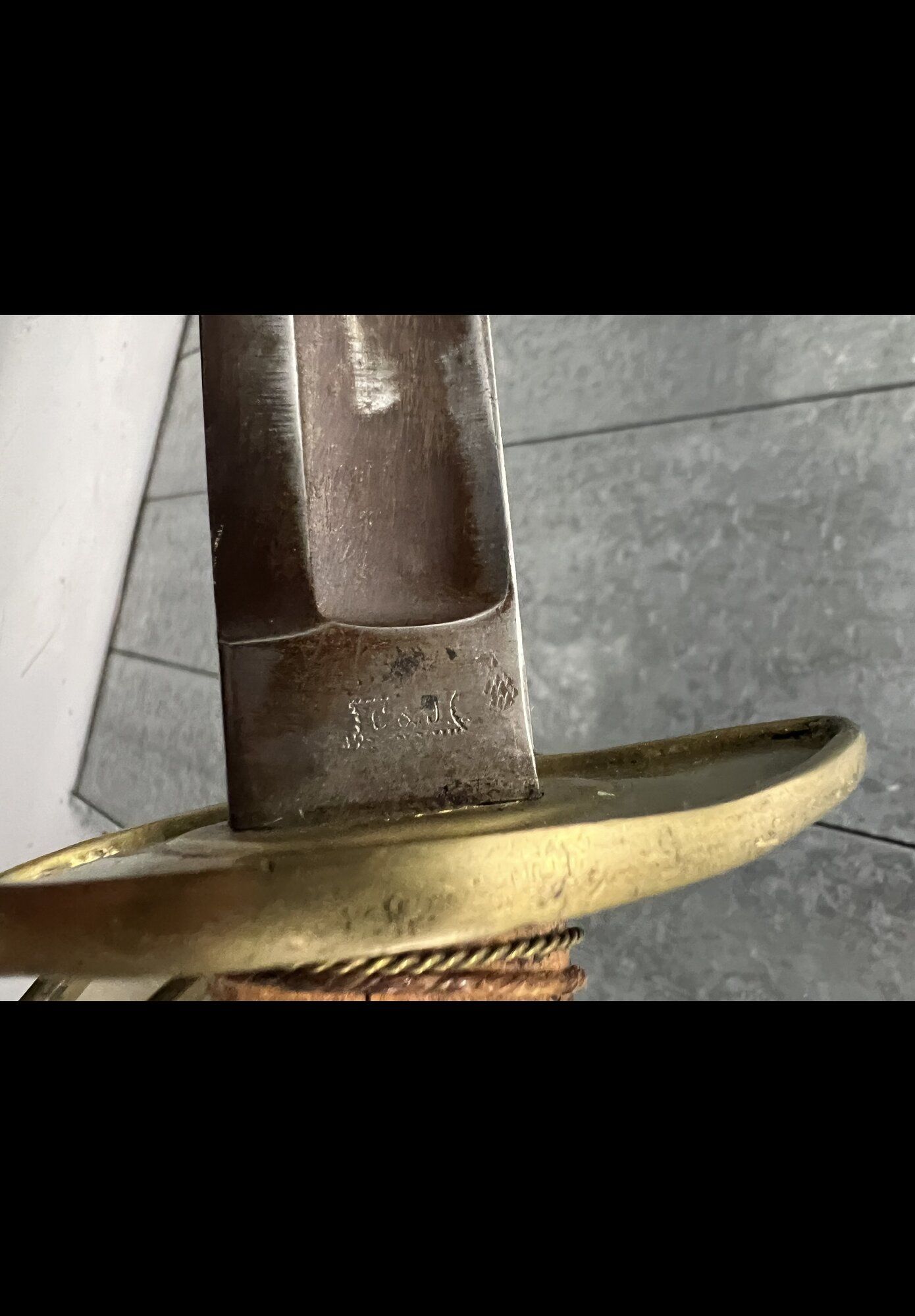

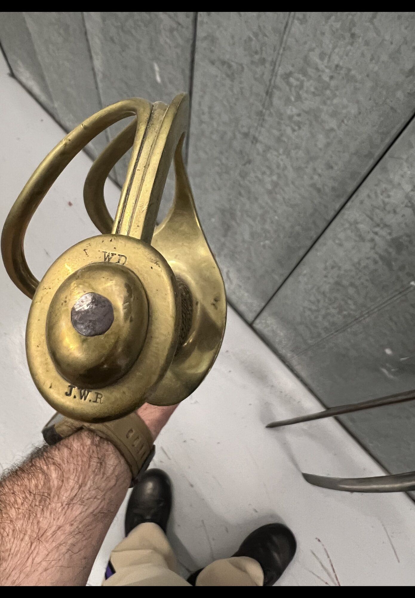

The C&J sword has tool marks on the ricasso (from a vise?) indicating the blade and hilt have been separated at some time. I don't know if the blade and hilt belong together. The three initials look like an inspector's stamp but are in the wrong place for an inspector's stamp on a pommel. I have never heard of an inspector's stamp on a C&J cavalry sword so I suppose it's possible they could be owner's initials. I am separated from my references so I am unable to see if this is a typical C&J hilt or the marriage of a C&J blade to, say, an Ames hilt or if these could be inspector initials. A Frankensword could be a wartime modification or one from later.

Yes, I saw the vice marks too. I'm thinking that somebody used a vice in order to remove the handle for repair? Apparently, if this is true, they didn't use anything between the vice grips to protect the blade.
It's true the 1846 dated sabers (link the one your link goes too) were stamped "N.P. AMES", but in 1847 the stamping changed to "AMES MFG. CO". The saber in question does not appear to be an 1846. While you can't make out the final digit, the small curve you do see looks like it could be from a "9". You can see the stamping on my 1850 dated saber also has the same spacing and letter characteristics, a noticeable one being the "V" and "I" meeting at the top, and the "I" looking like the numeral 1.
I've seen vise marks on a number of other swords both on the blade ricasso and elsewhere. I've also seen other tool marks, usually on the hilt.
Could be Bob could be....but his looks like it was stamped yesterday, his is stamped more to the left and yours to the right (that might not be an issue depending on the tool or the multiple individuals doing the stamping), and again what are those marks going down to the right of the 4 (don't look like vise markings)?
I don't know what caused the marks you mentioned, but it is possible the blade was removed at one time, perhaps for all that buffing. You can see the pommel cap and tang have had some banging done to them. You can see mine is more relatively smooth.
But I have no doubt those Ames markings on the blade and the inspector initials on the pommel cap are done with the correct dies. It just looks like his saber has a very strong stamping and has seen little use. You can see mine is pretty strong on one side but showing more wear at the bottom, I think from going in and out of scabbard. But my saber saw more use, and the blade was period sharpened. The regimental history of the 1st Mass. Cavalry says they "ground their blades as sharp as possible ".
