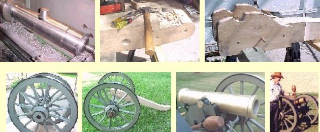

How to Hunt Wisconsin Whitetail Deer with a 12 pound Mountain Howitzer Cannon by Buck Stix
This website is unique. The author built his own 12 pound mountain howitzer. He did comprehensive research that anyone interested in mountain howitzers will find interesting. I don't know of any other website that includes detailed plans & instructions on how to build your own cannon.

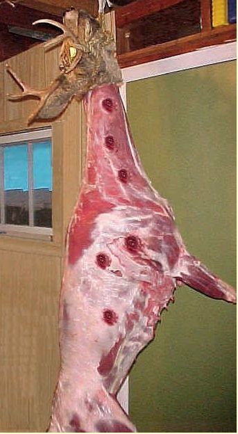

The author uses a nom de plume for good reason. He really did go hunting for whitetail deer with his 12 pound mountain howitzer. It isn't exactly illegal to hunt with a cannon, but why not err on the side of caution?
I will not spoil Buck Stix's ten step instructions for hunting with a mountain howitzer by quoting from it, but it certainly is tempting. The writing is very droll. He scored six hits on his target.
