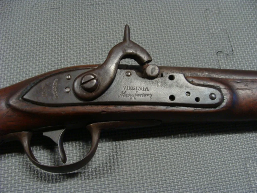

I need to take better photos, but here is the lock of my Virginia Manufactory musket:
Here is what I am reading from Cromwell:
Union Arms alteration: consist of curved bottom bolster / Markings of single numbers usually but not always on the mortise preceded by a U.
S.C. Robinson: 2-faceted bolster with flat bottom . Later has a sliver of brass / Roman numerals
Perpgnon: 3 faceted bolster uses roman numerals on inside of lock pLate
Adams: 3 facted bolster. infrequent use of roman numerals on inside of lock plate.
Looks like yours, from I am reading may have been done by John Barrett of the A.B. Barrett company. Also possible it could have been done by Leman, but those are much more rare.
