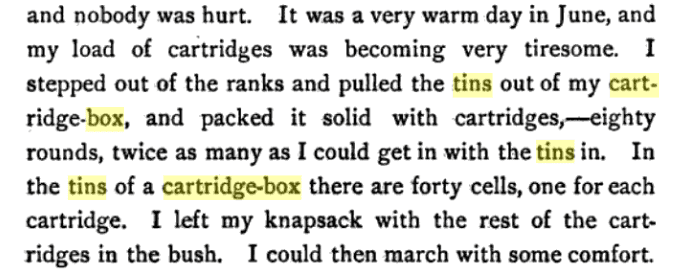

The heavy cartridge box was not infrequently shifted about the person on the march, to reduce the discomfort. From the History of the 115th Illinois:
As you mention, getting at the lower compartments in battle requires the soldier, once the upper trays are empty, to pull the tins to get at the packets underneath. This did not require the soldier to step out of ranks or anything, if they were in ranks while firing.

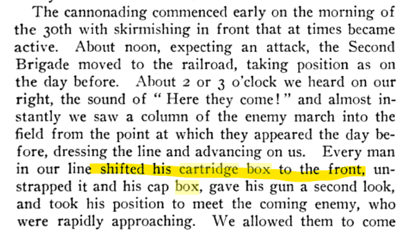

John Worsham of the 21st Virginia mentions shifting cartridge boxes to the front in preparing to open fire..

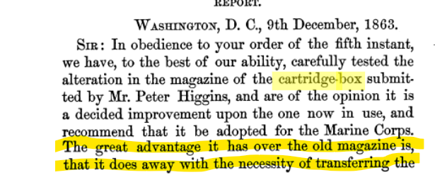

The Marine Corps tested and liked the design:
