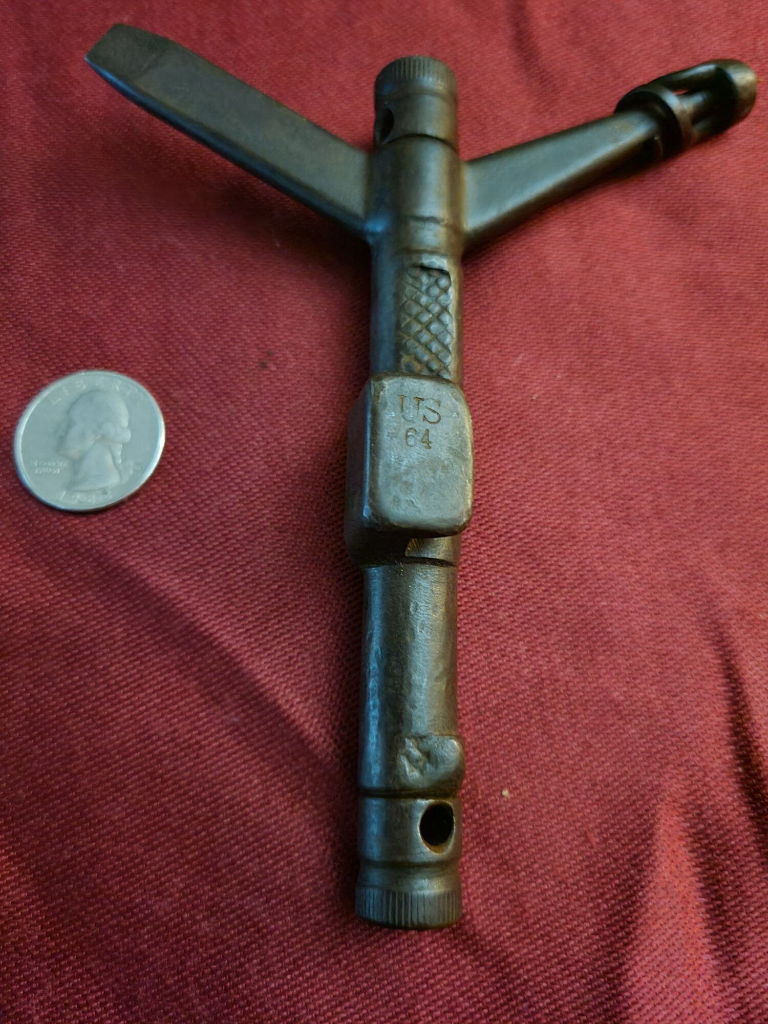

Yep,,,my original post stating US Sergeants tool was in reference to it being carried by Sergeants here in the u.s. Would you know the purpose of the cross hatched area? Was is for grip when cold or wet? Or some sort of file? It seems to be in an awkward, useless spot if it was for grip

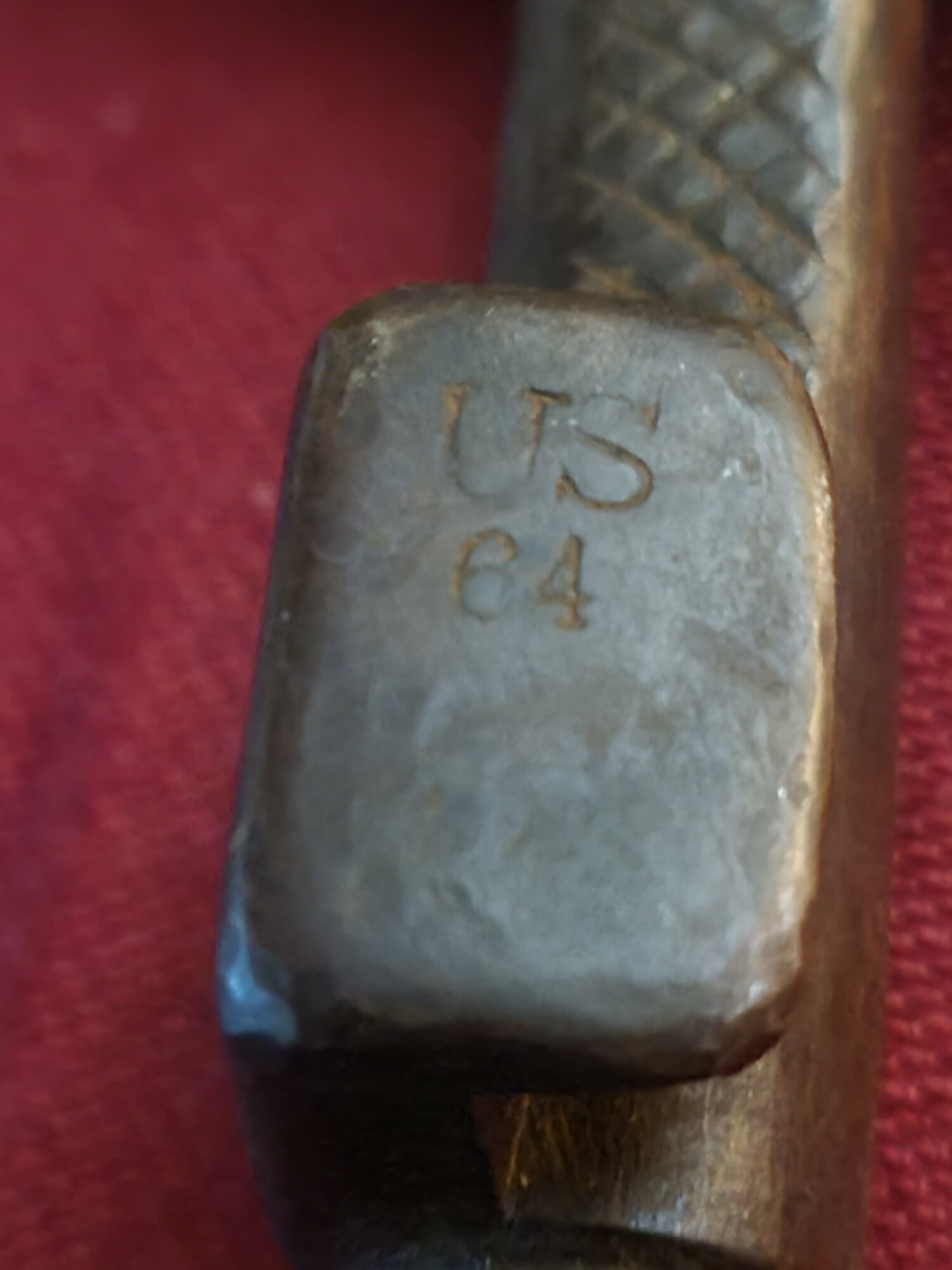

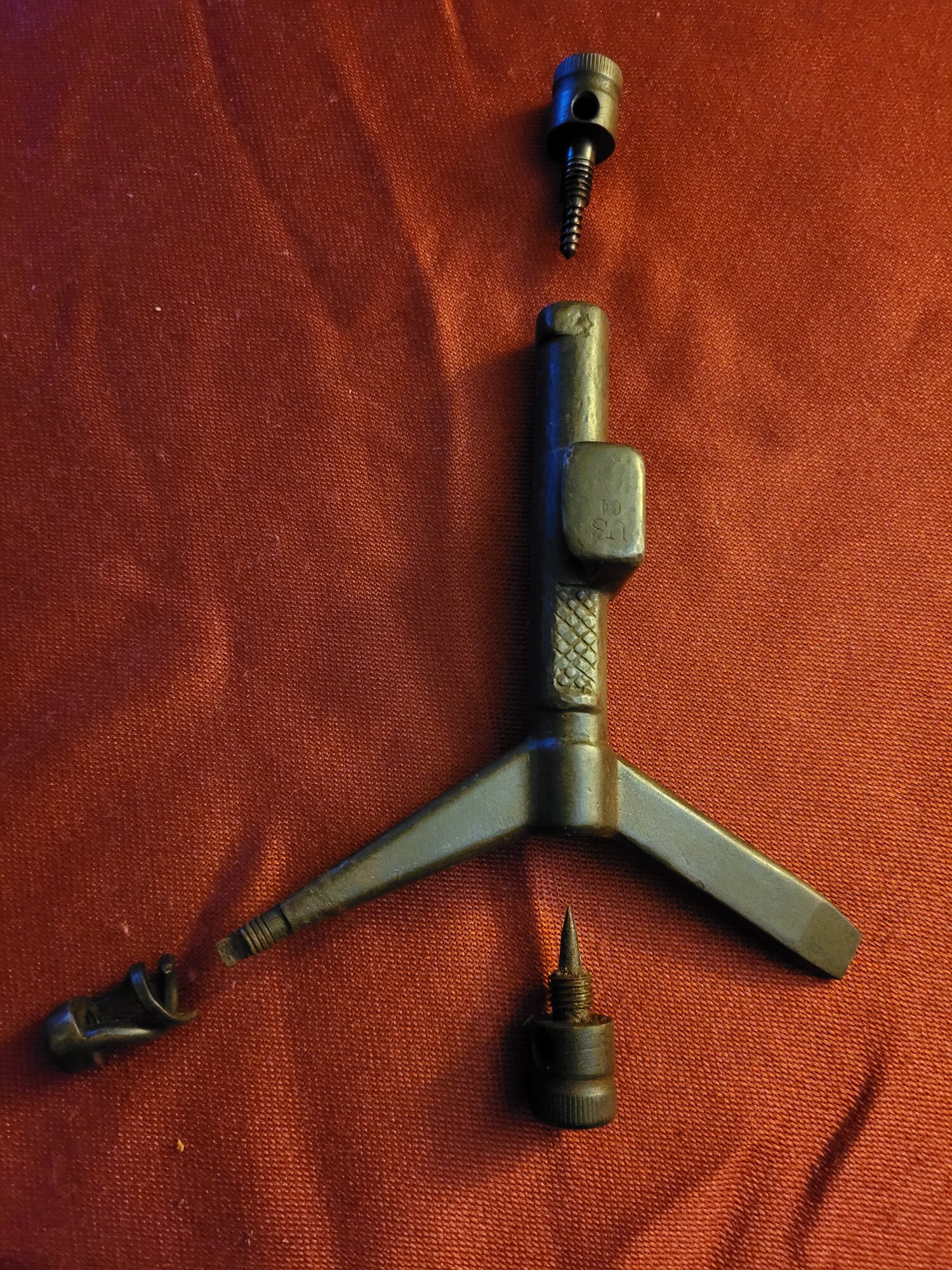

actually the first I've seen marked US. Nice piece, my own of that model is likely made in India post ACW, it came out of Afghanistan in the early 2000's. The worm & ball puller are too small to fit the original P53 ramrods I've tried them on but fit the Martini cleaning rod. A mystery.
Most checkered parts like that were made for removing deposits, however. this used to grip the spring as part of a non adjustable mainspring cramp or clamp to remove the mainspring from the lock (done with the hammer at full-cock). Yours is a No3 the illustration below is a No1 (that 'block' is actually a 'hook')
