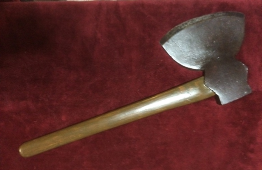

A broad axe is a vital tool when building structure; it is the tool that turns round logs into square beams. All a man needs is a chalk line, square, felling axe and broad axe to turn a good heavy log into a good heavy beam. A broad axe may look like a fearsome weapon but the reality is that it is too heavy and cumbersome to be an effective weapon; but it is a splendid tool.
There are a variety of broad axe styles from the gull wing common on the continent to the "Pennsylvania" style to this "American style identified by the wings that hug the haft giving it better balance. I really cannot say where I acquired this broad axe; but it has given me good service.

Nice one. I have seen some with an offset blade, what they called and used for?
The offset is so the user can stand over the middle of the log, and then aim their strokes to one side or the other as they flatten the side of the log. If I want to flatten the right side of the log, I want an axe with a bent handle so that as I swing straight down, the axe will strike a few inches to the side but my hands and stroke will still be centered.
