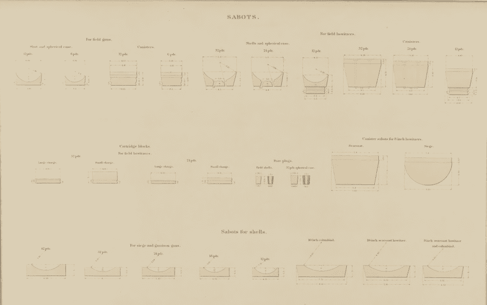

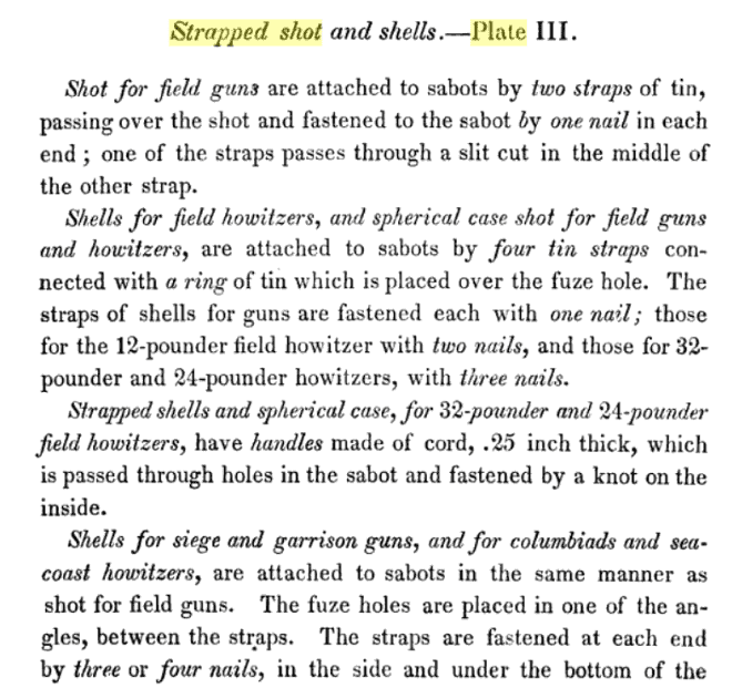

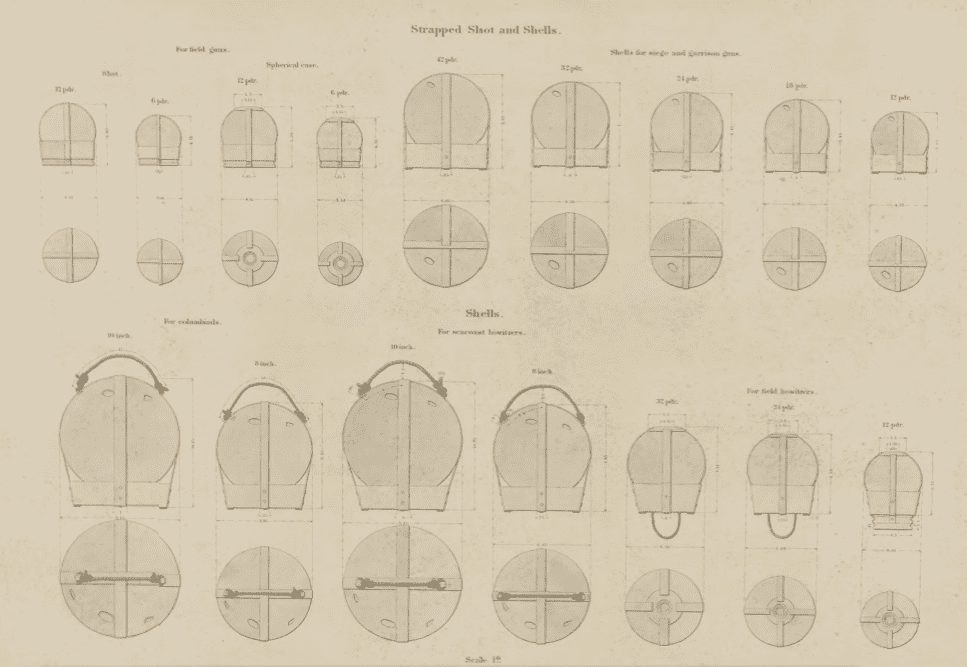

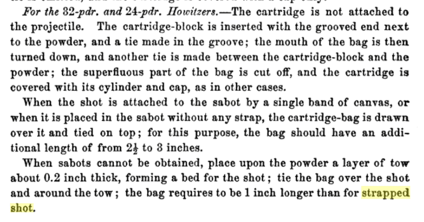

From the US Ordnance officers manual, 1862.
Here's an 1849 description of Strapped Shot...
