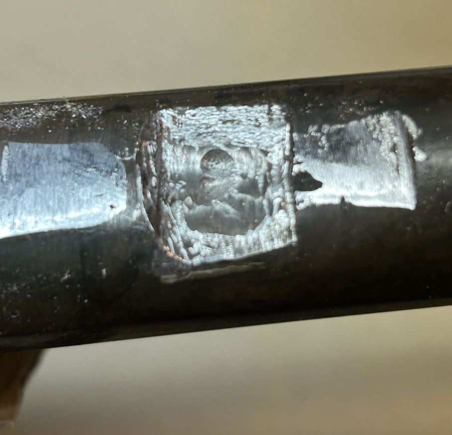

Thanks for the replies. I have the rifle now, and you can see what my task is from the photo. So from looking at it closely and looking at lots of Spencer photos online, I think that while the rear sight is mortised, the spring is not, rather it held downward by its own tension between the sight ladder and the barrel, and "stopped" by the ends of the flat areas. That would let it move slightly when the ladder is flipped. I couldn't understand how both ends of the spring could be mortised in place and still allow it to flex. Is this correct?

Jeff, the sight project is finished. Not perfect, but my eyes and hands don't work as finely as they did years ago, I now swap three different magifications of glasses just to do something like this, lol.
Attached are a few photos of the process. First, studied and planned until I understood exactly what I intended to do (again, thanks to Old Sarge and Conquerordie).
I filed the flat areas for the spring. decided to leave a few previous barrel dings rather than chase after perfection. Then I welded in the damaged mortise and filed a new mortise. Coloring back to match well enough was the most difficult and time consuming task. Anyway. my friend's Spencer now has a working sight. I used to quietly do a lot of work for several collectors, almost exclusively on Confederate guns and swords.
