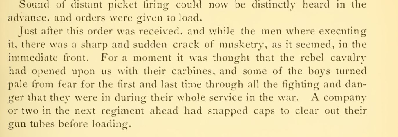

I always thought snapping caps was a reenactorism used to check muskets before loading and after use in the field to make sure they are clear. Apparently, they did it back in the day too. From the regimental history of the 12th New Hampshire during the march to Chancellorsville:

Excellent find!
