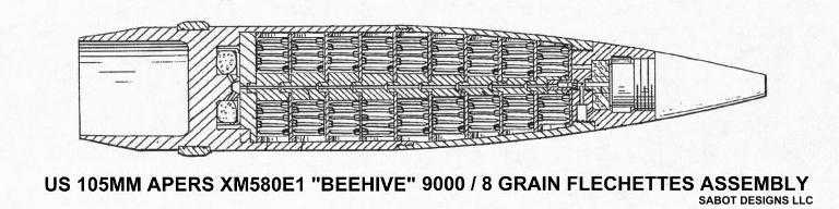

The solid shot was used against enemy gun batteries as they could aim low and skip it into the guns. As @redbob stated the canister was very effective against oncoming troops, its the predecessor of the flechette artillery round that is in current use.
