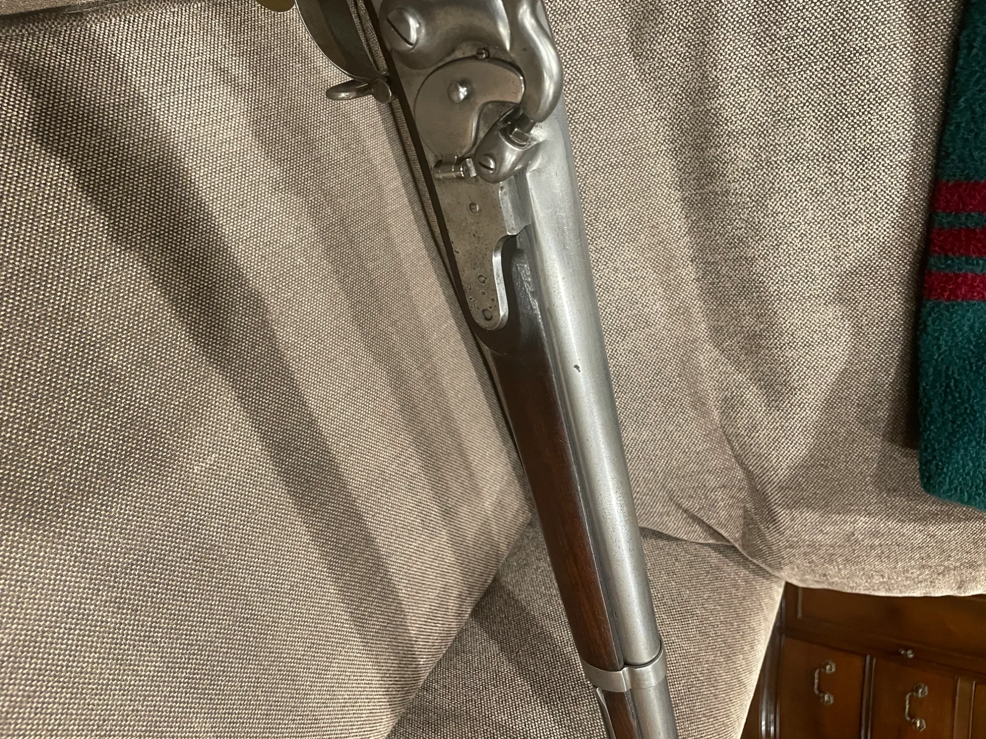

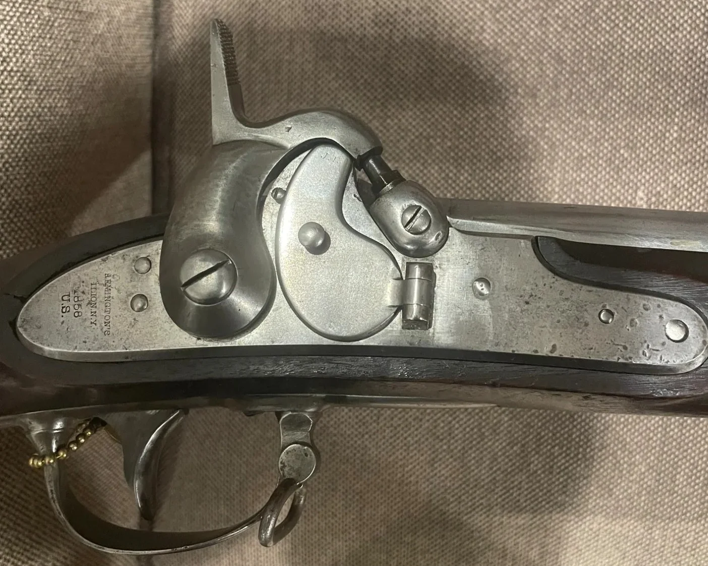

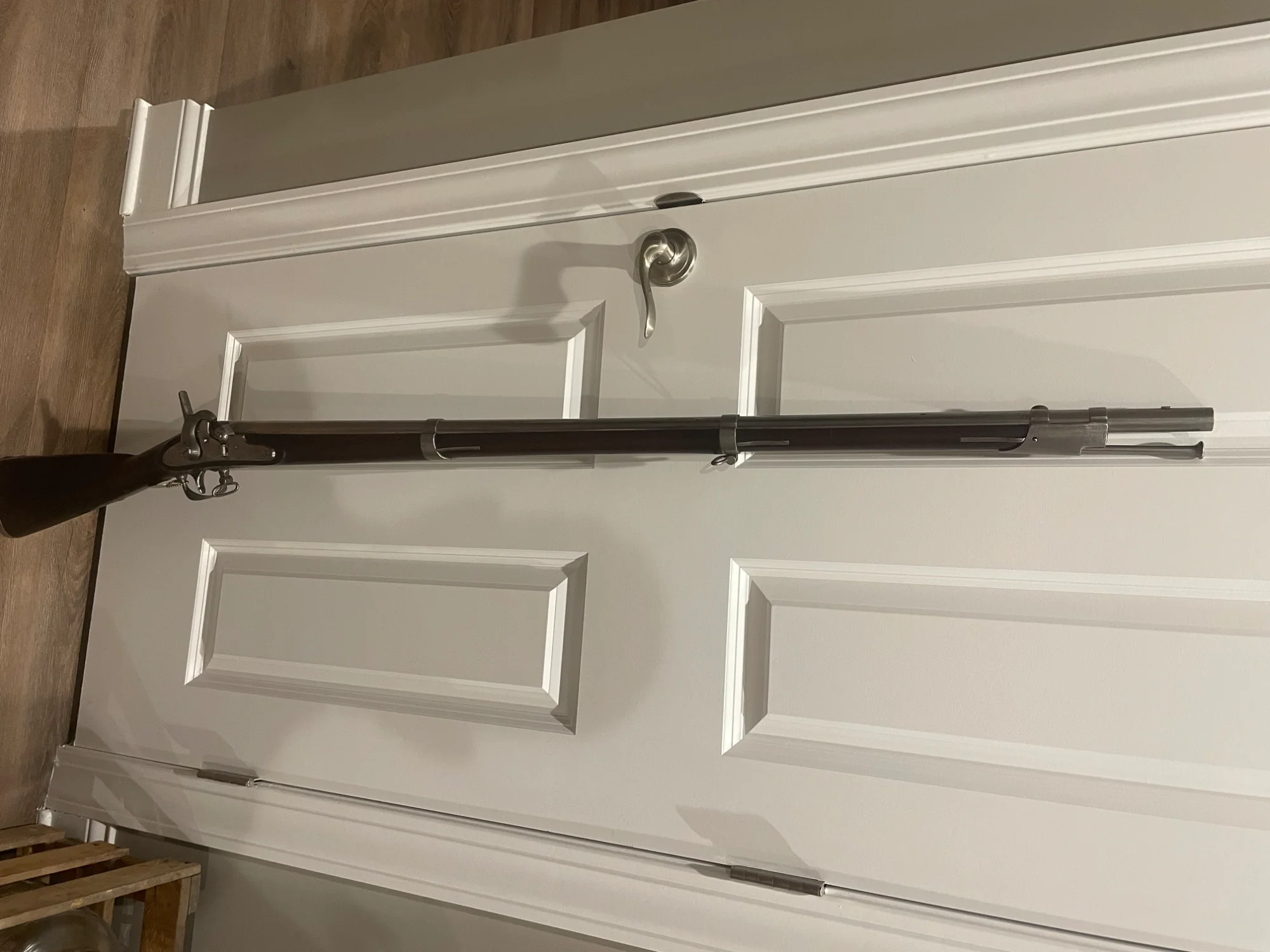

Arrived today. Was described as a smoothbore, but after examination the bore is rifled. The riflings are shallow. There is no rear sight. Most of the ones I've seen have rear sights. How common are the unsighted rifled muskets?

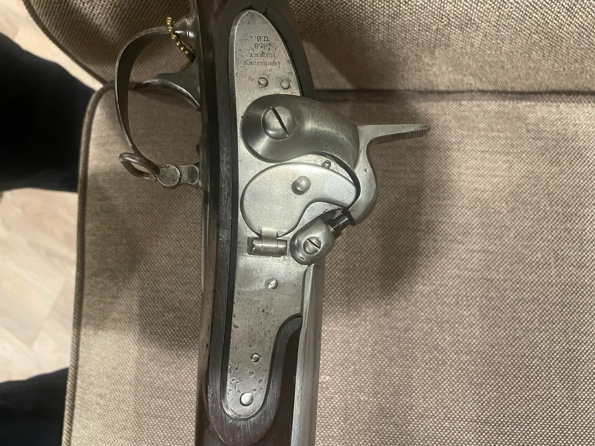

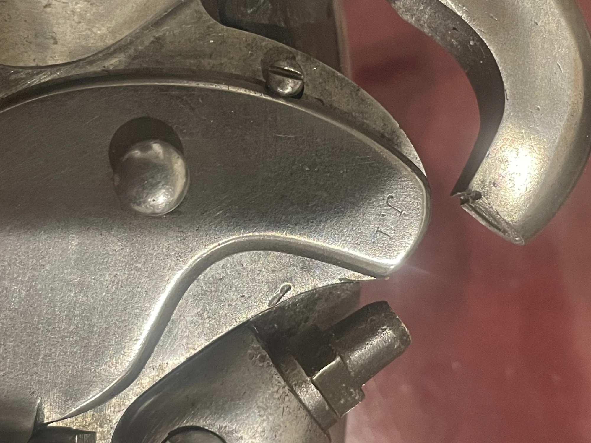

It is a Remington conversion of a M1822 musket (defined by the lower sling swivel on the triggerguard) done in 1858 with a plate incorporating a Maynard percussion tape like a M1855 Rifle Musket:

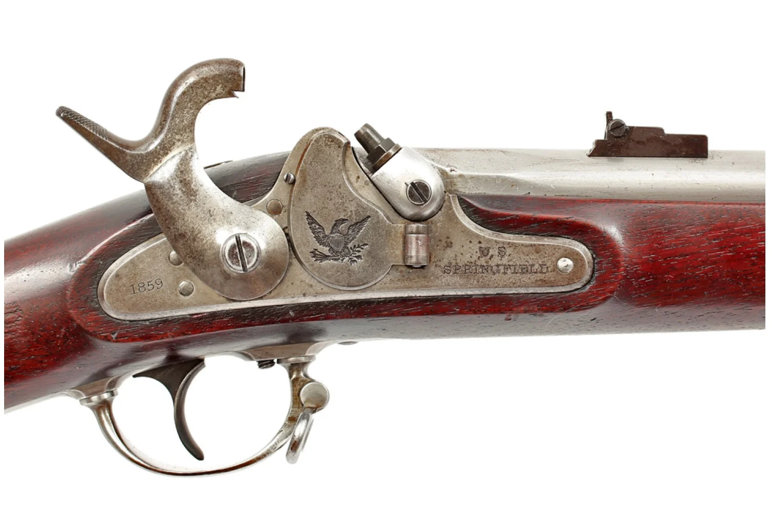

Springfield M1855 lock.
Your lock
The give-away is the long plate in front of the nipple. Some of these conversions were rifled, but I would have though some sort of backsight would have been attached too. It will have the brass backplate on the opposite side of the lock - not the brass screw seats for the M1855/P53.

Several threads on this site including:
Here's a link to College Hill Arsenal write up if a similar rifled, but no rear sight added.

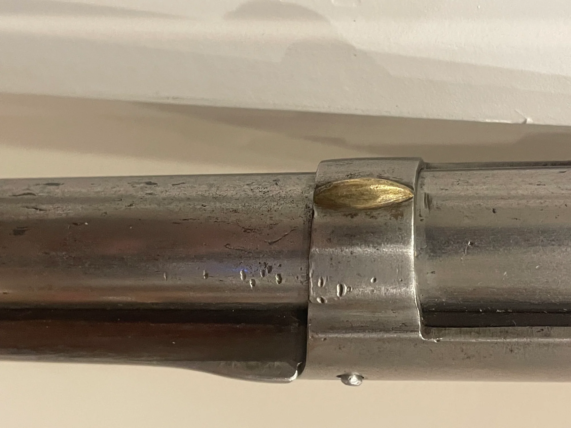

Interesting, it has the front barrel band with the improved front sight that was found on the conversions with the rear sight. Yours has the traditional M1816/1822 front band. Maybe they all didn't receive the new barrel band during the conversion? Looks to be a nice musket. Congrats.

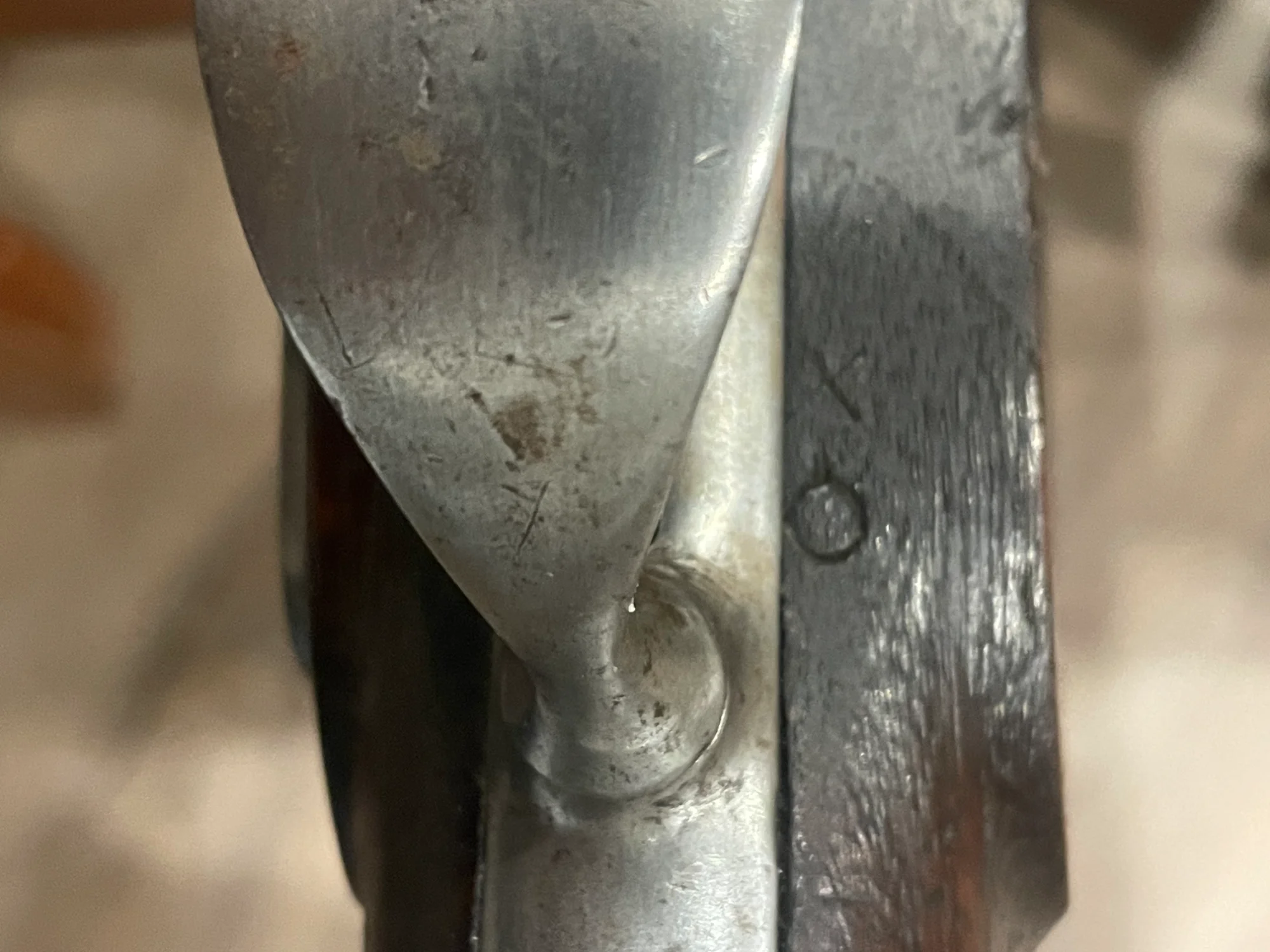

To aim something like this, you line the front sight up with the tang screw. It's not exact but it's like a shotgun with a bead sight.
I have an old British private purchase yeomanry carbine - smoothbore (IOW - not issue or to Pattern). It has a foresight, but I notice when I line it up with the tang screw it is well off to the right. Someone knew at some time. (NO. It is not a shooter!)

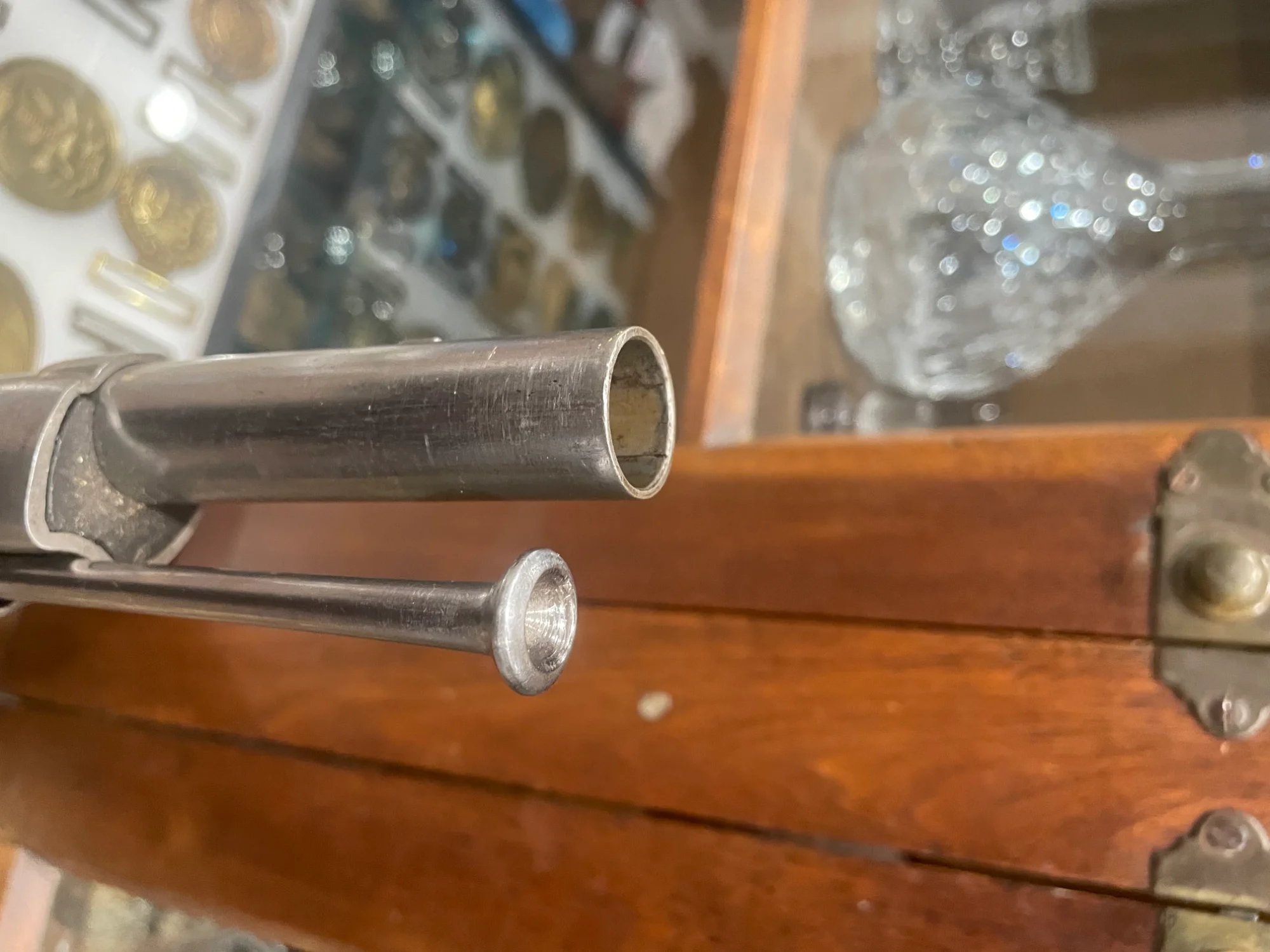

I believe it's the standard M1816 bayonet. The conversion work was on the breech, lock, front barrel band, bore, and rear sight. I haven't read that the muzzle was altered in anyway to change the bayonet to be used.
The Horse Soldier has a bayonet for the Remington Maynard Altered musket for sale. It matches the beautiful condition of the one you have. Check it out.
