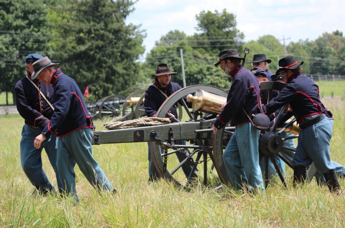

In this image taken during a battery program at Stones River N.B. the living history crew are moving the gun by hand.
The gun crewmen are in the positions set out in the drill book for moving the gun by hand.
One & two are pushing on the axel box; 3 & four are pushing on the wheel spokes & the gunner & number 5 are on the trail.
The rope stowed on the trail is the prolonge.
Not visible is the 'T' shaped toggle that allows the prolonge to be attached to the lunette (circular hitch) on the trail.
On the other end of the prolonge is a loop of metal that could be attached to the limber.

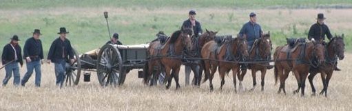

The loop on the prolonge would have been hitched to the limber just like the caisson pole in this image.
The six pounder is limbered in this image of Eli Lilly's team & Stones River living historians.
However, it is easy to imagine how the prolonge would have allowed the gun crew to serve the piece & march alongside as it moved.
The 'T' toggle prolonge end could be hitched to the gun trail lunette & the ring end to the limber. The gun could be fired without endangering the horses with the recoil. In that fashion, the gun could withdraw by prolonge, firing as it is moved to a new position in the rear.
The prolonge was also very useful when moving the gun while limbered. It was not uncommon for guns to be mired up to the hubs in the bottomless mud of unpaved roads. The prolonge could be hitched to the limber pole & men could pull on it to assist the horses. As you might imagine, a heavy length of line with toggles on each end was very useful in all manner of situations.
