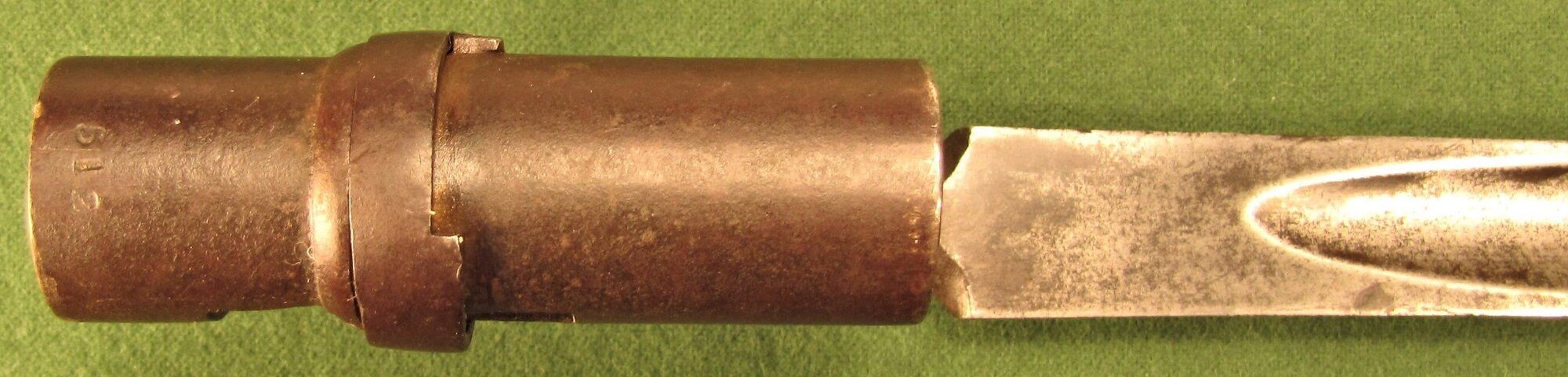

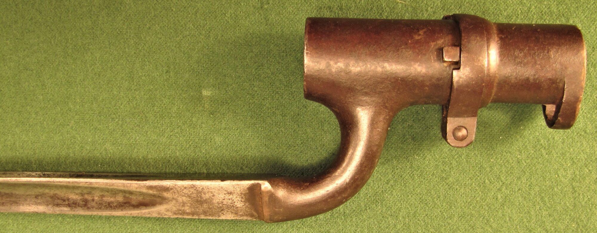

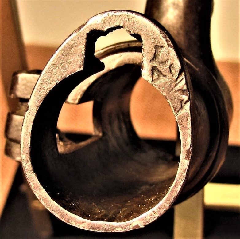

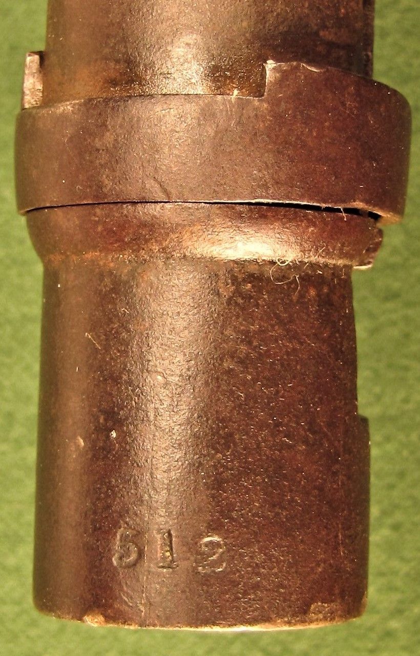

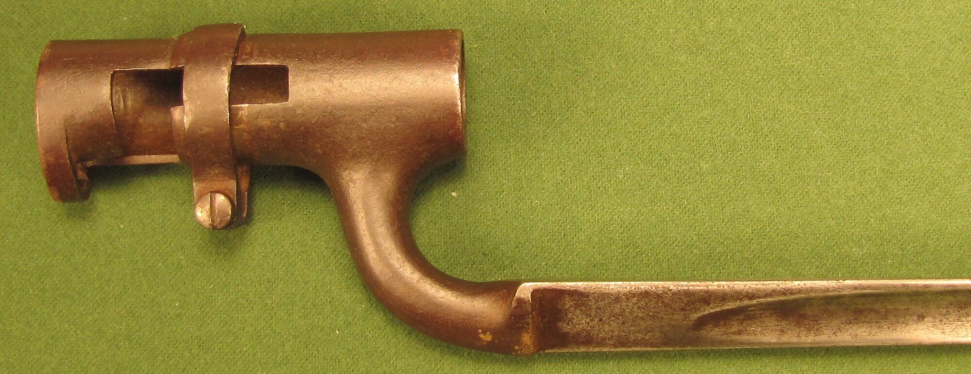

Several years ago, I successfully bid on a bayonet listed simply as "Confederate bayonet." If you have a copy of The English Connection, turn to page 197 which shows a bayonet with a set of tiny numbers (1131) stamped on the rear of the top surface. It was identified with a P53 Louisiana Enfield rifle with tiny numbers (1162) stamped on the heel of the butt plate and which is further identified by stamped Louisiana markings (a hexagram with a block letter "L") stamped twice on the belly of the stock.
Quoting the book "The meaning of these numerals is unknown, but it may be that a number of the Louisiana arms purchased were part of a separate contract that called for the numbering of the weapons. No other arm, central government or state, has been seen marked in this specific manner."
The number on my bayonet is 512 (about 7/64" high) and has a distinctive "1"stamped exactly like the bayonet on page 197 and is of the same small size. I sent detailed photos of the bayonet to Paul Johnson who identified it as a Confederate made copy of an Enfield bayonet. Johnson wrote a series of major articles on Confederate bayonets for North South Trader's Civil War starting in 2013. This bayonet was not made in England.
The photos show distinctive features of Confederate manufacture: the face and side fullers on the blade are off center; the mortise through the bridge for the sight is off center and hand filed to fit a particular rifle's front sight; the screw is off center; and there are rough edges on the blade about 6" from the end. In addition, the rear surface has a capitol letter "L" and "A" stamped into it along with several filed lines. The muzzle bore is .772." The blade is .820"wide at the rear. The socket length is 3.02." Muzzle to stud length is 1.20." Overall length is 20 7/8." Johnson listed two possible makers: Bayne, Stebbins & Co., and S.S. Arnold'

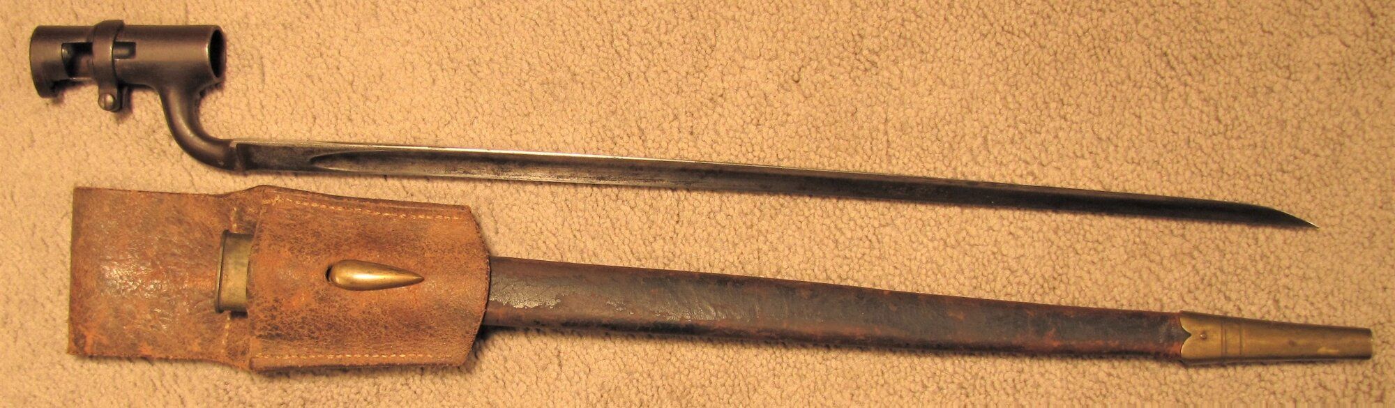

I should have added that the scabbard is definitely an English import and not made by the Confederacy, but the leather frog is hand made.
The scabbard and tip screams Enfield as I have dug many of them back in the Good Old Days.
Wow! That's an amazing piece and a great story! Did the Confederacy import extra scabbards - like empty ones? Or do you think the scabbard was matched up to the bayonet later just so it would have one? Do you think the frog is original? Or do you think someone made it much later? Just so there would be one to go with it? Could you show a photo of the frog front and back? without the scabbard in it?
I believe the scabbards usually came as an acoutrament set not with the bayonet and gun. The scabbard, cartridge box, cap box, and waist belt came together.
Ahhh. That makes sense. The only regimental requisitions I have studied enough to discuss intelligently are the ones for my regiment. Many of the companies received 2 band short Enfields (P60 or P56) and had to requisition the equivalent number of sabre bayonets to go with the rifles. The requisition forms specifically list frogs but not scabbards --- so I just assumed the scabbards came with the sabre bayonets. Maybe that was just the 2 bands and sabre bayonets?
