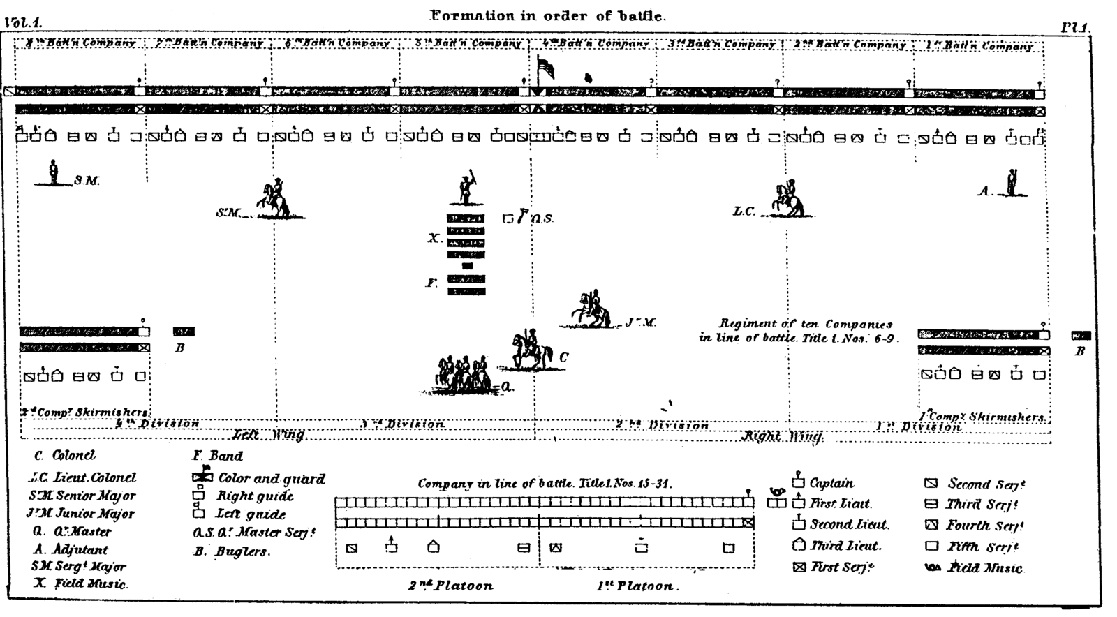

Yes he would. He would have been on the right side of the second line of his company's formation, directly behind his captain who was positioned on the right side of the front line. I've attached a copy (see link: http://michaelchardy.blogspot.com/2018/02/who-shot-jackson.html) of a sketch taken from Hardee's Tactics showing a regiment and company (at bottom) in battle formation.
