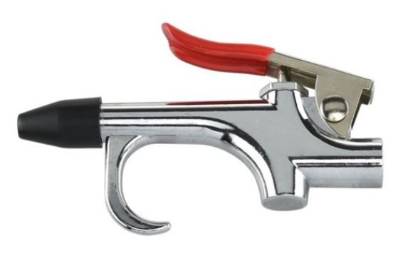

For some reason, I began to have a fear that I would get a ball stuck in one of my replica firearms. I bought 2 sizes of threaded pullers but I still wasn't convinced these would do the job.
Then I decided to switch to the idea of blowing it out with my Air Compressor. I bought this pistol grip for $4.00 and tested it on a few "stuck balls" simulations.
Try it. It won't cost you too much money. Just be careful with this.

Warning, do not attempt to use compressed air to extract a bulllet. The vent may actually be blocked by the bullet if there was a light load / no powder. In any case, the tiny diameter of the hole won't let enough pressure to build up & expel the ball. What will happen is that the valve will recoil back into your face. Teeth, eyes & other very expensive things to fix can get slammed.
If you really can't remove the ball, it is a job for a gunsmith who knows what he is doing. Unless you have run a shop, it is hard to comprehend how dangerous compressed air can be. Goofing around with a spray nozzle like the one pictured, one of my dad's employees accidentally killed a man.
