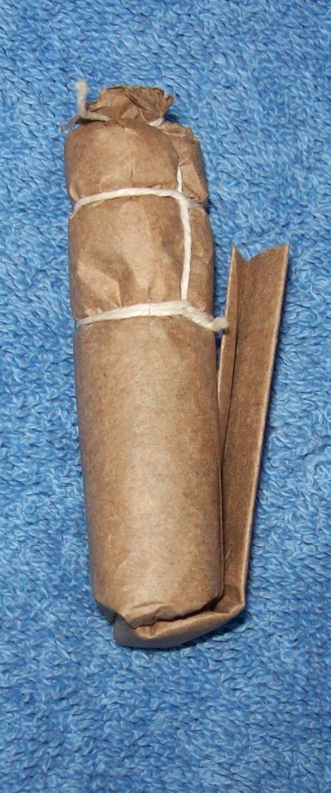

.69 smoothy for N-SSA competition...ah man, you need to load/shoot that weapon like THEY did originally!
Kevin Dally

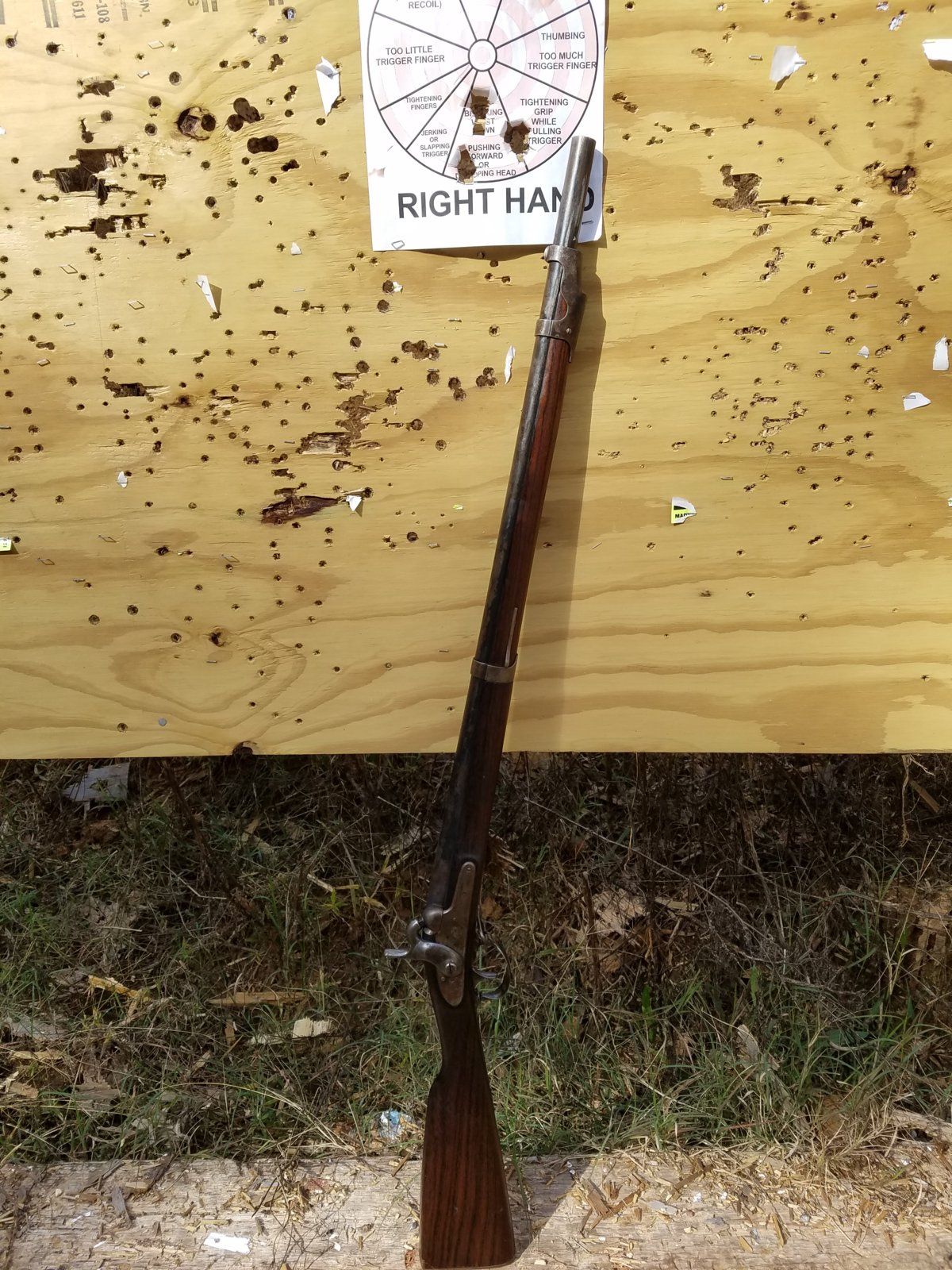

I shoot NSSA and shoot an 1842 Macon (Confed cut down Springfield).
My load- 65g 3f Old Eynsford, ball as cast with sprue removed dipped in musket lube, RWS caps. Very accurate at 25yds and yes, it does kick. I've tried a number of load combinations in this gun and so far, that's what's worked best. Others rough the ball, dimple the ball, voodoo lubes, you name it. I'm convinced smoothbores take black magic, mystic incantations, and dumb luck to shoot accurately.:roflmao:
5 shots off hand, 25yds. 3 in one hole.
