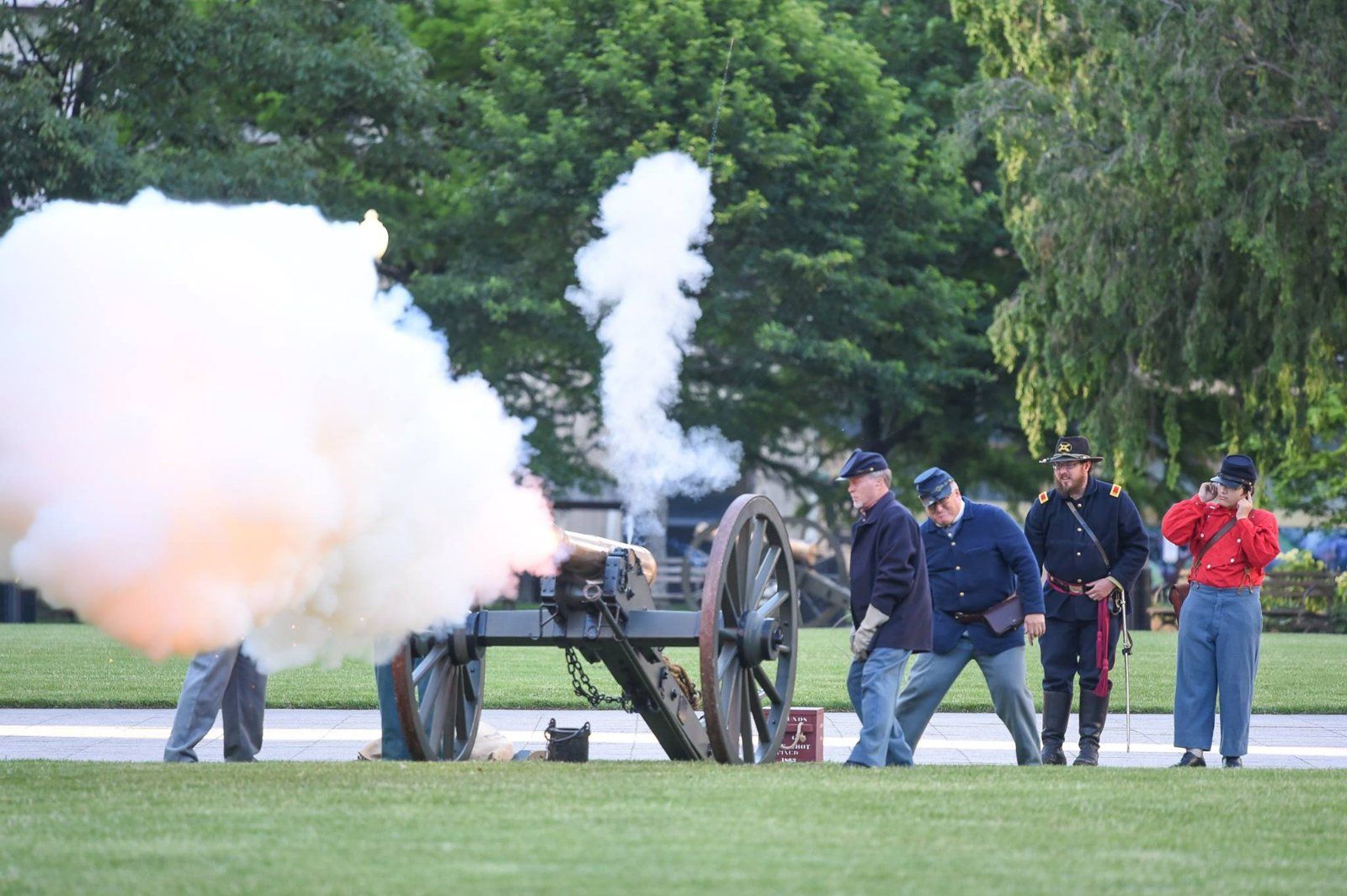

Primer just after pulling the lanyard
drezac
May 4, 2014
Baltimore,Ohio
This is a photo of one of the Ohio Statehouse guns being fired by our battery. Look at the smoke from the vent, you can see a thin smoke trail and the primer taking off like a bottle rocket

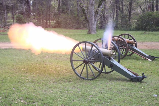

I got a similar shot with flames this past weekend, but I didn't catch the primer.
That's a nice one. I always love seeing when they are taken at just the right moment. The first one below is a 3 inch field gun from Croft's Battery and the second is my "Lost Cause" Howitzer.
Update: just found out who took this photo. Photograph was by Mike Elicson, and was posted on his Facebook page. Photo was forwarded to me by a fellow battery member
