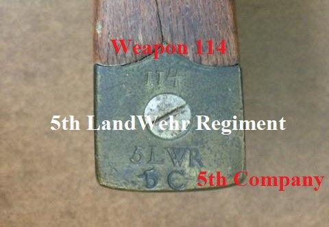

Butt markings. 5th Landwehr Regiment has traditionally been Westphalia / West Prussia.
The Prussian Landwehr was first formed by a royal edict of 17 March 1813, which called up all men capable of bearing arms between the ages of eighteen and forty-five, and not serving in the regular army, for the defense of the country.
I think the answer to the use of the M-1809 Musket, aka "Potsdam", by the LW units lies in the butt plate markings. The unit markings are not secondary markings. In the over half century of studying existing examples I would hazard a guess that I have seen literally hundreds upon hundreds of Potsdam muskets. I have never seen one with secondary issue markings. What I have seen is that a majority of LW issued muskets are stocked in coarse grained Beech wood. The King's Regiment muskets are stocked in a wood resembling Straight Grained Maple. Asking for primary documentation from a part of the World that was essentially burned to the ground some 75 years ago is a nearly impossible request.

This musket is marked for LW use, aka Prussian Militia so that eliminates Naval use in Prussia, much less that it isn't a Naval model musket. The United States would have never used one of these arms ship board. The Confederate States never imported them. All plating, tinning, or chroming, is post war civilian modification.
