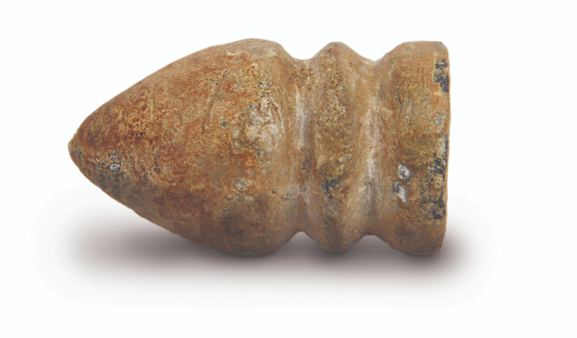

Leaving the Whitworth out of this question, it seems like a large number of bullets were manufactured (or imported ?) Why ? What advantage was there in the use of these bullets ? Thanks in advance for your replies.An example is attached. This one is a .54 used by the Army of Tennessee but there is a large varition and number of these bullets.

Most of the .54 weapons were rifles mainly US rifles or carbines and Austrian rifles. That one has not been fired. Does it have a base hollow or pug? The groove is not essential but ungrooved bullets were used in pistols and some carbines - this one looks too large for a pistol.

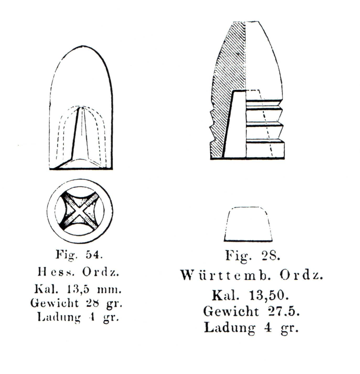

Lorenz bullet (Austrian) - solid base.
The only straight sided bullet I can find for the Lorenz is this one:
This was for the Deutscher Bund - a loose confederation of Hapsburg and South German states who decided on a common caliber (NATO Standard?), the Süddeutsche Conventions-Kaliber = 13.9mm
There were three versions - one for the Austro-Hungarian Army (standard Lorenz - ribbed, flat base), one for Hessen-Darmstadt (Hess. Ordz) with a plug and one for Württemberg (Württemb. Ordz) with an expanding base. Although they may have fitted the Lorenz, they were not necessarily used with it. Both these rounds were paper-patched, hence the slightly smaller caliber (13.5mm as opposed to 13.9mm)
The Pritchett bullet had a hollowed base.

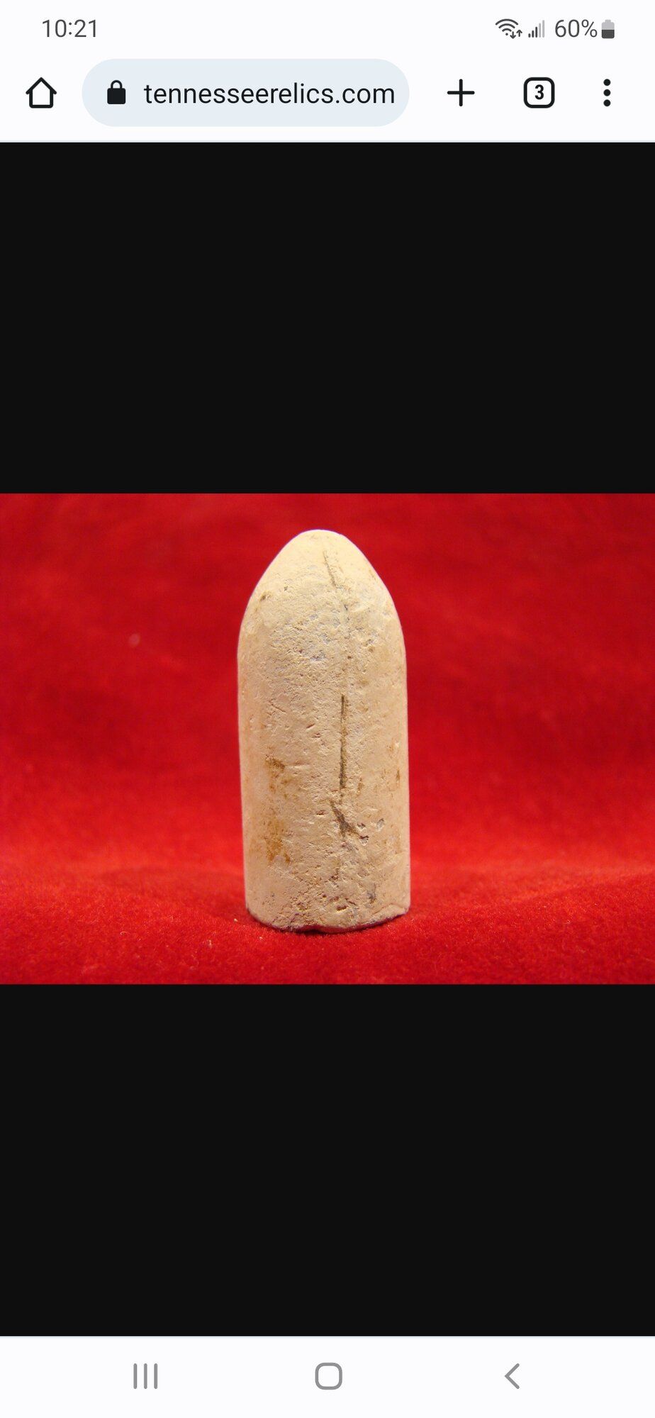

I added a picture of the cavity for the bullet. However examining this one bullet wasn't what I was asking about. It is just òne out of many. As we know many many bullets of different sizes and shapes were made with no grooves. My question is why were they used when numerous bullets had grooves. Was there a specific advantage to the no groove bullets ?
Bullets fired with black powder as the propellant require lubrication to function properly. If the lubrication is in the form of a greased paper patch, then one can use a bullet which has no grooves. If one loads the bullet "naked" - that is without a greased paper or cloth patch - the bullet needs grooves to hold the grease.
The Federal Army loaded its bullets naked and consequently used greased, grooved, Minnie bullets. Most European armies loaded their bullets in greased paper cartridges with the paper covered bullet inserted into the bore. Hence there was no need for grease grooves, like the British Pritchett bullet, although many European military bullets were grooved. They just weren't grease grooves.
Leaving off the grooves made the bullets simpler to swage and reduced the rejection rate.
