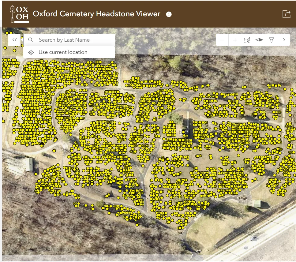

Attached is a fascinating article about using new technologies to map cemeteries. I think this is really neat!
Great use of technology. However, I can't see it completely replacing the old technology. GPS and/or Lidar is still going to be needed to detect and record unmarked graves.
That is interesting indeed. However, I do wonder how accurate the images are on which they placed said dots. GPS has limits and if the images are not spatially corrected they could just have equally limited spatial data. Now, a map could be made but it wouldn't necessarily be spatially accurate to the precision necessary to find a single stone out in the field. So, if someone wanted to use said map to locate a particular stone one might find one's self wandering about as the GPS coordinates might not be precise (they're generally only good to within 10 to 30 feet). Just sayin'
Archaeological mapping uses GPS software know as RTK/GNSS and is accurate to 1 - 3 centimeters.
Perhaps but would those using the described methodology have such equipment ? I don't think so. The article says they used a combination of cell phones and drones and notes. Coordinates from said sources (at least the drones civilians can buy) are often off, sometimes by quite a ways. As I said, one could make a map; just not a very precise map (i.e. not really to scale).
A map is better than no map for sure and might be accurate enough to get one to the vicinity of a given stone, just not to the stone precisely. If it were a large cemetery with a lot of stones in close rows you'd likely have to wander around a while to find what you are looking for.
You are suggesting that they're doing sloppy work and producing unusable results. The article linked above was written for the general public leaving out all of the boring technical details that only geospatial specialists, archaeologists and those in similar fields would be interested in. The map you are concerned about already exists and was created using high-resolution photography. In the mapping program, a dot is assigned to each headstone. The data the students record off the headstones is linked to the dot in the database. The result is a map that is available online and searchable in a variety of different ways and you don't need GPS coordinates to find a specific grave. The mapping they are doing is accurate to within about 3 cm but what do I know? I'm only an archaeologist.
I did not suggest that what was reported was sloppy our unusable; just likely not precise. I simply noted that if they used drones and cell phones (as reported in the article) then it would likely not produce a map to scale. Also, while the imagery might have been very clear it, too, could have spatial error. What you are reporting was not mentioned in the article (as you note). If, in fact, the students had access to better technology than just cell phones and civilian drones I'm happy to hear that.

I can agree that taking photos of gravestones rather than recording data by hand would save time, provided you are dealing with relatively new gravestones, in relatively good condition. I have tramped through many, many cemeteries, most of which were far off the beaten path and rarely in good condition. Yes, GPS coordinates would be helpful in locating the stones, more or less, but most stones required a lot more skill and finesse and time to capture the information inscribed.

Technology has improved considerably in the 30 years since my team was one of the first to use total stations for mapping sites in Sinai. At that time, GPS data was still restricted to the military. When it became available for public use, we had to buy a license for post-processing software so we had 50 cm accuracy. Since then, universities have developed entire programs to push the limits of this new technology. The Geospatial Center at Miami U is on the forefront of new applications and well respected in the geospatial community.

High resolution photographs are taken and, when possible, the photos are enhanced to try to "tease out" the inscriptions.

Those aren't ordinary cell phone apps they've been using. The technology is now beyond me. I kept up with it until I retired from a Geography and Anthropology Department, my part-time gig. Full time I ended my career as a compliance archaeologist assigned to the state department of transportation and reviewed FHWA projects. Several major highway improvement projects crossed my desk. Projects like that have lots of funding for the latest technology so not only did I see reports on cemetery location/mapping but GPR studies of suspected unmarked cemeteries that included the use of cadaver dogs. It was at that point that I realized I was an old archaeologist given that my first mapping projects were carried out using an alidade and plane table and I use MS Access for my Camp Lawton/Millen database.

If you want a low tech solution maybe you can get a good (meaning high resolution) aerial of the cemetery. Use it as your base map. Number the graves in a manner that makes sense to you (you can color code the numbers if necessary to designate specific time periods or families or . . . ). You could set up a spreadsheet that lists the graves by number, name on marker, findagrave designation, plus columns for other information you find important that cross-references your map.
@Josh The Lighthouse Guy , when you find the cemetery, try zooming in to see how high the resolution is. I'm assuming here that the cemetery is in Jupiter based on your location.
Are you close to any college/university that offers a GIS degree? The department chair might be interested in using your project as a research project for students. It couldn't hurt to ask.
